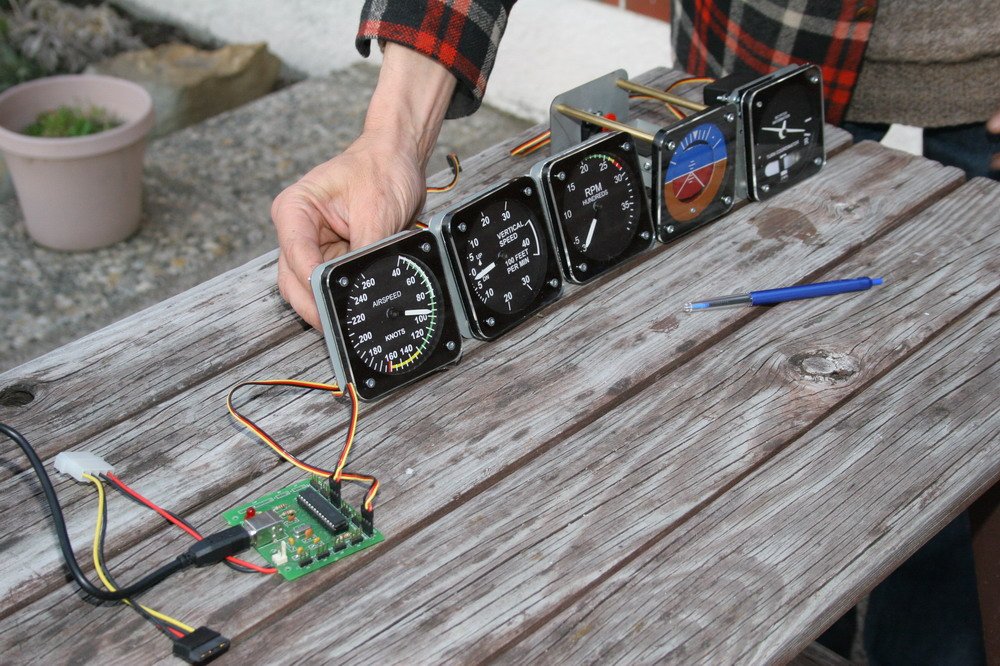

In my post on a new coil tester @jab35 enquired about an electronic speedometer and/or rev counter for the model T.
I was thinking about this overnight and have decided this would be a fairly simple thing to do, but I'm not sure if it's anything of significant interest to others or not?
FWIW, as I like things to be 'period', I'm not sure how keen I would be on a digital readout, although that would probably be the easiest. However some time ago I developed some instruments for a Flight Training Device (a.k.a. flight simulator) that were a reasonable facsimile of the actual instruments we use in a 'plane. I attach an image of some of these instruments here:
It occurred to me that it shouldn't be too hard to do something similar that looked like a 'period' instrument for a T. One could then write some code for an Arduino or similar that would sense/calculate road or engine speed and drive a suitable pointer in the instrument (via a stepper motor or servo).
What do you think?

Interesting, I hadn't thought about producing a drive to power a mechanical instrument - thanks for pointing this out!
Thinking about it I feel there's no reason why one couldn't do this with an inexpensive stepper motor for example. These are easily obtainable from old printers etc. I'll have to consider how best to go about that.
In terms of getting a signal to determine road speed and drive the instrument I agree that a GPS is very accurate, but it's also fairly trivial to use something like a hall-effect sensor and a magnet on a spoke, or even against the gear points of an old speedo drive wheel.
Either way that part's easy and reasonably inexpensive IMV. For me I guess it's more about how to display the speed in a form suitable to the vehicle that I was wondering about.
If you've already got a suitable instrument but just need to drive it, then you're most of the way there, however down here there's not too many of those around (that I'm aware of), hence contemplating how one might go about making something new, but period in look...
