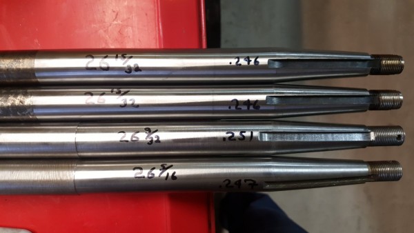

I have an axle that extends .016" outward of ideal position. Gap between the shafts inside this differential is perfect....just enough gap for the ear disc. This leaves an exposed gap between the brake drum and the backing plate. Has someone here shortened a repro axle shaft by turning back the tapered end? Calculations show I would need to remove .009" material on a side from this taper diameter in order to shift the brake drum where I want it. If this turning is practical, then this alteration would also either require the same .009" be removed from the height of the shaft key, or the key seat depth would need to be increased.
Would be great if I could purchase this prescribed shaft length from the shaft maker, but I'm guessing this could be complicated for multiple reasons, if doable at all. Thoughts/comments?

Say more about altering the gear side of the shaft. If the shaft gear is backed away from the c-rings (lets assume 5/32" (.16) for this example) now the c-ring thickness either needs to increase by 5/32", or some other spacer is required to occupy the now increased groove width.
Hello Andy:
Other side has a .13" gap. I did not compare lengths on the new shafts before assembly, but did confirm both wheel hubs produce an identical gap. Not that this is a mechanical issue, only aesthetic. Brake shoes are visible on the .16 gap....just looks sloppy.

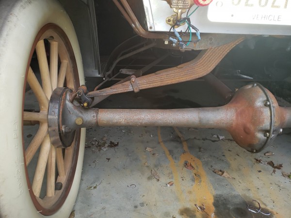

This shows the .16" gap. No it's not horrible, but no need to have these calipers showing if this can be addressed.
When shot in Brewster Green and pinstriped this would not be as conspicuous. However, got a ton of time in this rear end, and will have much more with the finishing work complete, so I'm wanting to work all of the cosmetics while the scrapes don't matter.

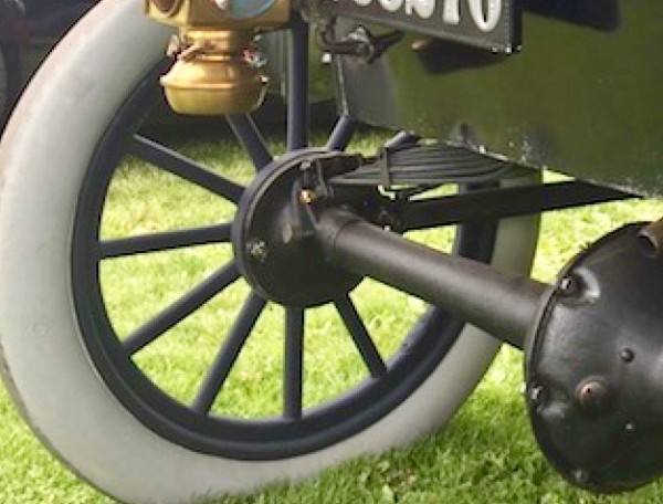

Your fixes may be best, Would first double check all the parts are fitting correctly. Sometimes the grease retainer cup on the axle housing isn't seated all the way, that could let the hub stand proud of the backing plate. Could check again and fit the rear wheel without the brake shoes on, to be sure the drum and hub are all the way on the axle, and fit as they should.
Early axle with normal like gap.
With your photo can see that gap is a bit more than earlier cars show at the backing plate / drum junction.

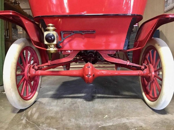

- Posts: 6558
Re: shorten real axle shaft
That '09 looks perfect to me

Hello Joe: Many thanks, but I believe I have arrived at the happy place. The axles are new, and they are the ones that are 1/16" over-length. At the time when I bought them, I was led to understand they were the best of the repos available, where I knew these parts had this specific potential, so it was me who created this challenge for me.
Hello John:
As per earlier in this post....looks like length is just one of multiple liberties that have been taken with these repro axles over the years. Some might call this a "fixing things that aren't broke" example.
Fun Projects parts are of unparalleled quality thanks to your commitment to accuracy....many thanks for these superb products.
