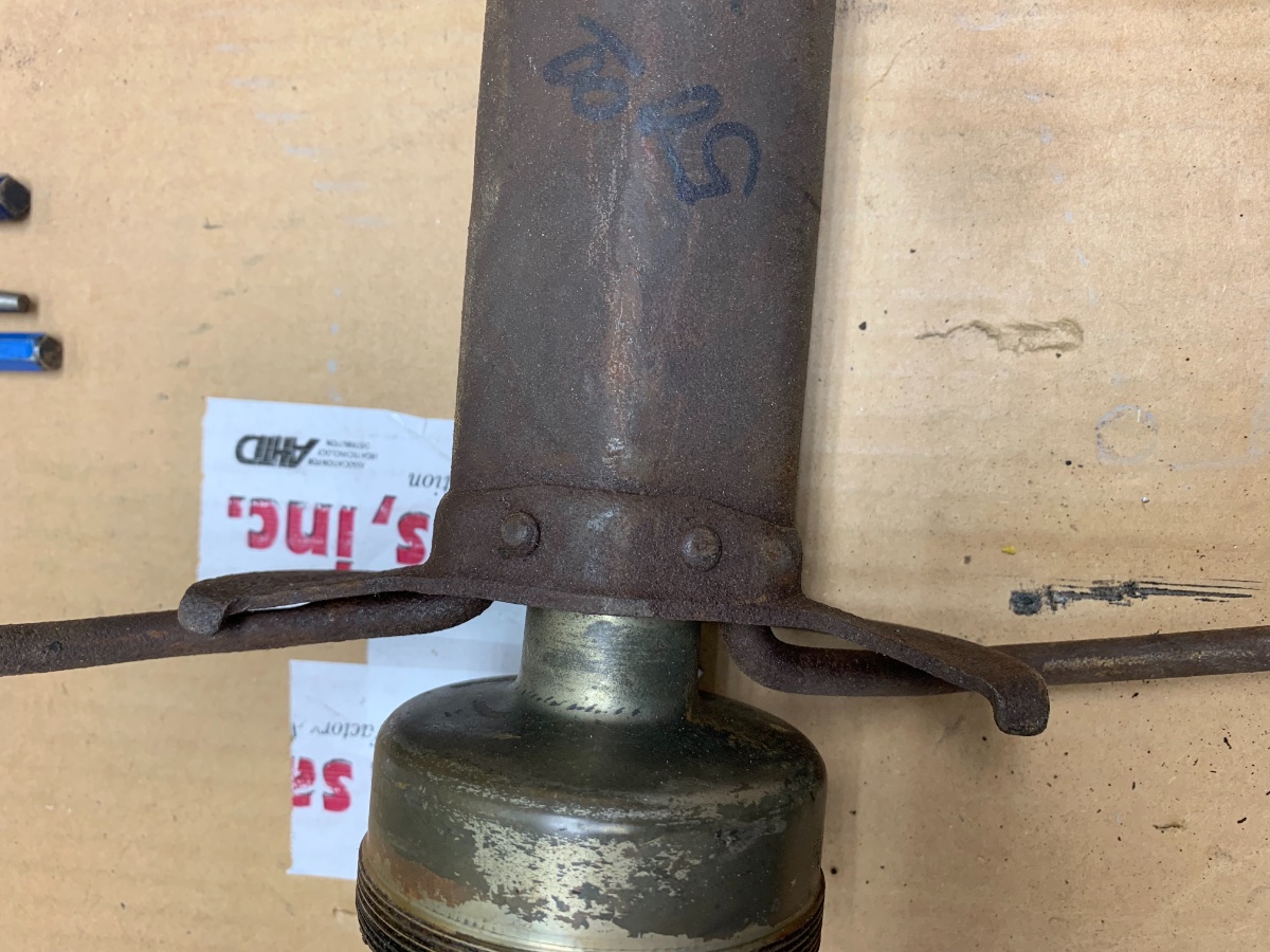

The brass case I have does not have the routed out overtravel groove. I have no clue what year it is. I will take some picks

Well, it looks like someone cut up a very early pre-'15 column
I can almost guarantee that someone would trade you a working, complete steering column for that quadrant and steering case.

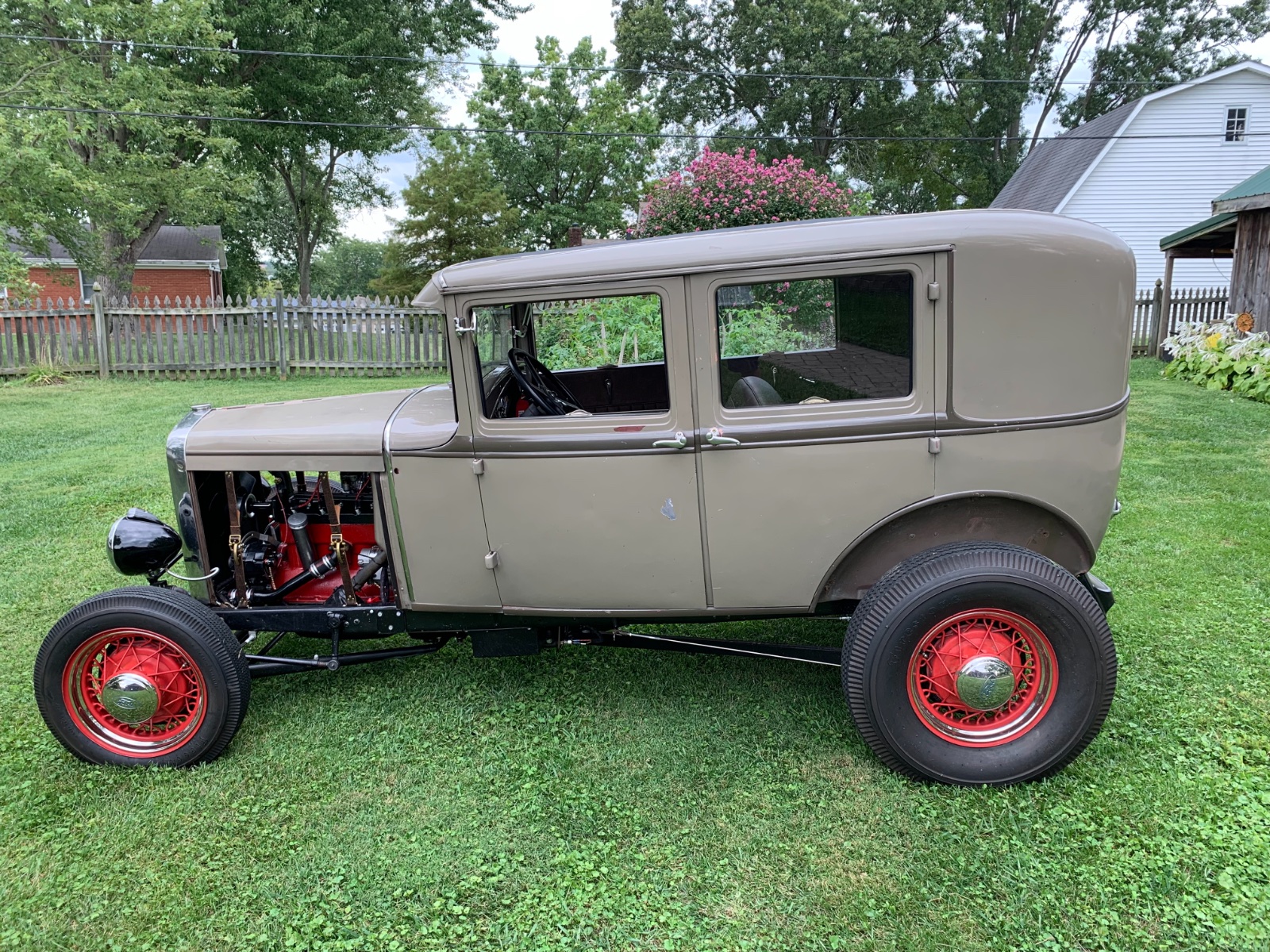

All the Very Best to All!
Hank in Tin-A-See

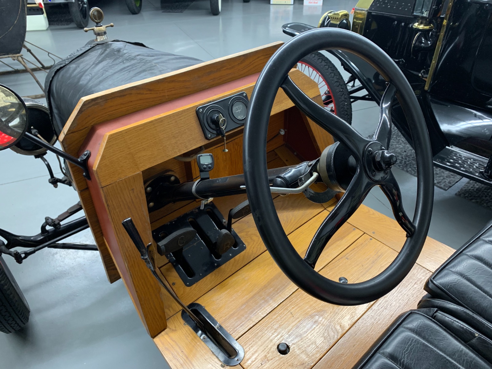

I have used later gear sets in earlier columns, to gain better steering, as I drive my cars. The earlier brass riveted gearboxes have deeper cut internal gears, and the later gears will not drop in. Get a later case that they will, measure the ID across opposing gear teeth, and turn out the few thousandths of the earlier gear case in a lathe to match, then do the fine valve lapping trick mentioned earlier in this post to finish up. It will make a much better & safer steering car, and no one will be any the wiser, being as none of it is externally visible.
Speaking of Franken-T's, I bought this little pickup inexpensively from the widow of an old friend, somewhat disassembled and missing a lot of stuff. It was overlooked at the estate sale, being up on blocks and missing its wheels, among a bunch of other stuff. It was originally a Fordor sedan that was very nicely made into a closed cab PU certainly sometime before I was born, probably because Ford never sold a closed cab PU in the model T era. It once belonged to Dennis Day of the Jack Benny show. Chassis is 1921, body 1926, that's the original Fawn Gray color matched from inside a door. I am working on a stock looking steel PU box for it now, which will further confuse the experts, but its the only PU I own, so it makes regular runs to the dump, among other errands. It has the later steering gears too. Good luck with your project, Danny. Jeff Beaumont, Gardnerville, NV

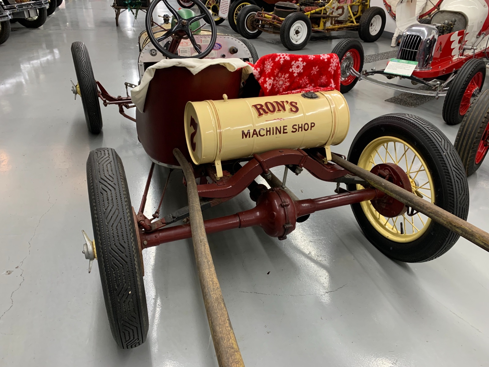

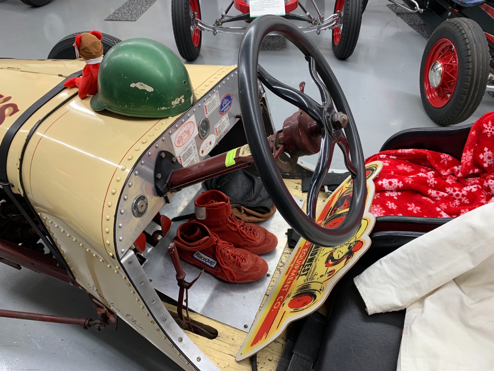

The cut column was just a purchase, I didn’t cut
Im just gathering parts and thinking out loud
Here are a couple I took pics of this morning.
