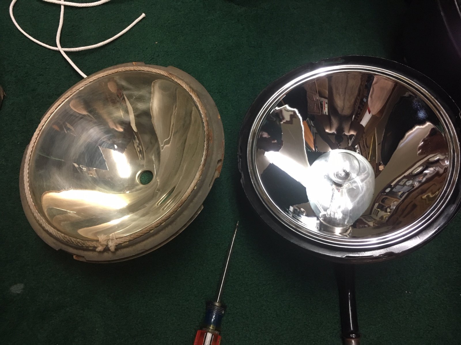

An object lesson. The left reflector is an original silvered one in tolerable shape. The right reflector is one of the aluminum coated ones from Lang's. It's a world of difference, and I'll know in a few days how much difference it'll make. And of course, check that you have good grounds.
