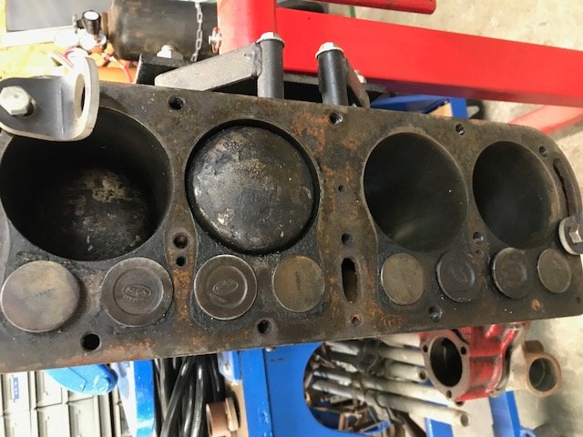

Now that it's much easier to post pictures (although the number posted could be increased) I thought I'd share my next project. It's a T engine with a B crank built by Orville Enyeart in the 70's for Andy Mounce (who I bought it from). From Andy's stories I believe this is the engine that made it up Pikes Pike and class winner at the Newport Hill Climb in his 26/27 Touring. Enjoy

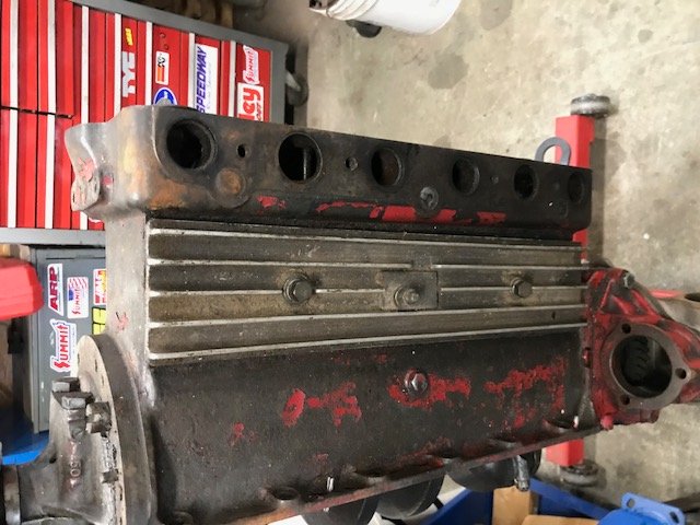

Was the block moved forward on the pan or the flywheel flange moved?

Thanks Les, some more pictures. The block is moved forward on the pan. The spacer on the end of the crankshaft I believe is when he ran this engine with the aluminum crankcase and C-4 transmission.

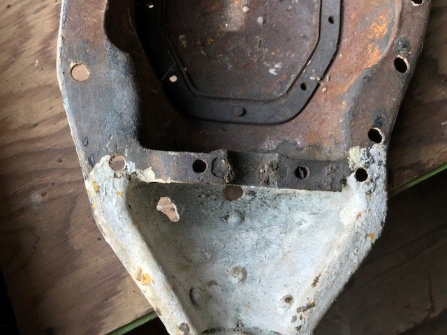

Re: Model T engine with Model B Crank
Posted: Sat Dec 28, 2019 7:34 pm
by henryford2

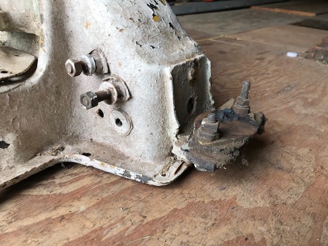

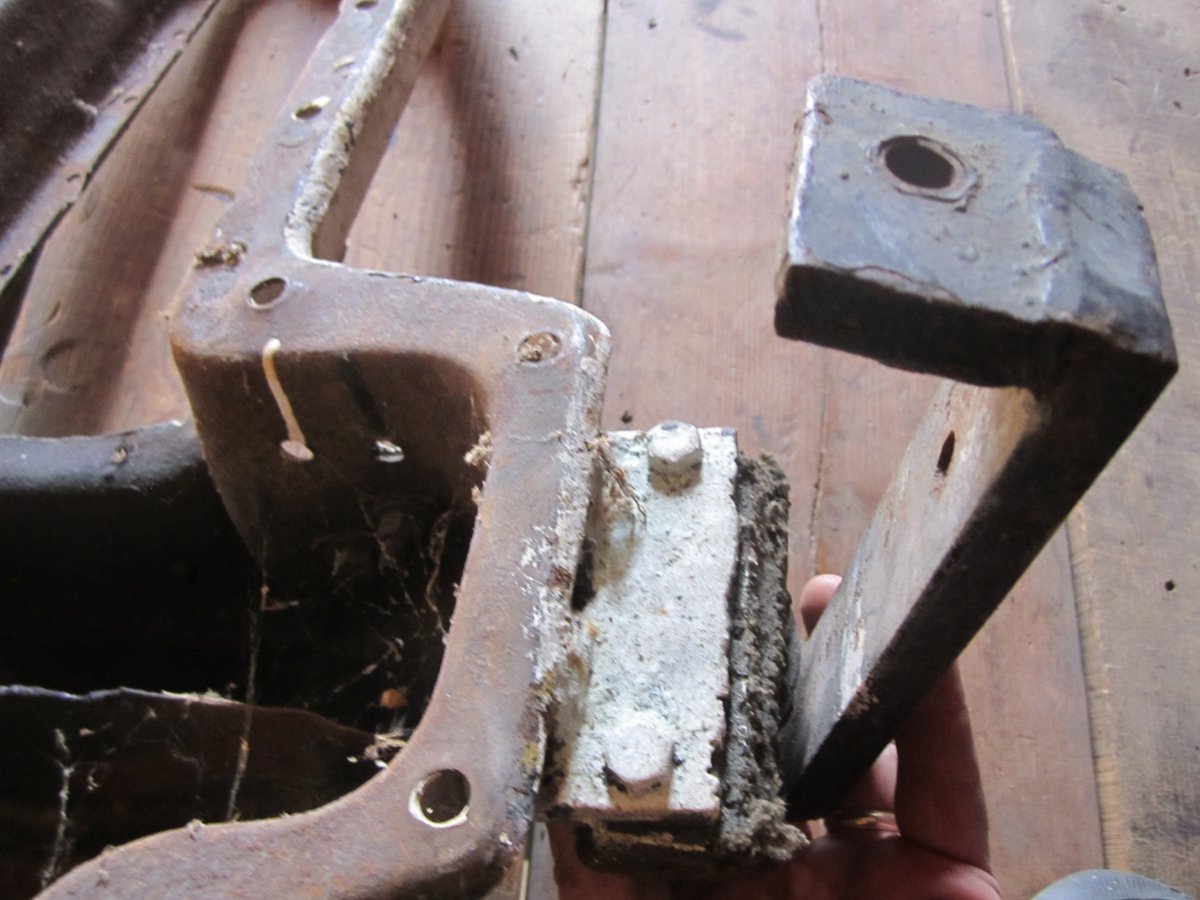

Here's some more pictures. This will get the "straight pan" fanatics squirming. Again the engine was mounted to an aluminum crankcase running an automatic transmission with a Model B crank shaft, so I'm guessing they weren't too concerned with pan misalignment. It appears that the arm may have been a single piece with the rubber bonded to the now two loose pieces of the bracket. Not sure where I'm going with this yet. Summer of 2020 project. Enjoy.

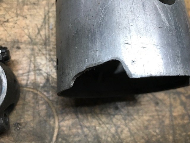

RE;"The last ones, it uses connecting rods from a air compressor "
What compressor? Do they shorten the length so stock T pistons can be used. Is that why the notch is in the skirt in the one photo?
Joe, I found and earlier post that you indicated not knowing what rods were used in this engine, hopefully someone out there knows.
http://www.mtfca.com/discus/messages/17 ... 1319706826
Posted: Tue Dec 31, 2019 12:56 pm
by henryford2
I haven't pulled the motor down, but from what I've seen, the compressor rod is the same length as the Model T with the exception that the big end is the same diameter as the Model A. This allows a "standard" Model T high compression piston to be used rather than the style where the wrist pin is moved up on the piston to accommodate the longer Model A rod . The notches in the pistons clear the counterweights on the crank. Hope this answerers your questions
