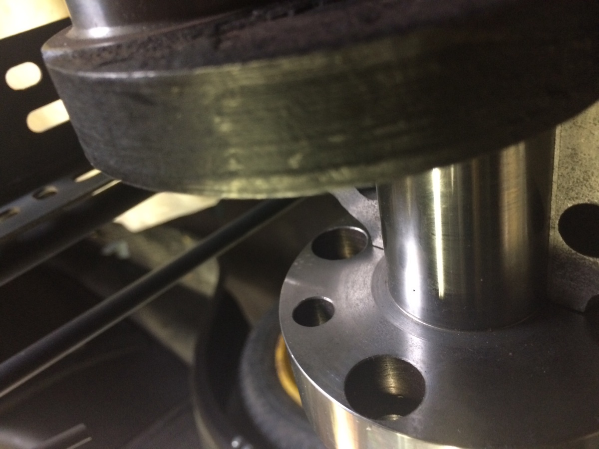

Hello, Steve here,
I'm not an engine builder but here is a picture of my 1926 Model T block with a Model A crank.
I'm having it build by a good friend. Hope this will help someone.
Re: Adding Model A crank to T engine early ideas
Posted: Fri Jan 10, 2020 12:19 pm
by Mark Gregush
Thank you Steve.
I got to thinking about the moving of the flange last night. What about threading it on, then using locktite and pins?
