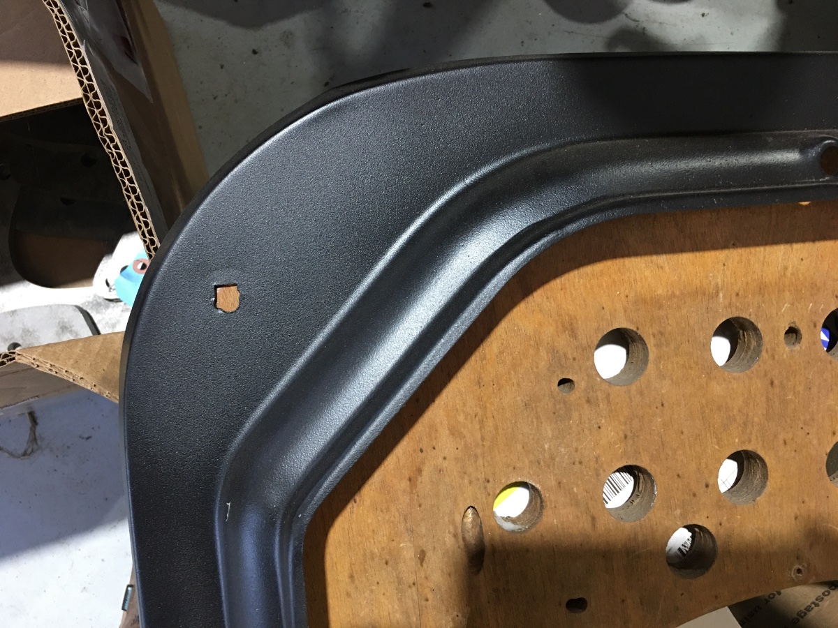

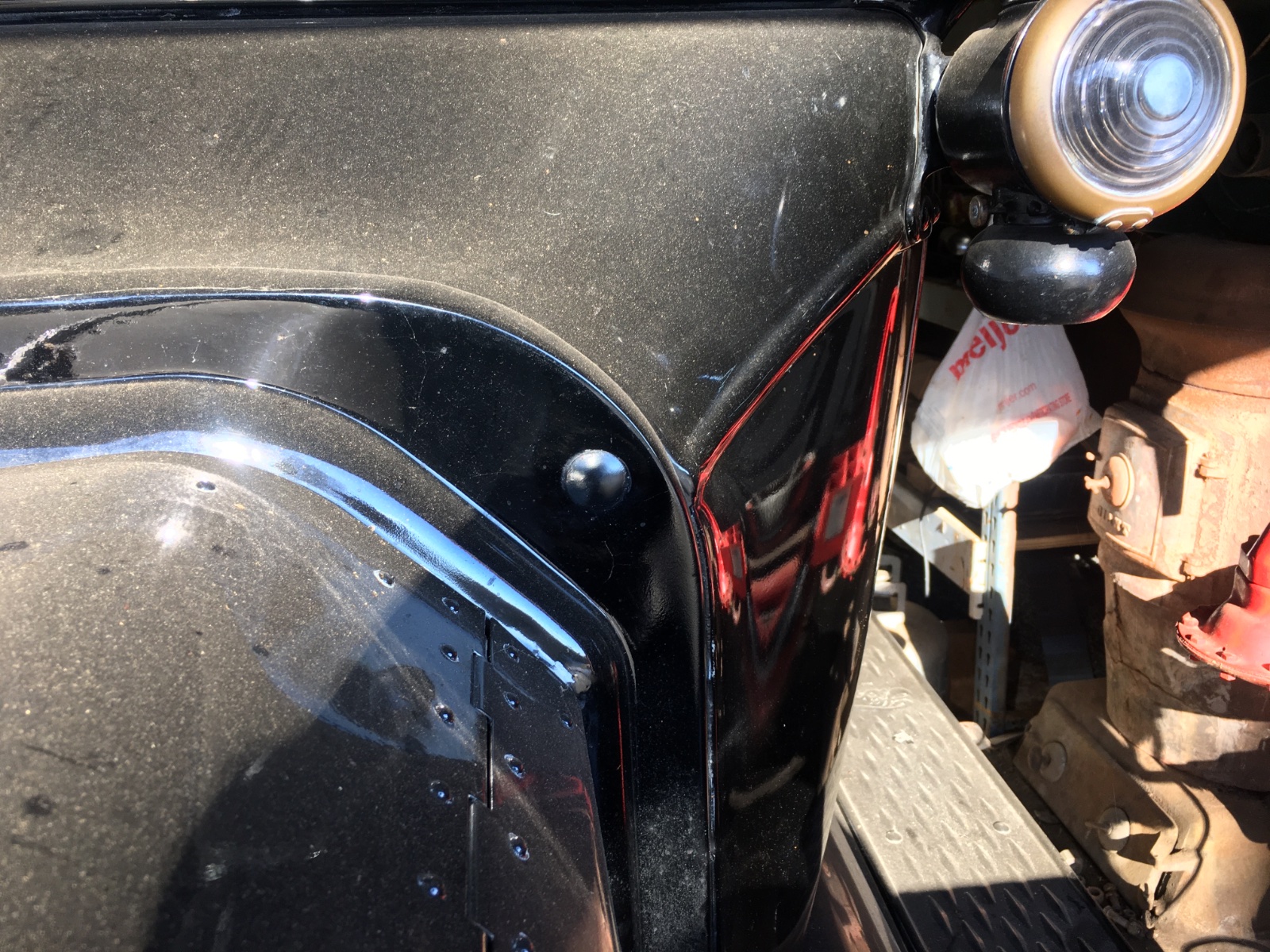

Needing the two large head bolts that hold hood former to to body. I looked in all the catalogs and can’t find

I believe those are regular carriage bolts, available at any hardware store. You will have to grind and buff the modern markings off the heads and strip off the cad plating before you paint them.

those are called step bolts . they are available, i have 100s.charley

Don't step bolts usually have a somewhat larger diameter, but shorter height head on them than the equivalent carriage bolt?

fastenal, has them $0.50 each.you can see the imprint on the hood former. charley
