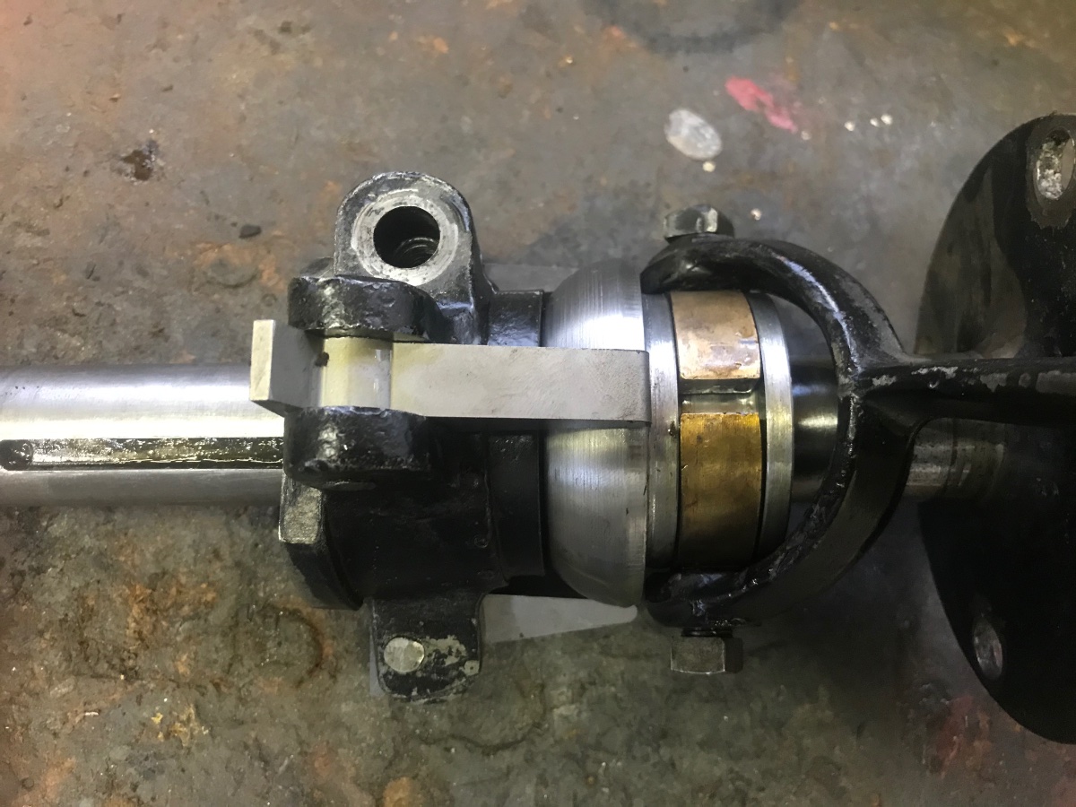

Kim has been plagued by transmission repairs.
Dean Yoder had transmission problems with the 1906 Model K.
Since no one living has had any practical experience with the Ford Model B other than
Wayland in Oregon - it has been a learning process for Kim.
The transmission linkage with recently made fingers and ball.
Images courtesy of Kim Dobbins.

by D.Yoder
That looks perfect !

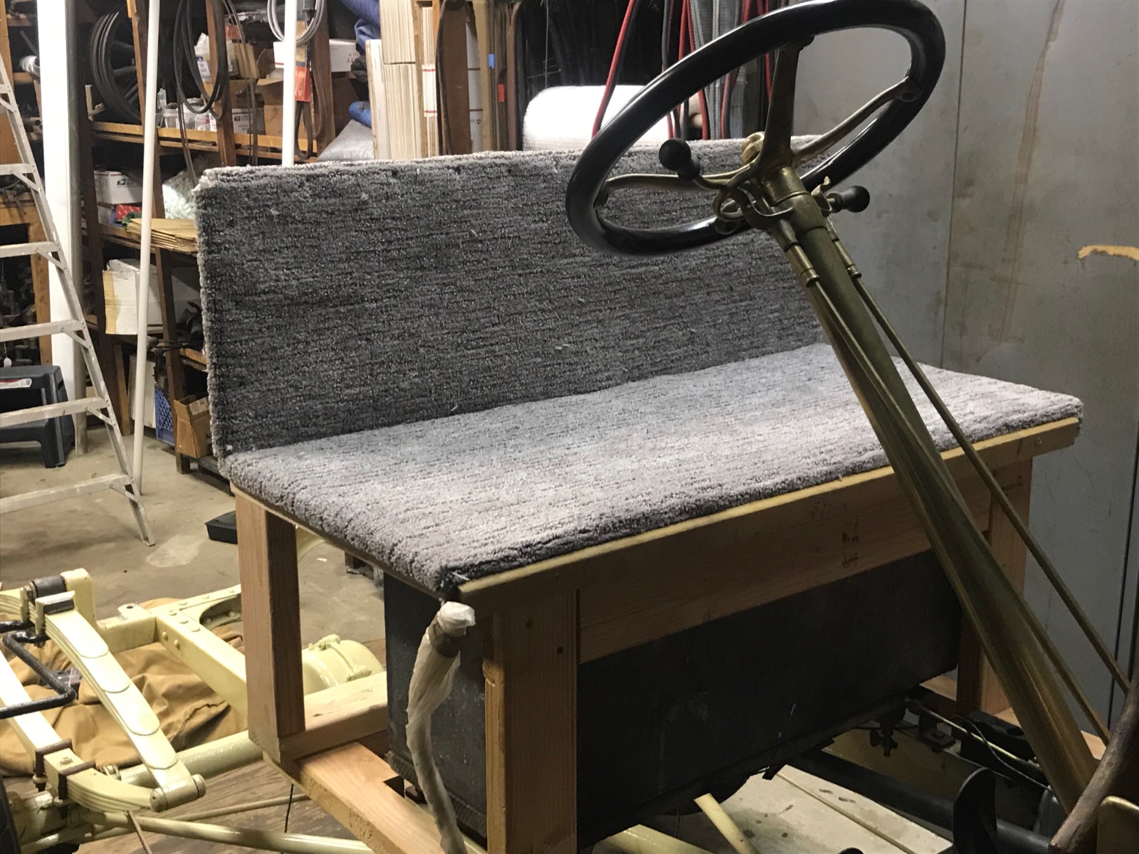

KD has installed the transmission back in the car.
He has to get the brakes & linkages hooked up.
He has fashioned a temporary seat for the maiden
voyage which I hopefully will get to video.

I don't want to put the body on the car until I'm sure it's road worthy, and didnt want sit on the gas tank so I made this temp seat. I probably won't have it on the road until after I get back from Chickasha. Work, family and customers cars seem to keep delaying the B. I'm really looking forward to driving it around for a bit.

Posted: Sun Mar 15, 2020 9:42 am
by Scott Rosenthal
Very nice upholstery. Is this some of Ernie Romero's work?
