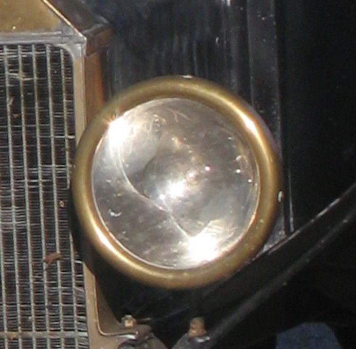

I have a brass (nickel plated) rim I would like to repair for my '15.
Why? 1915 rims are supposed to be brass, not nickel. You can buy brand new ones.

Too broke to buy new brass rims. Too many things I need that I can't afford to buy. The later nickel plated rims I bought years ago for cheap in a lot-purchase of headlamp parts, many of which I needed. I have repaired three of the rims, but would like to do the one more so I have a spare pair, not just the single spare. By the time I weld the cracks, about half the nickel is gone anyway. So cleaning off the rest is fairly easy. The little rivets that hold the lens clips in place also have a stepped pin in them to lock into the slots on the headlamp buckets, a true special purpose rivet. I would imagine whoever makes the new brass rims must have new rivets, maybe they would work on the old rims, maybe not.
