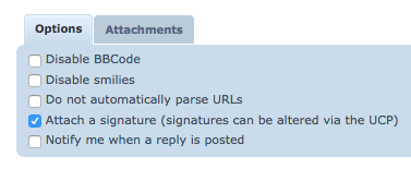

Screen Shot 2020-01-18 at 8.51.11 AM.png (10.87 KiB) Viewed 18024 times
Click Attachments.
Screen Shot 2020-01-18 at 8.51.35 AM.png (6.3 KiB) Viewed 18024 times
Click Add files.
Select the photo on your computer that you want to post and click Open.
When the button appears click Place inline.
The title of the image will appear in the composition box. You can type your message above it or below it.

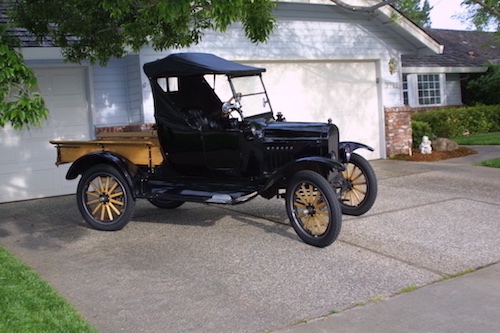

Carson, I got my Model T when I was 12 and I still have it. That was in 1945 and I lived in Wisconsin. I brought it to Sacramento and my boys (teenagers then) and I restored it. Have fun!!!!
IMG_6446 copy 2.JPG (81.76 KiB) Viewed 17287 times
