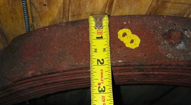

Both my T's with original front springs, the leafs are just over 1-1/2" wide. What you might have is a Model A front spring that had been used, which would be wider. This would not be the first case. I worked on a car that had that happen. The channel in the front cross member is spread out some and A spring installed. They both have approx the same unsprung length. I do not think that this would be a Canadian vs American thing.

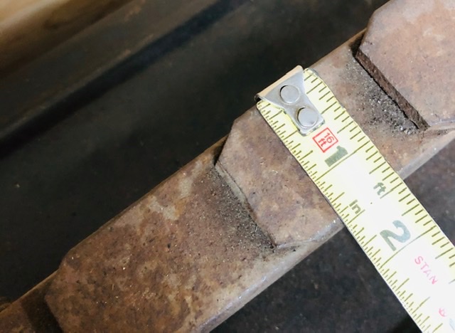

As far as I know, model T front springs are 1.5" wide, rears 2.0" If a 1.75" wide spring fits in your frame cross member, there has been some serious work done, and the spring will be wider than the perch.

You are correct, I missed the front spring width in first reply.
The front T spring is 1 1/2” and rear is 2”.

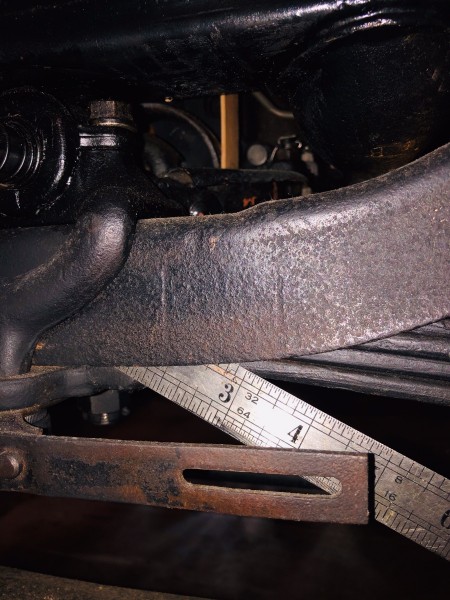

I now have a serious concern about what has been done to the frame to get this 1/4" wider spring in place. I recall that it was a bit of a battle to remove it so perhaps the backyard mechanic just jammed it into place and clamped it down.
I can't presently check the frame now as it's outdoors under a pile of snow, so I'll have to wait a bit to determine if there is a disaster or merely a bit of bad work that needs to be redone. Hopefully I can just replace the spring with the correct Model T assembly and move the rebuilt spring off to a needy Model A.

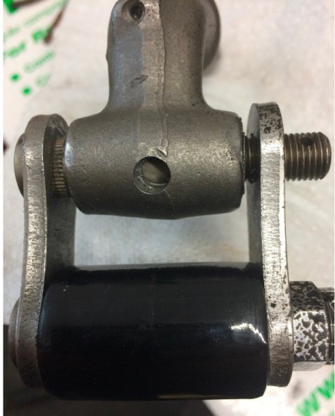

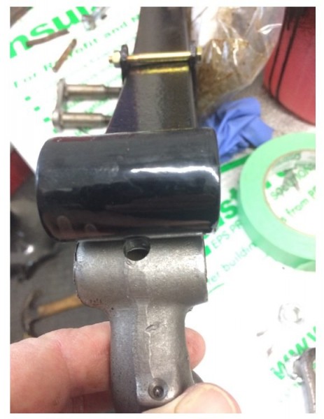

Re: Front Spring Width
Still trying to post pictures of the spring & perch differences
- Attachments
- A Spring & T Perch.pdf
- (878.12 KiB) Downloaded 153 times

I extracted the photo o make it easier for others to see.

I buy off-the-shelf bronze bushes rather than the rolled steel standard issue. They are all 2' long, OK for the rear, but I have to turn them down for the front. It would be easy just to turn a bronze bush down to 1.75 " to keep things in line.

Hi Allan FDU,
Aha, a 1 3/4" bushing would bring the shackle into alignment and eliminate spacers, wouldn't it? I would have to replace the bushing in the A spring as it's 1/4" too short as well and sunken into the eye. (that sounds painful).
I'm going to visit the frame and tunnel out in the snow to see if I can get some meaningful information on the front frame crossmember and hopefully figure out what sorcery took place to make the larger spring fit. Depending on that, it may be best to stay with the change they made so many years ago.
It does have me wondering what this 1927 went through in its early age. It's now 93 years old and I've owned it for 56 of those years so that meant that, before me, it had 37 years of dramatic life and boggled repairs. Must have been quite an experience.

Another picture showing the shackle space.
- Attachments
- Shackle Space.pdf
- (1.57 MiB) Downloaded 126 times

Can you have the spring eye machines to the right width? No spacers and unoticable if done right. Just thinking.

Now that you mention it, Dallas, Perhaps the spring eye could be machined down the required 1/4" so that the shackles will align properly. Would have to be done with 1/8" on each side to keep things centered but this could be a winner.
Still have to address the frame mounting issue and it will take a close examination to see what was done and if it's usable or recoverable.

Took the trip to visit the buried frame and check out the front crossmember condition. I think it turned out to be well worth the effort.
I was hoping against hope that the frame hadn't been beaten into submission to accept the wider Model A spring and it looks like it's still an original condition crossmember.
I did note that the top spring leaf (the smallest one) in the Model A assembly was 1 1/2" wide so they used one T leaf (thank goodness it wast a tea leaf) on top of the assembly perhaps to help fit the wide spring into the narrow space?
I took some measurements and see that the outside of the crossmember is 1 7/8" and the inside dimension is 1 3/4". If this is the original inside dimension it would indicate that there was a space allowed for the T spring to move as required by the different wheel heights and that makes sense to me. This dimension also matches the Model A spring width so there shouldn't have been any crossmember distortion occurring when the A spring was added. There would be limited space for the spring to swing but I didn't note any wear in the crossmember from this occurring.
All in all, I'm thinking this is good news and all that's needed to get things squared away is a new T spring.

That inside width of 1 3/4" is likely ok, for a used front crossmember, most times they are fairly narrow at the center, about 1 5/16" or bit more.
What counts is the spring should be snug in the crossmember when the motor mount / spring clamp is fastened up secure. You don't want the spring stack to wiggle/wobble, front and rear, at all, inside the crossmember there in the center.
And utmost important is the center bolt square head, it has to fit snug in the square hole in the upper center of the crossmember, otherwise the spring stack will shift laterally. Plus, don't forget to add the spring pad.
A check can be made after assembly to slip a gauge, like a steel rule on both front and rear near the center, and it should be just able to slide up. That's an OK fit of the spring stack, assures it is firmly captured in the crossmember.

I appreciate that insight, Dan and the photo of what things should be like.
As things stand, it appears that the top of the crossmember is 1 7/8". The frame thickness is about 1/8" (just by checking the photo showing a ruler so this may be off). Deducting the frame thickness from the outside width leaves 1 5/8" clearance inside. Inserting the 1 1/2" spring leaves 1/8" clearance at the top of the crossmember or 1/16" on each side of the spring.
If this is too much space, can the crossmember be squeezed down as TRDx82 asks?
