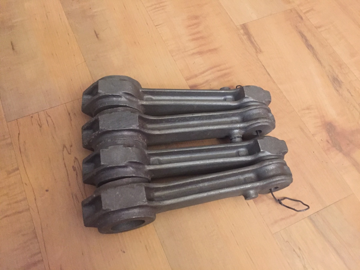

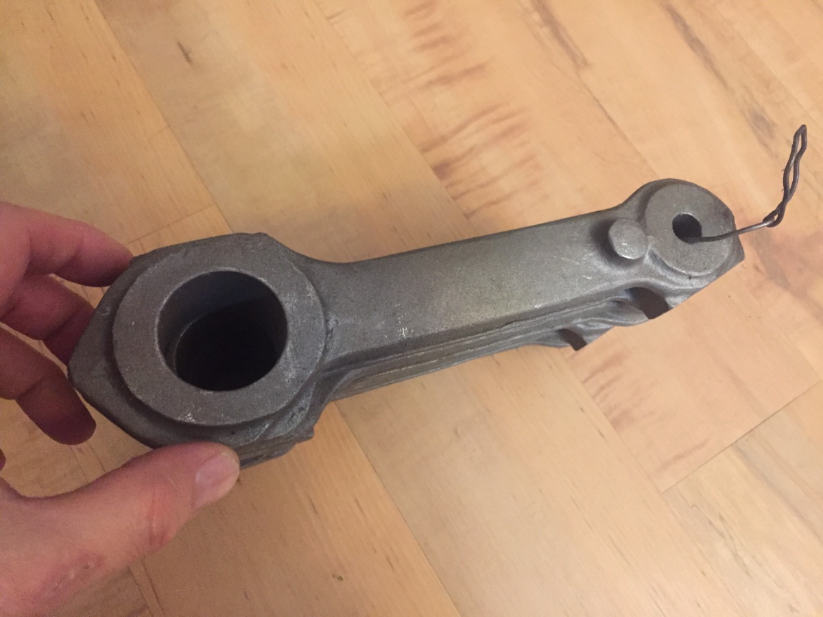

I came across these and would love any insight that you may have.
Matt

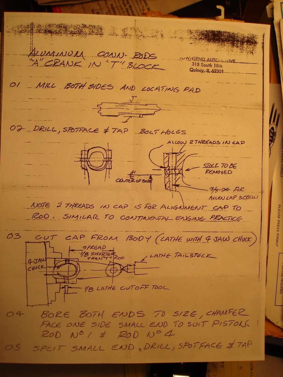

I had and sold some of the same rods years ago, they came from Townsend Automotive. I still have a photo of the paperwork Townsend sent with them.

I have a set as well. They are designed for using a A crank in a T block with T pistons.
I believe that pressure filtered oil is essential as babbitting aluminum is a bit of a challenge.
Not impossible, just a challenge

They're a great curiosity. I'd put them on the shelf. Those go back to a time before CNC machining. Machined rods from billet aluminum would be far better. And they're available.
There is a reason every critical casting in Aerospace gets X-Rayed and a test coupon comes with them. Those may be wonderful, but given all of the better choices today, I wouldn't trust them as far as I could throw them.

Aluminum rods;
I have a mid ‘20’s Scripps 330 cu in 6 cylinder 125 HP marine engine. They use cast aluminum rods and in conversations with others have never heard of a rod failure.
I guess it just depends how much HP you are going for perhaps. 60hp should probably be OK!!

A very well known and highly regarded T speedster builder once upon a time thought it would be an interesting experiment to put a set of Lynite rods in one of his speedsters. Another fell known fellow who is known to regularly drive a bright yellow racing machine, purchased said speedster with the Lynite rods. Needless to mention, as it should be no surprise that said speedster needed a new cylinder block fitted in short order.
