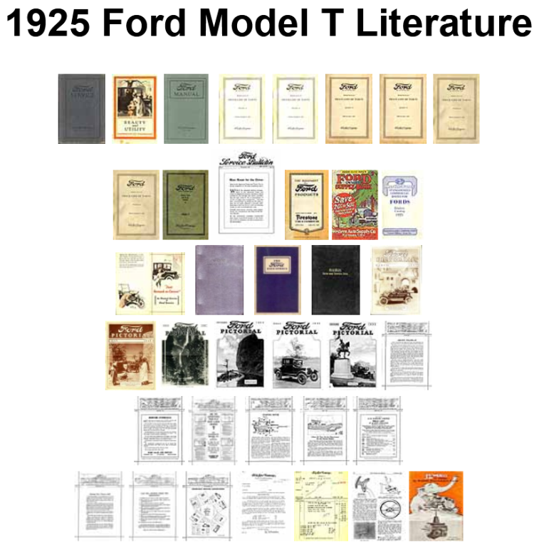

Just a sample of what is available in the link that Mark posted
In the left margin there is a list of links to numerous books. The listings of parts books by year goes on for two pages
