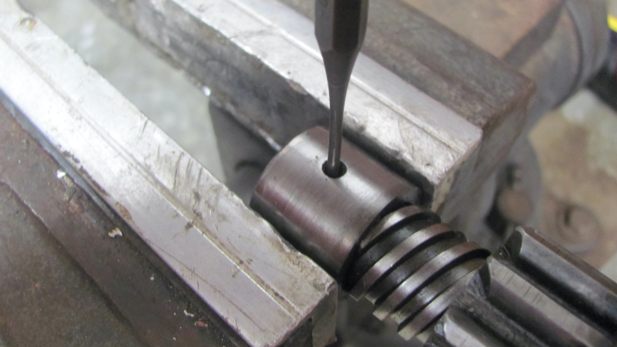

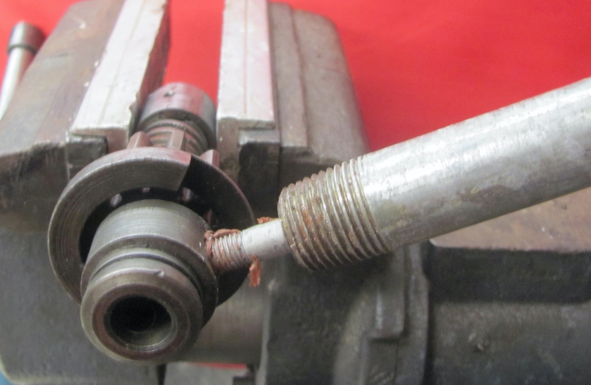

Another way that can work is soft aluminum jaws in the bench vise to hold the collar as you rotate the Bendix screw. Punch away the two divots that locks the collar.
Thread a bolt into the the Bendix to use as a lever, a length of pipe adds to the ease, to turn the screw out of the collar.
Don't forget to re-punch the threaded shaft against the collar , to keep the collar locked there after the gear has been changed. (First photo)
