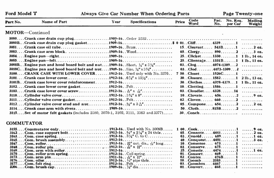

Here is from the 1916 catalog:
3088B 1/4" x 3-1/4" quantity: 2
3088C 1/4" x 3-5/8" quantity: 2
