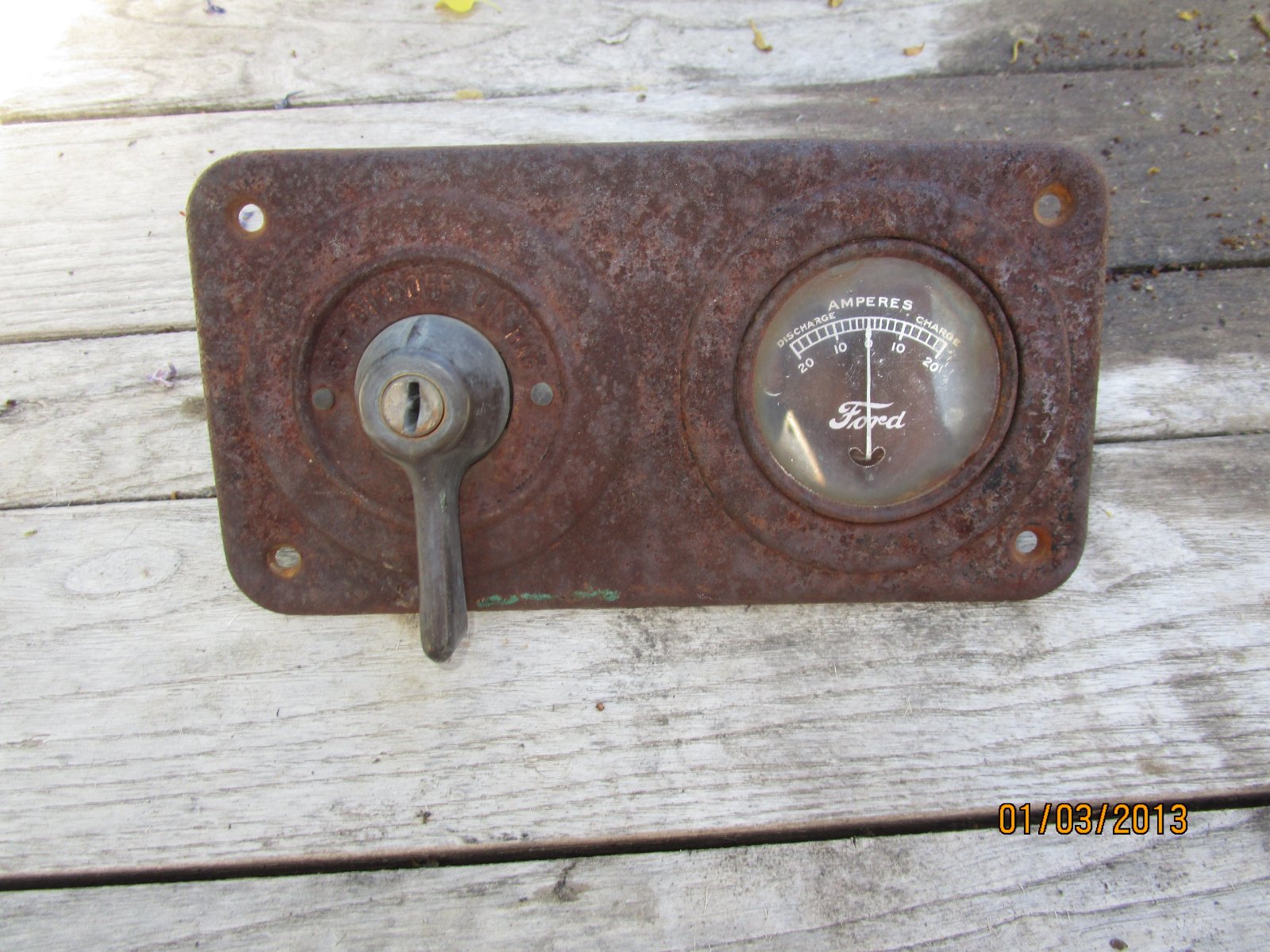

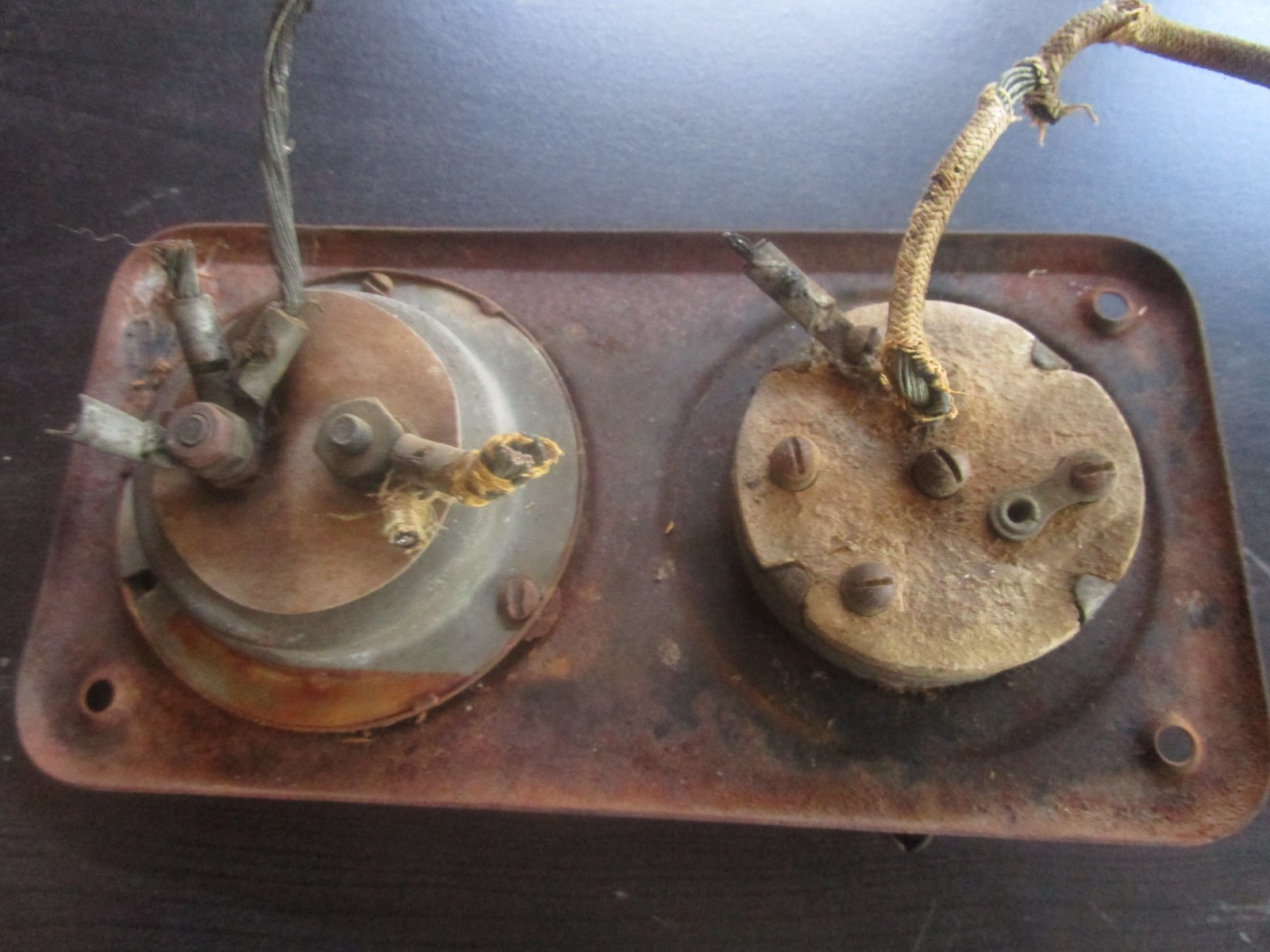

Here are a few pictures of my ignition switch with the # 42 next to the key slot. I wasn't able to take a closeup of the # but Looks closer to A Ford then any thing I have seen, Although the jury is still out with no know # 42 keyed ignition? I do have a set of T master keys and one did turn the lock to the right. Also wasn't to read anything on the back, but it does look like the first "Briggs & statton" photo from TDRxB2. This may never amount to anything but a Model T era mystery. Mike

The pictures generate more questions and a path to resolve them.
Looking at the pictures of the switch..
How long have you had his switch / where did you get it (may help understand if its been modified)
The switch plate has Ford script behind the lower part of the handle - likely an original
The handle condition doesn't match the rusty plate - (modified?)
The two rivets don't look original, but could be.
The backing plate is the final design used - the tabs don't look like they have been messed with, that would have caused markings in the backing plate so might not have been modified.
If you can rotate the cylinder without a key inserted in it (maybe one just in a bit to try) - then its split and no use getting a matching key.
When turning the handle you should feel it going over some indents that are in the underside of the backing plate. If not then it needs repair or replace (the fuzzy paper outer layer may not mean it needs replacement could be surface)
Given what I see I would remove the backing plate and see what the guts look like. Some designs do not require the rivets to be removed to get to the cylinder

First off,Your knowledge on these T parts is very impressive. and I have enjoyed seeing the pictures of your extensive collection of T and pre war parts.I am not new to pre war Fords, but my 27 Roadster pickup is my first Model T. I have had it for about three years. As for this switch; I have had it for only a week. I was doing some horse trading of old car parts with a friend, and he had this pile of T Parts in a chicken coop, "All four door stuff. I ended up with a pickup load UGG! The switch came out of the cowl. So if anyone is in need of 24-25 four door sheet metal I have most of a body. A soon to be posted. What I really need is an ignition dash switch for my 27 pickup. I will try your suggestions and fiddle with it some more. Thanks...Mike

So for you '27 pickup wouldn't you want a switch for that year. Oval shape. Note the repro switches (chrome handle) do not have a good record.
The ammeter you have has value if it works.
