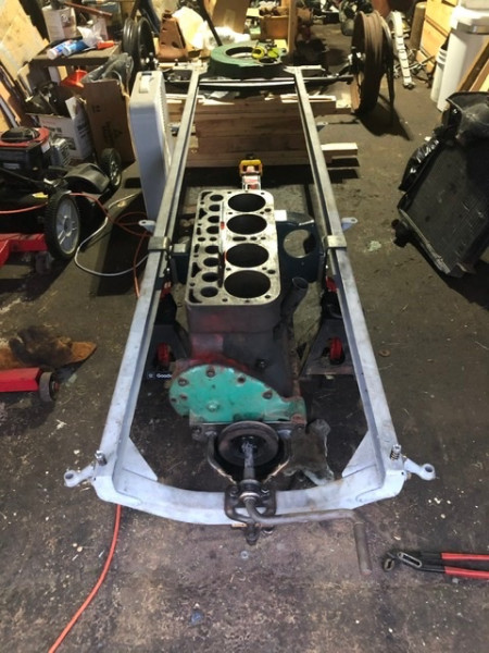

I’m doing it now. I love both the t and the a, so I’m going for it. I’m using the a trans as well. Custom motor mounts will need to be made. An aluminum spacer on either side of the a flywheel housing 5/8 will space the new motor mounts and allow the engine to be mounted like the t. I haven’t gotten to the front motor mount design yet. Another thing is that the a engine is longer and also taller. The hand brake cross shaft will need to be moved rearward and down lower. 5 inches back one inch down to clear the model a trans. The driveshaft and torque tube will need to be cut and adapted depending what you will do for the rear axle. I’m using a large drum t axle with Rockies, you will loose the t trans brake so good brakes are imperative! I will cut the t tube and use the front section on a model a tube welded to it and do the same for the driveshaft. Obviously the entire car is being built around all these changes, not simple, not easy, completely custom. But the end result will be a fun and interesting car. If you like early style hotrods( gow job) then this is a good project for you and may open your mind to a whole new, yet ancient forgotten segment of old fords.

Also I will use a model t water pump mounted to the side of the a engine and block off the water outlet on the top of the head. I will make a 1/2 plate to adapt the 26/27 t water outlet to that. Just lots of stuff to engineer as you go.

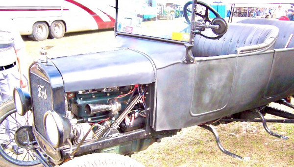

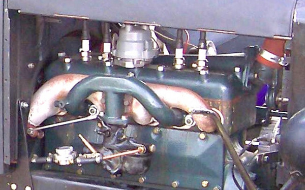

Someone on here did it long ago, wish I knew more about this one! They used a model b exhaust manifold

Yes and no,That"s a model B engine! Bud. :D

Your right. No outside oil pipe!

It looks nice, except there's this strange protrusion between the 2 and 3 spark plug... :lol:
Something else to remember - the front wishbone (which anchors on the T pan) determines your caster... you don't get that right, you're in a world of squirrley hurt. As you're building motor mounts et al, don't forget this... otherwise your first ride may be your last...

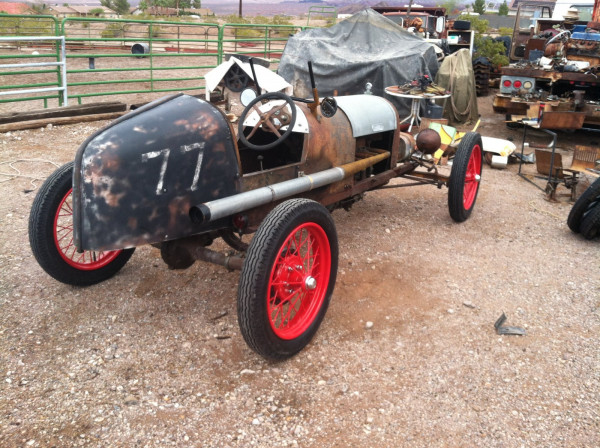

Post by John Warren » Fri Jul 10, 2020 9:15 pm

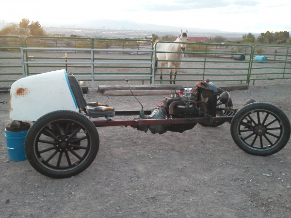

My race car is a hybred, I call it a TA race car

John, seeing your car burning the tires launching at the speedster reunion is what gave me the confidence that the model t rear axle is strong enough! My driving style is definitely more relaxed so I will be fine.

Dave, you do remember that I broke down. I twisted off an axle. It was mostly because it was a bad axle. Please take lots of photos of your build and share. The big drum brakes work well, adding rocky mountains is a great move.

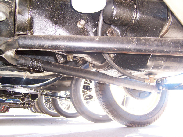

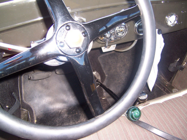

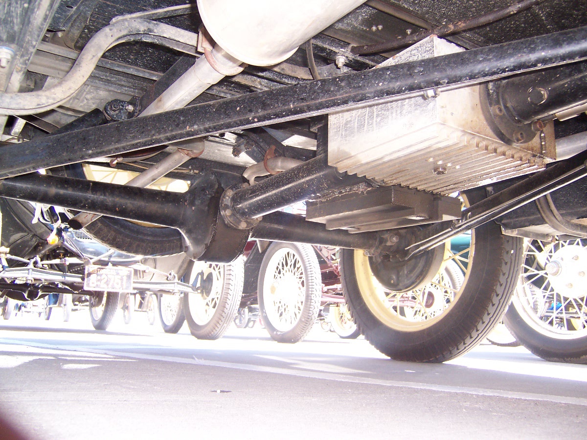

Saw this '27 sedan on tour years ago.
Asked the owner how it ran and he said good, but lots of work to many details, like A water pump hits the T radiator, so side pump added. Model A engine, and of course all Model A running gear. Model A front end with juice brakes, Model A rear with added Mitchell Overdrive, other wise pretty much T frame and stuff.
Model A clutch and brake, 3 speed shift, and overdrive lever too.
Model A front axle
Wishbone stock Model A to axle
Model A rear with overdrive unit

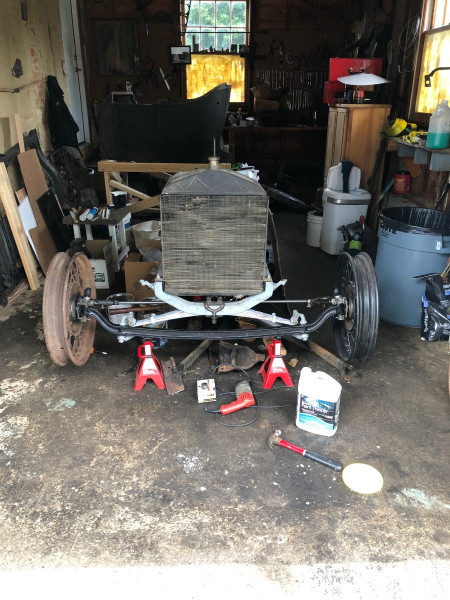

Here’s a little more of how I’ve begun putting a model a engine in a t. Yes I know it’s ridiculous, but it has been a fun project.

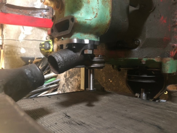

Post by David Mazza » Thu Sep 17, 2020 4:37 pm
More things to do to put a model a in a t chassis. This time the water neck needed to be adapted. A side mount model t water pump will be used with this set up. A v belt pulley will be used on the model t fan shaft and the pump will also have v belt.
