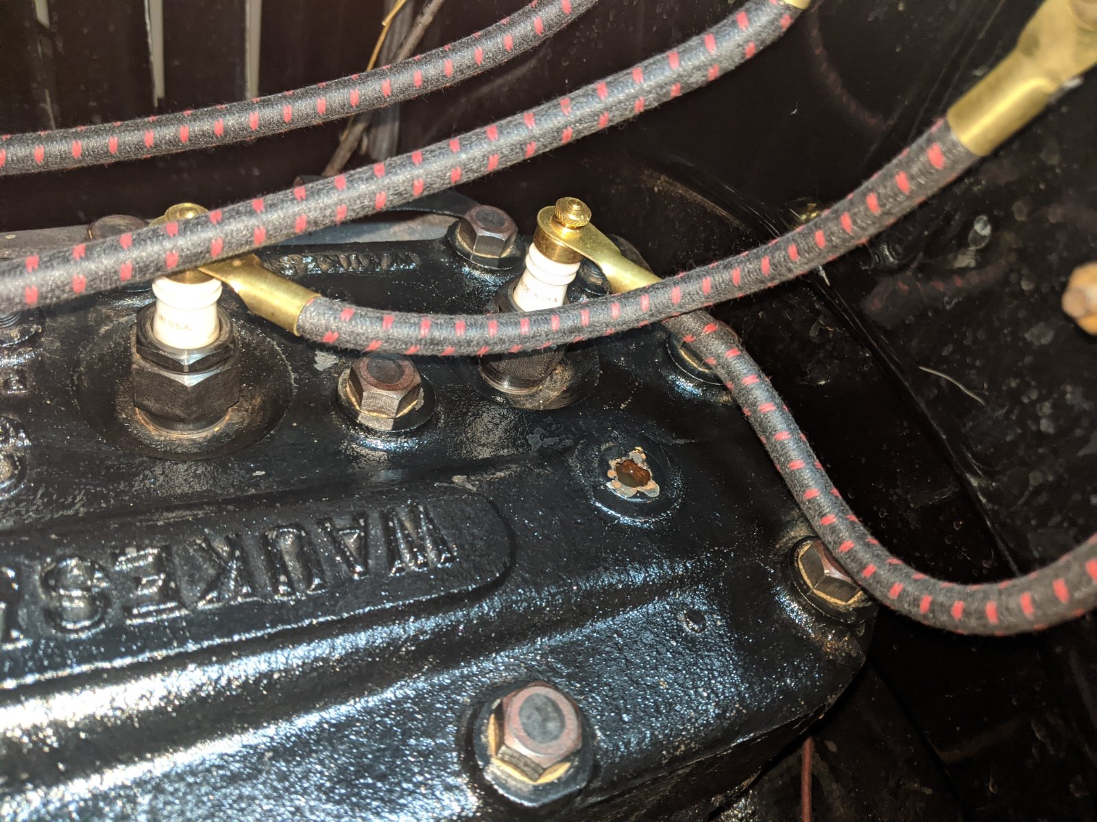

Went out for a ride tonight and started smelling antifreeze.
Got home and have a leak in head between plug#4 and back of head in round embossed area.
Water spraying out of round embossed area.
Is this a freeze plug area?
Any help appreciated.
Rick S.

Pictures would help Rick.

Pictures of area of concern.
Posts: 3962
Re: Leak in Waukesha Head by #4 Spark plug.
Post by DanTreace » Tue Sep 22, 2020 9:22 pm
That’s one of 4 pipe thread holes, used for priming cups if needed. Typical to just plug with pipe plug. Yours may need drilling out an old rusted plug or bolt that may have been used.
Posts: 3962
Post by DanTreace » Tue Sep 22, 2020 9:26 pm
Sorry, :?
Just saw that your boss with pipe thread is in the water jacket, odd place. But still seems the fix is to remove what was used for a plug and install a new one. Should be 1/8" pipe thread hole.
Post by Mighty1924 » Tue Sep 22, 2020 9:39 pm
Thanks Dan
Will check it out in morning and see if a pipe plug will do the fix.
I don't remember a pipe plug in this area
But the memory is not as good as it was once was.
Post by Kevin Pharis » Tue Sep 22, 2020 9:51 pm
Looks like a typical freeze plug to me. Probably will find that the center is rusted thru. Might get lucky and have a nickel fit in there😉
Post by Henry K. Lee » Tue Sep 22, 2020 10:06 pm
Either as Kevin states or a standing boss during the internal core support at casting time. These were a steel type pin which in the long term corrode away. If it is, simple fix by drilling out a small hole using a brass 10/32 brass screw with red Loc-Tite. Sand head off and touch up with paint.
Post by DanTreace » Tue Sep 22, 2020 10:09 pm
Kevin
Tend to agree on that, a freeze plug there. Interesting place, my W-R head could have used a freeze plug in that spot. If you look close on mine, a long run of braze is covering a long freeze crack aside the nameplate boss!
Post by Mighty1924 » Wed Sep 23, 2020 9:13 am
Thanks guys for all the info.
Picked up a 1/8" pipe plug and it screws in easily. A little loose until no threads showing.
Any recommendations for sealing plug into head?
Rick
Adam
Posts: 1592
First Name: Adam
Last Name: Doleshal
Location: Wisconsin
Post by Adam » Wed Sep 23, 2020 10:02 am
What’s showing in the picture IS a “freeze plug”. There are multiple DIFFERENT Waukesha heads. The one pictured uses a freeze plug there.
Post by Mighty1924 » Wed Sep 23, 2020 10:38 am
After further investigation Adam is right a freeze plug it is.
Previous owner of head must have put a pipe plug in or filled center of freeze plug due to previous leak.
Now what is my best option and how to do proper repair.
And where to get correct freeze plug
Posts: 5443
Last Name: Gregush
Location: Portland Or
Post by Mark Gregush » Wed Sep 23, 2020 12:00 pm
Some auto parts stores may still have them. What size is it? You could for now, clean it and seal with something like JB weld. Might want to put something like a screw in the hole to bridge the gap for now if you want to do a temp repair. It might be the same size as the T welch or freeze plug.
Posts: 5360
Post by RajoRacer » Wed Sep 23, 2020 1:43 pm
Drill it out & tap to the appropriate sized pipe plug, apply sealer - done.

Post by Mighty1924 » Wed Sep 23, 2020 5:04 pm
Old freeze plug out and area cleaned up ready for the new one.

Post by RajoRacer » Wed Sep 23, 2020 6:39 pm
Is that what the core hole looks like without the plug ?????

Steve
Yes that is what the core hole looks like without the plug.
