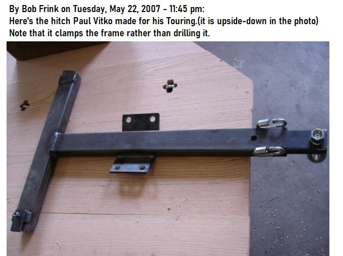

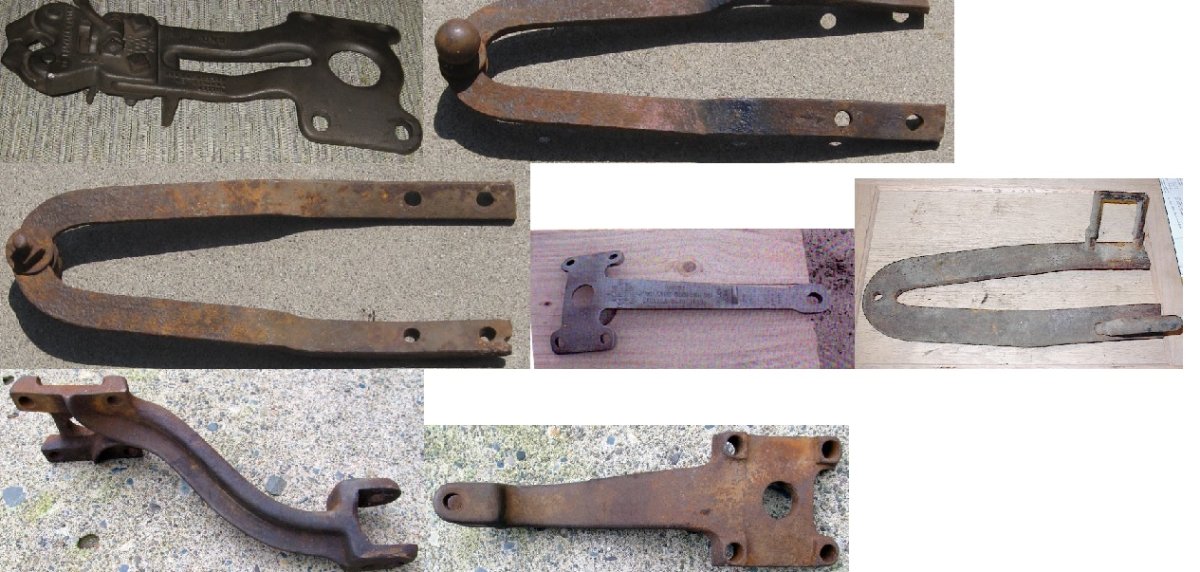

Re: Model T hitch question
Here is one that reflects part of your thought I thinkSusanne wrote: ↑Sat Mar 20, 2021 12:40 pmMy thoughts on this is fab up a multi-point hitch, 2 coming from bolted collars around each axke hald at the pumpkin, 2 bolted to the frame, almost like a 3 point (or in this case, 4 point) hitch geometry... I would NOT trust either the spare tire carrier (as it wasn't designed for those kinds of dynamic loads) or the rim lugs... you'd bend stuff up and break parts - even with a light trailer, that's a few hundred pounds of push/pull jerkiness in directions none of it was made to do.
Actually, you look at most of the hitches in the above example that go from the upper spring perch etc., most have a second point of attachment to the body / frame / etc... That poor spare carrier will become a pretzel.
http://www.mtfca.com/discus/messages/17 ... 1322924618 photo below More links to pictures and ideas. Some show the same hitches hitches from different angles
http://www.mtfca.com/discus/messages/50 ... 1226098461
This may be the ticket click here to see the install http://www.mtfca.com/discus/messages/29 ... 1182381023
