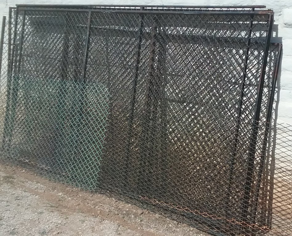

I obtained two incomplete sets of screen sides a number of years ago, the only part missing was the handle for the doors and the rest of the wood.My intention was to restore a set, until....
I came across a storage bin in a warehouse that was being demolished and had the same screen. As rare as these are, I decided to reproduce a couple sets.
I started buy reproducing the hardware including the top corner braces.
I laid out the screen on a table and secured it in place with wooden blocks to hold it in place on the correct bias.
The screen wires must cross each other as they pass thru the holes in the frame. The clips also keep the frame from warping when the wires are crimped.

Dodge Brothers made a boatload of screenside delivery trucks. You may try and contact someone in the DB Club.
I Googled "Heavy duty screen tool crib enclosures" and found several sources of screen panels much like the ones you show in your photo at the top.
I know that many community college police departments have holding cells constructed of the same material. I know, I've seen them (from the outside, not the inside, honest).
They're not as hard to find as you think. The cost, on the other hand, is a very different story.
Good luck.
Good luck.

It's really interesting to hear of the other uses of this screen as others have commented on. What is still puzzling to me is that big hole in one of the side panels,.....who or what, why and that was not easy to do.
