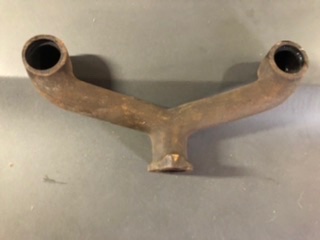

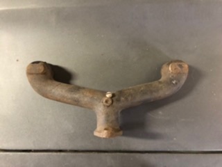

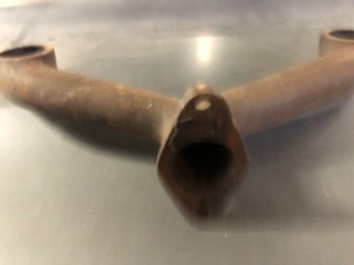

Found these today during an outing on an old farm , hoping to get some information on them , intake manifolds , same spacing as the T , but like a lot of things , I’ve never seen them before , aftermarket ? Not ford ? Ideas ??
Thanks in advance .

Aftermarket...used for any number of updraft carbs where interference with a generator is not an issue. The bottom one is commonly found with Meyer updraft carbs.
If you ever sell them, I'd be interested.
