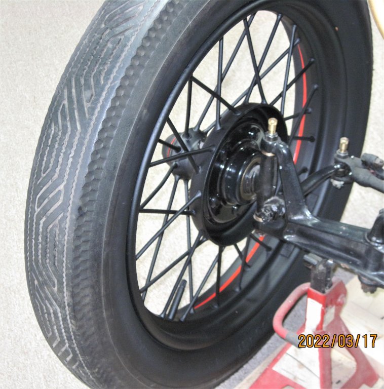

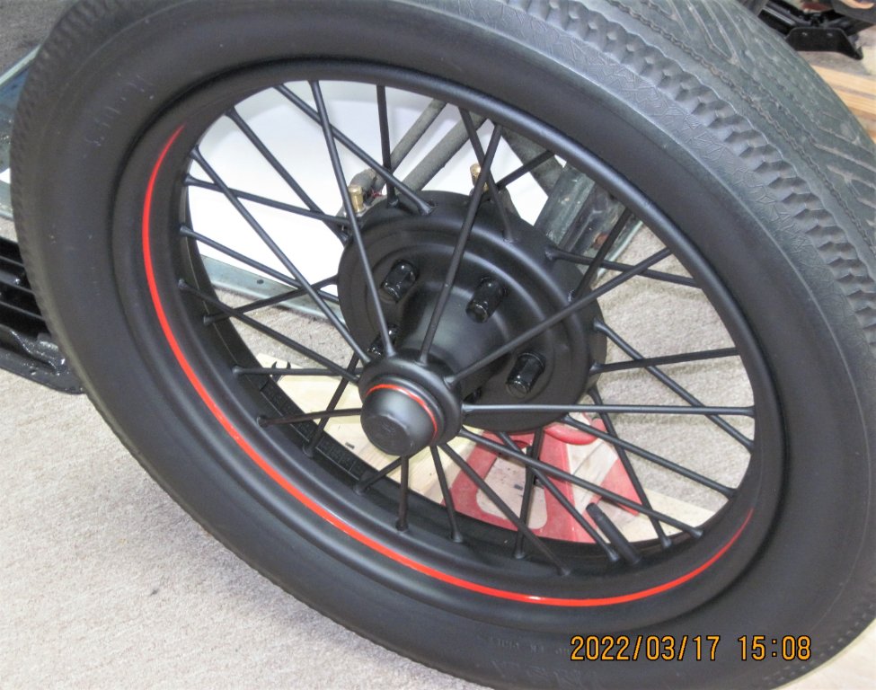

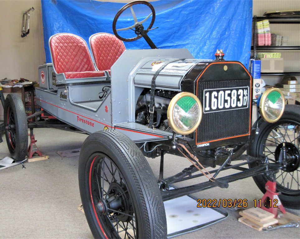

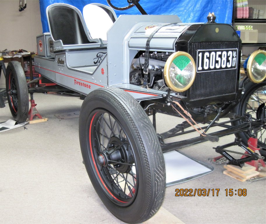

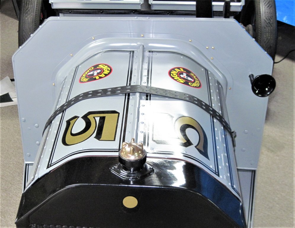

Did some more to the car, last decal set (gas), red line down the side and painted wheels, finished wiring and hood strap, refinished steering wheel.
Pictures are in no particular order, still have to make a step and do the upholstery when the leather shows up.

Thanks again for positive comments Dallas, I figured if it was going to look new (ish) that sponsor decals would not look out of place, all are period correct with Indian and Oilzum being from the same State, Firestone appropriate for Ford/race car.Dallas Landers wrote: ↑Fri Mar 18, 2022 6:50 amNice job Dean. She is a real looker. I like all the decals.
I'm reasonably happy with the way it's turning out, more so as I did everything myself, fabricating the body and painting it, reuse/refurb of good condition original Ford hood, original Ford hood former, Ford coil box, Ford headlights, original accessory radiator, steering wheel and NOS taillight and the list goes on, seat cushions and backs next along with a step.

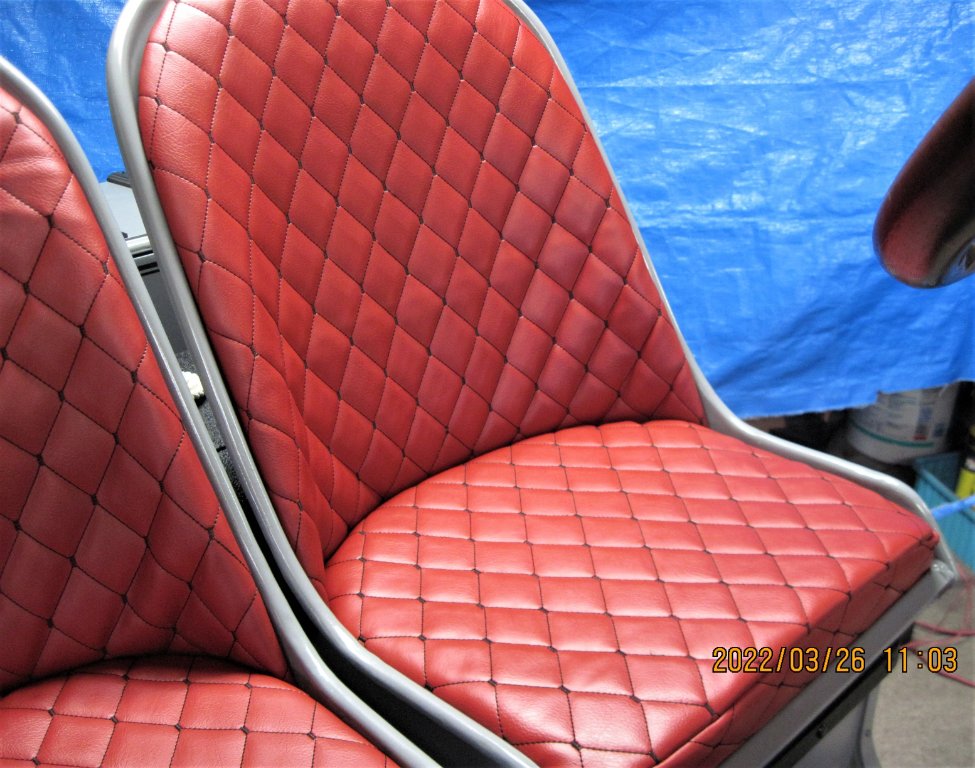

Sorry for the late reply I wanted to finish the seats before taking more pictures. My wife and 92 year old mother in-law finished the seat upholstery today (half hour ago), no snaps or staples needed, pictures show seats in the up position to access the storage under. Woven rope I did years ago stops box lid from hitting gas tank (in a picture). The original aluminum registration dash tag I found in the car so I thought I would keep with the theme and purchased a set of original tags to go with it (front tag is slotted), I'm in NC. Johnny Cash car.
Almost done, step is my next job.
