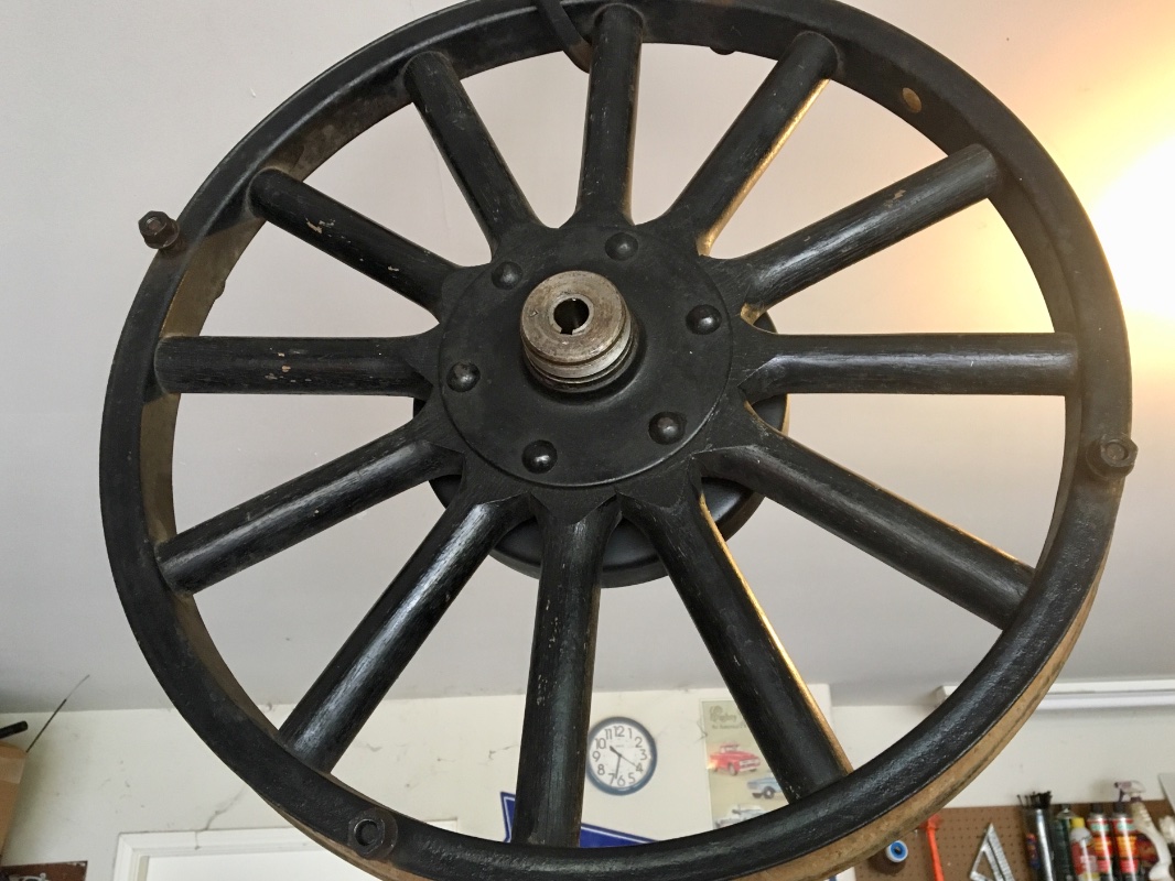

I wrapped up the day by continuing the tack rail project. I’m building the driver’s side curved piece out of plywood laminate like I did the other side.
I also installed the brake drums on my “new” wheels.

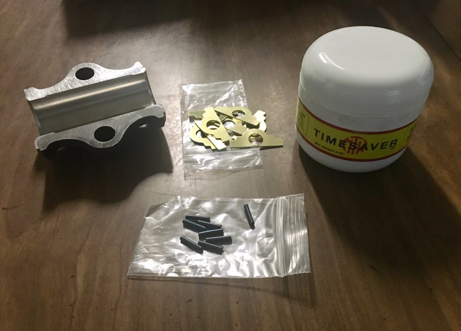

Post by RustyFords » Sat Feb 02, 2019 8:58 pm
It was a good and productive day of T'ing.
I started by installing my Fun Projects pinion bearing kit, then proceeded to completely assemble the entire rearend, driveshaft, u-joint, torque tube, wishbone assembly.
There were a couple hiccups and learning moments but all in all, it went smoothly. I now have the whole unit assembled and painted in flat black. I'll let it dry until next weekend and will install it then. In the meantime, I need to install my reconditioned rear spring set in the crossmember.
I wanted to be sure that the rear spring gets seated all the way up in the crossmember so I removed the rear seat frame assembly so I can see the hole in the crossmember and I also wanted to appraise the condition of the seat frame and the top of the rear crossmember. I was pleased to see that the rear seat frame is in remarkable condition. It's wearing very old paint that is probably factory applied and has zero rot. It's filthy but I'm sure it'll clean up nicely. The brown areas on it, in the photo, are very thick caked on dirt but it does look like there's still paint under that dirt.
You've gotta love dry climates like west Texas and how they preserve old sheet metal.

The mailman was Santa today and delivered everything I need to put my temp engine back together.
A rebabbitted rear main from Gene French and some stuff from Langs. Now to find the time to do it.
I can almost hear it running now!!! :P

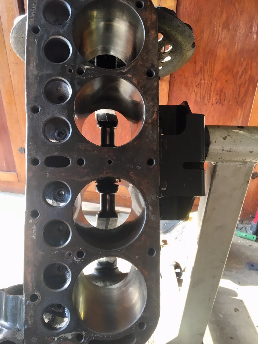

This afternoon The focus was on the temp engine.
I gave the cylinders a quick honing then installed all the pistons and lapped the rod caps with Timesaver. Then I installed new shims and went through the process of removing shim layers until each cap was just right. The procedure I followed was to remove layers until the rod was too tight to turn then I added a shim layer back in.
It kept occurring to me how much easier and enjoyable this process is with the engine out of the car (on an engine stand) that it is while laying under the car!
I also installed the rebabbitted rear main cap that Gene French redid. All of the slop is now eliminated from the crankshaft.
Overall, the engine is now really snug
Yes...I did finish properly folding down the cotter pins after I took the photo below.
I previously lapped the valves and I replaced the valve stem keeper pins. A few of the old ones were slightly bent.
Next I'll see what repairs are needed for the magneto and will order up the parts for those repairs. Then I'll reinstall the transmission and re-line the bands. Finally, I'll re-install the head and then install the engine in the car.

Post by RustyFords » Tue Apr 16, 2019 10:20 pm
Pushed the project forward a bit this evening by installing the valve cover and head.

Post by Scott_Conger » Tue Apr 16, 2019 10:38 pm
Don
see those "dots" on the center main bearing bolts? They correspond to the cotter pin hole. Next time you're into an engine, you'll want to pay attention to them so as to EASILY fit cotter pins to them! ;)
Scott Conger

Post by RustyFords » Tue Apr 16, 2019 11:30 pm
I'm not following you Scott...please explain.

Post by Scott_Conger » Wed Apr 17, 2019 10:18 am
Don
Look at the bolt heads...they're square...there is a "dot" rasied on a corner of the bolt head. If that dot is aligned toward the outside of the block or inside of the block, then the cotter hole will be thusly aligned. In otherwords, if you aligned both bolts such that a straight line can go from the "dot", across the opposite corner of the bolt AND cross over a "dot" on the other bolt and it's opposite corner, the cotter pins will then be a straight shot with both bolts conveniently aligned and easy to put the cotter pins in. I'm sure there is a much easier way to say this but I am flumouxed as to how to say it right now :)

Post by RustyFords » Wed Apr 17, 2019 12:04 pm
ah...ok....got it.
