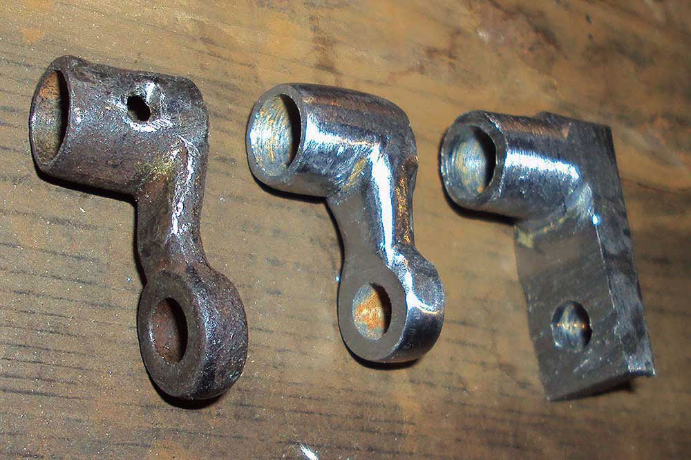

Part of the fun of keeping an old car is being able to make needed parts for it. Touring and maintenance have kept me busy and I haven't had to make anything lately. I thought some parts I made years ago might be fun to post now.
When the nice repro E&J burners were only $85 I decided to try to make some from scratch. Here is the post from 2012:
http://www.mtfca.com/discus/messages/25 ... 1326907131
Whether 5 weeks making 5 of these was worth the savings is debatable but the satisfaction was more that worth it.
There isn't much we can't make if we really want to. Forum members and other car nuts have proved that.
Rich

Thanks. That may be why I have old cars. I like working with my hands. I always appreciate the folks that make repro parts and know what they have to do to make the parts as good as possible. It would be great if they could show us how they do things but might be considered self promotion. I don't have to worry about that. The threads like this certainly inspire me and I hope to see lots more of it.

This was particularly satisfying, fabricating the lower rusted out patch panels on my 24 Touring, this is the rear corner that always rusts through
I cut it out for a template
20161022_103830.jpg[/attachment Took me a day to hammer out the corner [attachment=3]20161022_103830.jpg
Don't know why the pictures posted out of order

Post by Rich Eagle » Mon Jan 14, 2019 11:07 am
This is a simpler project. I needed a handle for my '15 hood.
http://www.mtfca.com/discus/messages/70 ... 1497523020

Post by Rich Eagle » Wed Jan 16, 2019 11:13 am
Making new sleeves for some top irons is show in this thread.
http://www.mtfca.com/discus/messages/70 ... 1510684831

I don't know how you formed those lamp burners. When I form parts they always look home made. My hood handles look wonky & uneven and yours look die formed.

Maybe we make it look too easy when we just show stuff that turns out. Many of my parts do look horrible at some point and as if they can't be saved. I have a pile of things that didn't turn out. With some persistence most can be tweaked, tapped on or filed and polished to a better look.
Just keep at it.

Straightening panels seemed to elude me so I started building a few new ones. The more I did the better results I had. Getting the feel of working the metal helped me learn enough to tackle things I couldn’t do earlier.
I wanted to try to save this quarter panel for my ’14 Touring as it was the only one with the correct fender bead. It was so bad I had nothing to lose. Reversing a wrinkle without stretching the metal any further is the key. Using simple tools I used in fabrication I could persuade the metal nearly straight again. Clamping large areas with lumber and pressing steel flat are shown here. Further smoothing and flattening might return this to show quality by someone with more time and expertise. As this car was not to be given a glossy finish the work done was good enough for now.

I broke what I call the regulator handle on the side window on my 1925 coupe. Looked for several years, and seemed I would never find one. One day, I decided I would make one. Took three pieces, welded them up, and nickel plated it. I thought it turned out pretty good.

Holy cats Mike! That regulator look a lot like the ones for a late Center-Door project I had been waiting for and wait to do. :)
Rich, this is much fun and inspiration for me right now. As always. :-) Thank you.
In the past, I was close. But I waited a week for the idea to unfold in my head for the clutch arrangement on a Twin Y (Maytag) toy tractor for the kids and me I was working with.
I had the lever (discarded lever for something and a vee belt), and some other bits. A week later. Got it!!!
I would be remiss, Mike.

Beautiful work Mike. Thanks for posting it. I have found when you make things like this that you can't find they show up at the next swap meet.
I really enjoyed seeing this.

Post by Rich Eagle » Mon May 20, 2019 12:28 pm
It's fairly easy to whittle out pieces like this spark rod lever with a hacksaw and file. Not perfect but works well.

Post by John Warren » Tue May 21, 2019 9:36 am
Nice whittling :D Thanks as always jw

Today I finished up a mixture control project. Reaching under the dash is a bit of a stretch and a little distracting to my driving. It also alarms new passengers. I recall some accessories made for this but making my own version was fun. Copying the U-joint for 1926-27 cars and the choke knob give this a look of belonging here. I had hoped to mount it below the dash but the angle was too sharp and I had to drill a hole in the dash.
The first piece was the cross. It's cut from 1/4" bar. Filing 3 sides to center in the chuck as shown. Then turning the ends.
Next I cut some 12 gauge for the arms. I traced the arm from a needle valve arm on one end. By pinning the two arm blanks together with a cut-off from the cross end I could use the first curve cutout as a guide for all the rest. Flipping the pieces as needed. This makes it easier to cut them the same. Tracing leaves a little extra metal to trim up any differences after bending. Also drilling the holes smaller allows filing after bending as the holes never line up perfectly. (at least for me) Silver soldering some shanks and drilling them for the rods was the next step. If you are like me tapping #6-32 holes is as scary as driving a T on the freeway. I don't mind buying new taps but a broken one sure ruins the part as well as the day. No problems this time fortunately.
Is it poetic justice to make the knob out of an old T axle shaft? It sure machined nicely and wasn't hardened in this area. The new parts looked nice but I had to take the shine off them with some heat and mud to match the rest of the car.
It turns a little stiffly but that will help keep it from turning by itself. The adjusting needle nut is about worn out. All the materials were leftovers from other projects. The 3/16" rods are from a coil of welding rod that was scraped years ago. I've used a dozen feet so far and a hundred or so to go. It requires some straightening but has light rust and doesn't need further de-finishing. This was a satisfying project and it's nice to be making some parts now that the lawn it caught up with.
