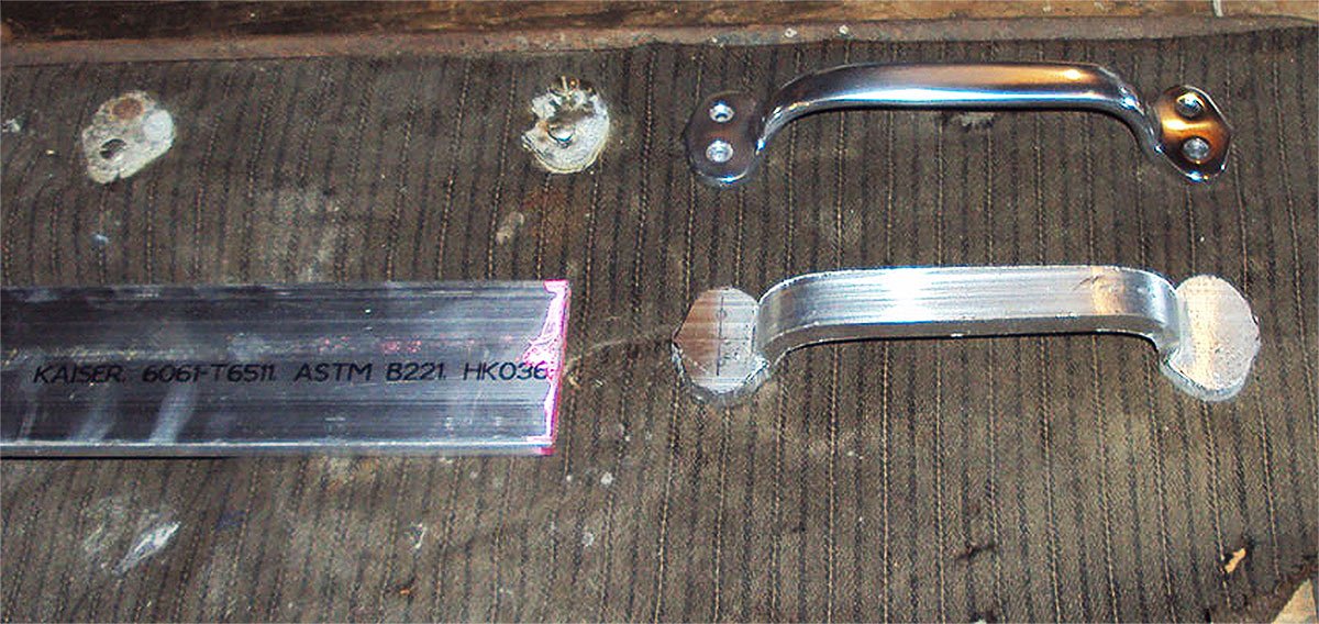

While this isn't a Model T unit the techniques could be used on anything. The rear axle brakes on my 1907 Buick were cobbled together such that they were dangerous. I tried to improve the mechanical advantage but couldn't improve the makeshift parts. I happened upon some Buick patent drawings for a different model but thought it might work. Scaling the drawing to my drum size I could trace out the parts and cut them from steel. The band is just cold rolled bar shaped around a maple block. Screws and pins are riveted and hold it together. Welding might work better but I rivet better than I weld. These work as well as a 26-27 T hand brake now. The Buick planetary had no brake. Just reverse and low drums so I need the rear brake.

Re: Revisiting some fabrication
Rich, I love this thread. Keep posting your fabrications, your a brilliant guy

It's fairly easy to whittle out pieces like this spark rod lever with a hacksaw and file. Not perfect but works well.

The ends of a Coupe door pull, shown at upper left, show that they break easily as they were made of pot metal or some less than durable material. I was able to make two out of aluminum stock. They shaped and polished well. They have worked fine for 6 years.
