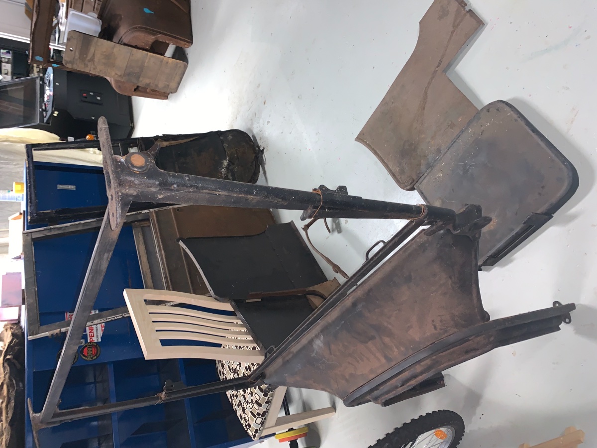

I picked up a town car yesterday or what remains of it. The rear doors and windscreen are in very good condition. I know lots are missing but a great start
Who are the town car experts ? I have many questions
How much of a tourer is the same as a town car clearly the firewall and cowl are. What about the main timber sills ?

Nice find. I don't think there are very many sheet metal parts from a touring that can be used on the town car, unfortunately. In particular the quarter panels and rear panel are unique to that body style (see pic.) Not the step on the very bottom. It looks like you've got most of the hard parts like the doors and the windshield. Good luck with your project, please keep us posted on your progress.

By any chance, do you think the original drawings are still available from Ford? Dimensions would be priceless for a project like this if sheet metal has to be formed.

The '15 town car picture above, looks like the one in Wayne Erickson's shop.
