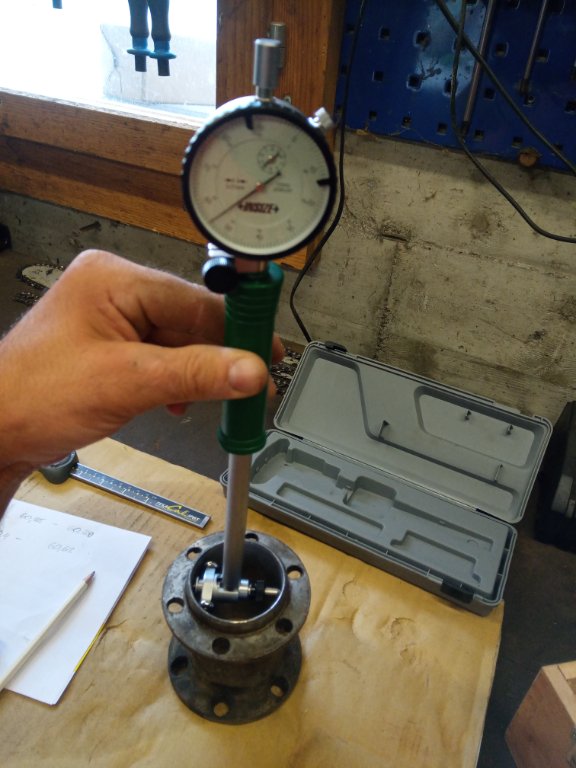

I checked and measured my spool and the Hyatt drive shaft bearing again. I would like to keep the Hyattbearing.
The spool measures 2,377 to 2,387 inches on the inside.
The Hyattlager is nicely parallel and measures 0.559 to 0.560 inches.
Can these parts still be used? Does anyone have a spool in better condition that they would sell?

Post by speedytinc » Thu Aug 18, 2022 3:44 pm
The spool only needs 1 good side, the thrust side.(opposite the ring gear) Give it a quick hone. If you have a good side, you are good to go.
The bearing measures good.
Any of that little bit of wear will be taken up during the new ring & pinion mesh setup.
Spool std size is 2.375 & bearing is .562"
What thrust side do you mean? The bottom side, that takes pressure during braking? The top side, that sees pressure while driving? The far side, (away from the ring gear), that sees the pressure of holding the gears in mesh?
I do see your point. But, I'd only do what you say as a last resort. I'd search out a better spool rather than use one .012 out-of-round.
Of course, I would consider finding a better spool. Real nice ones are not that common. (I look @ everyone I see @ swap meets & rear end part outs.)
If I was particular, I would find an enclosed spool & get a new bearing race. They are available new.
But with one side only .002" worn, It could be a very good part functionally. Turning the spool 180 degrees puts the virgin part of the spool in play. That area got no use. I get your concerns in accelerating & braking regarding the pinion's up & down movement. Let me address that.
If I had the part in my hand for proper scrutiny I could make a definitive decision either way. My experience with these spools suggests what I would expect.
Thrust side 3 o clock.(Virgin race, may be standard) ["The pressure side holding gears in mesh"]
2.377" measured @ 12 & 6 o clock. [Braking/driving pressure]
Worst wear @ 9. This worn area(bad spot) runs from 8 to 10 o clock. This is closest to the gear mesh & is not contacted with the bearing.
Between 7 & 8 and 10 &11 the wear tapers.
I hope my explanation is clear enough to get my view clear on the subject.
To my thinking, this spool still has very good dimensions where it counts.
I have used spools in the pile that measure 2.380" & 2.382" deemed good enough to save. This one in question could be a much better part IMO.

Thank you for your detailed description. I have now measured my spool again. It's close to your guess.
12&6 o clock 2.378"
1&7 o clock 2.380"
2&8 o clock 2.387"
3&9 o clock 2.385"
4&10 o clock 2.387"
5&11 o clock 2.382"
The worn area can be seen in the pictures. 11 to 1 o clock is also porous. That was below. Maybe rust due to water / condensation in the gearbox?
Can I risk it with this spool?
greetings from Switzerland

In all likelihood, if you positioned it in the best possible way, as described above, you would probably be okay. I don't imagine the rear end was needing a rebuild solely because of this issue. I'm sure many of us, with cars restored long ago and lots of miles on them now, have this same situation and don't even know it. Still, I would at least attempt to find a better one first.

Agreed. A quick hone will confirm the best of the bearing wall. I think its usable. Look @ the worn spot & make sure there is no metal flaking away. If there is, I wouldnt use it for risk of the metal doing damage to your bearing & new inner race.

Jerry & John if he ordered the Funproject/ Birdhaven type wouldn’t that eliminate his concern and issue? Just a thought if he is going to have to have it shipped anyway. I personally think it is a much better way to go. IMHO. Best John
I stay with original parts.
I understand that F/P type conversions work very well. I would consider that a good option.

I picked up a modern bearing pinion for my Ruckstell while I had it in hand I machined a spool for the modern bearings using a spool that was in the same shape as yours is ( that was the reason I purchased the new style one) I'm not putting down the Hyatt pinion bearing Quite the opposite I have two complete set aside for the future. But sometimes good spools are hard to find when you need one right away.

I realize that a modern warehouse would be the easiest way.
Although we have many classic cars in Switzerland, Model Ts are very rare. To be honest, I've never seen a mobile Tin Lizzy live and I'm probably crazy that I bought one myself.
When I disassembled the rear axle, I was so fascinated by the old technology that I want to keep it. I think maybe someone will come after me and be fascinated by it again.
Finding a good spool here from Switzerland is very difficult. I recently bought one off ebay. The inner surfaces looked very good, but measuring them showed much greater wear than my spool.

I would contact Lang's and ask what good, used spool they might have in their inventory.
