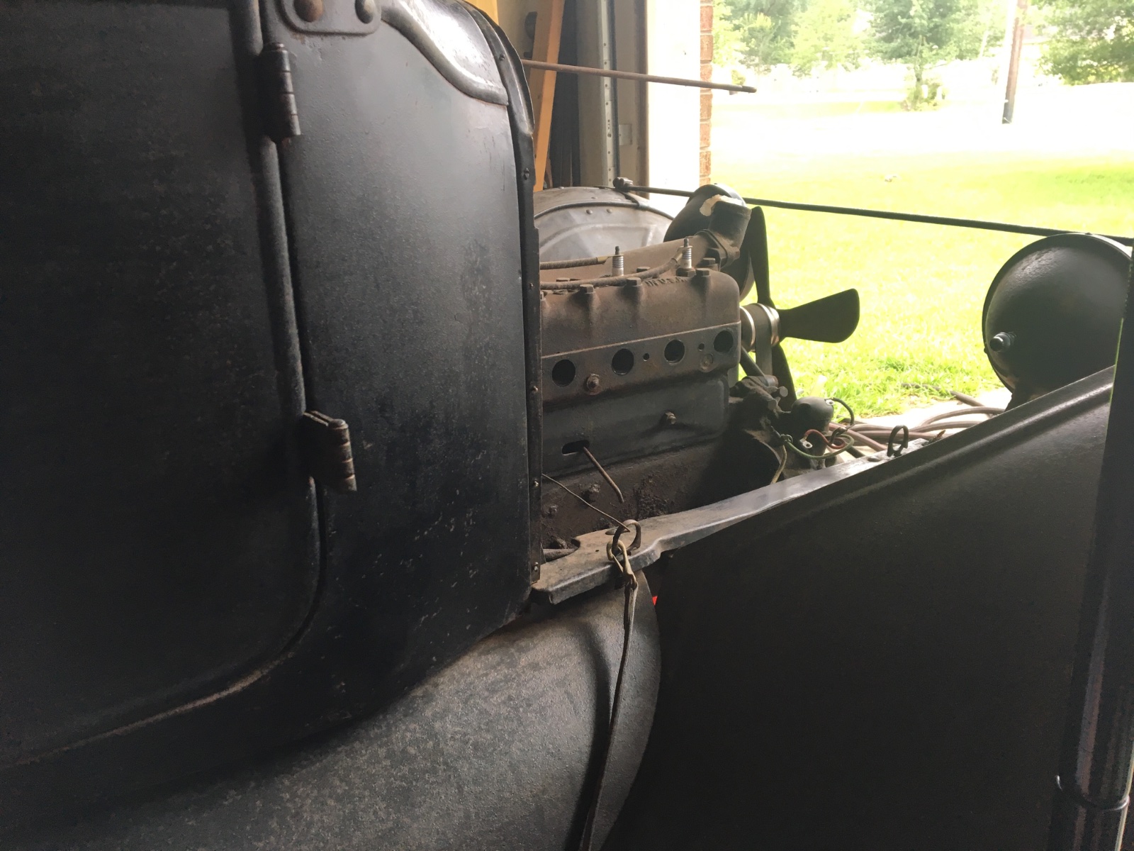

The old girl is coming along.
I think a realistic goal is to have it running and driving this summer.
I could probably hastily assemble what I have right now and get it running in a couple weeks, but I'm going to resist that urge and continue to be methodical about things and do it right.
Observant viewers will notice that the driveshaft isn't hooked up. I have it hanging by some bailing wire to make pushing it around a bit easier. And also because I'll be swapping engines soon anyway.

Re: 24 Touring Barn Car Revival - Part 3
Big step forward today.
I pulled the engine that came with the car and installed the "freshened up" engine. Not having done this before with a Model T, there was a learning curve. So, what probably should've taken a couple hours, took me about 4 hours instead.
Based on what I've read on this forum, I thought I might have to remove the steering column, but managed to pull the engine without doing so by sort of twisting the engine as it came out. For the installation, I applied a thin layer of grease on top of the frame rails between the firewall and engine mounting holes. Then I pulled the engine rearward with a ratchet strap until it fell into position.

Taking full advantage of the time I had today, I installed the exaust pipe and pumped nearly a full tube of grease into the u-joint grease fitting.
Then, I installed the coils and a fresh battery and rigged up an "I.V." gas line and jacked up one rear wheel. Then, for curiousity's sake only, I choked it a few times while turning it over with the starter...then turned on the ignition and hit the starter again.
And wouldn't you know, the old bucket sputtered and coughed right away. This was without any attempt at setting the initial timing or even setting the carb mixture adjustment.
I had to call it a day after that, but I'll be back at it again tomorrow.
I'm going to treat the fuel tank with acid first thing in the morning, then by late afternoon, it should be ready to install and accept gasoline. I also need to install the hand brake and all that goes with that system (which is why I tried to start it today with one wheel jacked up). So...in spite of the fact that I had a sign of life, I still need to do a few more things before I have a runner. When I do, however, I'll film it and post it here.
From the outset, I suspected that the coil box in my car was most likely OEM and had never been touched or maintained. I knew this couldn't be helping the car any as far as running smoothly, so I ordered a Fun Projects Coil Box Kit and, over the weekend, installed it.
It was fairly straightforward but one does need to follow the instructions in order to get it right. The one step I skipped was soldering the contacts to the posts because I didn't have any rosin core solder. At some point in the future, I'll probably pull it back apart and do this.
After the reworked box was installed, all hard starting and intermitent missing issues were resolved. I'm sure that my rebuilt coils were not making full contact in the old box.
The most surprising improvement was the magneto performance. I'd never noticed the "surge" in the engine that so many people report when switching to mag. My car tended to run about the same or slightly worse. After the rebuild, the surge is very noticeable.
I am very pleased with the outer appearance of the box. It's a rust-free (gotta love the way west Texas preserves old metal) Ford stamped piece wearing the same nicely weathered factory paint as the rest of the car. And, like the rest of the car, it responded nicely to the Penetrol treatmemt.
