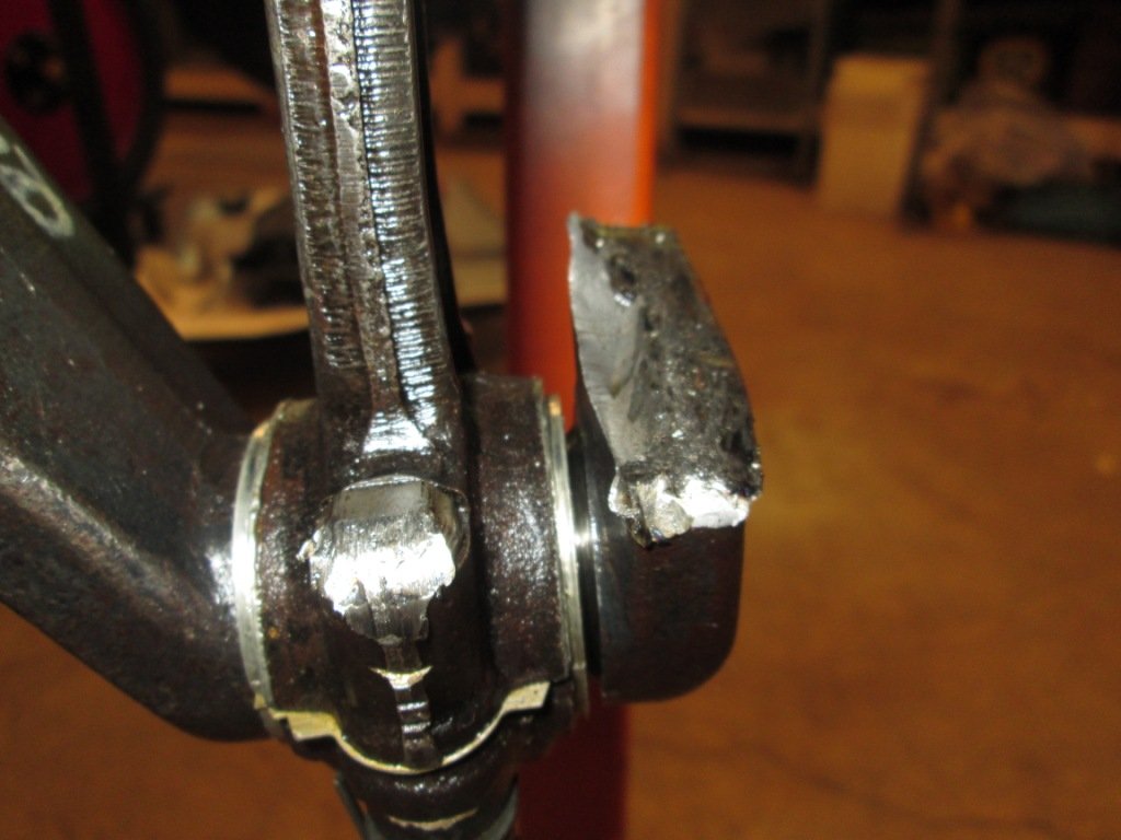

Assisting a friend who joined "The Club" last fall during a NWVS Endurance run - seems a coolant leak (Z head in question) into #3 cylinder caused a "tube-lock" which bent the rod, broke the crankshaft at #3 then proceeded to take the rear main bearing web out of the block !!! I installed this "rebuilt" short block into this speedster 5 years ago and he had finished multiple speedster events with the car - it was a strong runner. Other than the internal damage, the failure damaged the Bendix drive beyond repair, buggered a few of the starter ring gear teeth, nicked the c.c. & lower cover in a couple spots and slightly dinged 2 of the oil slingers (Dan McE.'s - the best ones !) when the transmission bitch-slapped the pan !

Hydro lock happens on engine startup, after a shutoff engine leaking coolant, or as in the case of a modern race car, leaks fuel into the cylinder. The pressure in the cylinder on restarting the engine causes a bent rod or casting failure and worse damage. For this to happen in a running T engine, with its large combustion chambers, it would require a total failure in the head due to excessive milling to increase compression resulting in a weaken chamber. My guess is that the T crank broke first and the other damage happened as the engine continued to turn in some cylinders and not turn in others, bending the number three rod. In any case your T engine is now a sad story and a candidate for shop art.
Posts: 7182
Re: Catastrophic Failure
Post by Allan » Wed Jun 07, 2023 8:12 pm
I agree with Kevin's diagnosis. When this damage happens, I always look at the third main bearing web in the block. As mentioned in a previous post, the land on which the third main bearing bolt heads rest is a perfect stress riser from which cracks can and do originate, especially on early blocks.When that happens, the crack surfaces tend to "work" on each other, polishing them, before the final clean break. Then the broken rear main web results in a broken crankshaft.
From the photos, the break on the web appears clean and fresh for its entire length, which suggests in this case that the crankshaft broke first, taking out the main bearing web after it let go. An expensive rebuild either way.

It may be the camera angle, but the picture of the crankshaft looks like an old, dirty crack. The freshly broken section is clean.

It was running down the road when it broke on my friend - my initial diagnosis seems incorrect in the series of events - no matter - worse one I've had in my shop for repair !!!

While I'll be the first to admit that pictures don't show everything here's my initial view based on the limited pics...the crank had a big existing crack in it up in the thro' and was a ticking time bomb. Look at the cleave, is it all sugary soft gray? A shiny mark means it rubbed AFTER failure, a dark mark means it has been soaking oil for a while, a long while. That picture seems to show a dark spot before the first big contour mark (beech mark)? Then, look at the subsequent contour marks. how big a jump did each take? Each jump in the contour marks is the mode of failure progressing. Generally speaking from lots of donated broken crank club exhibits, an average T crank shaft can survive normal operation with small jumps from time to time while actually broken 1/3 of the way thru and only then do the contour lines progress as rapid failure.
The block, the poor block? Same sugary texture applies. That all looks like dull gray sugar...but the OP can look and see if the area by the main bolt down is something else and dirty, or there is a series of ice pick dimples somewhere (indicative of small blow holes on cooling. Shiny and a bit of a polished look means the two separate block pieces were bouncing on each other before letting go.
As to the rod? Yeah, its bent...when it bent will always be open to discussion but leans toward the initial visual diagnosis as a bent rod in the plane shown is NOT indicative of a rotational failure.
