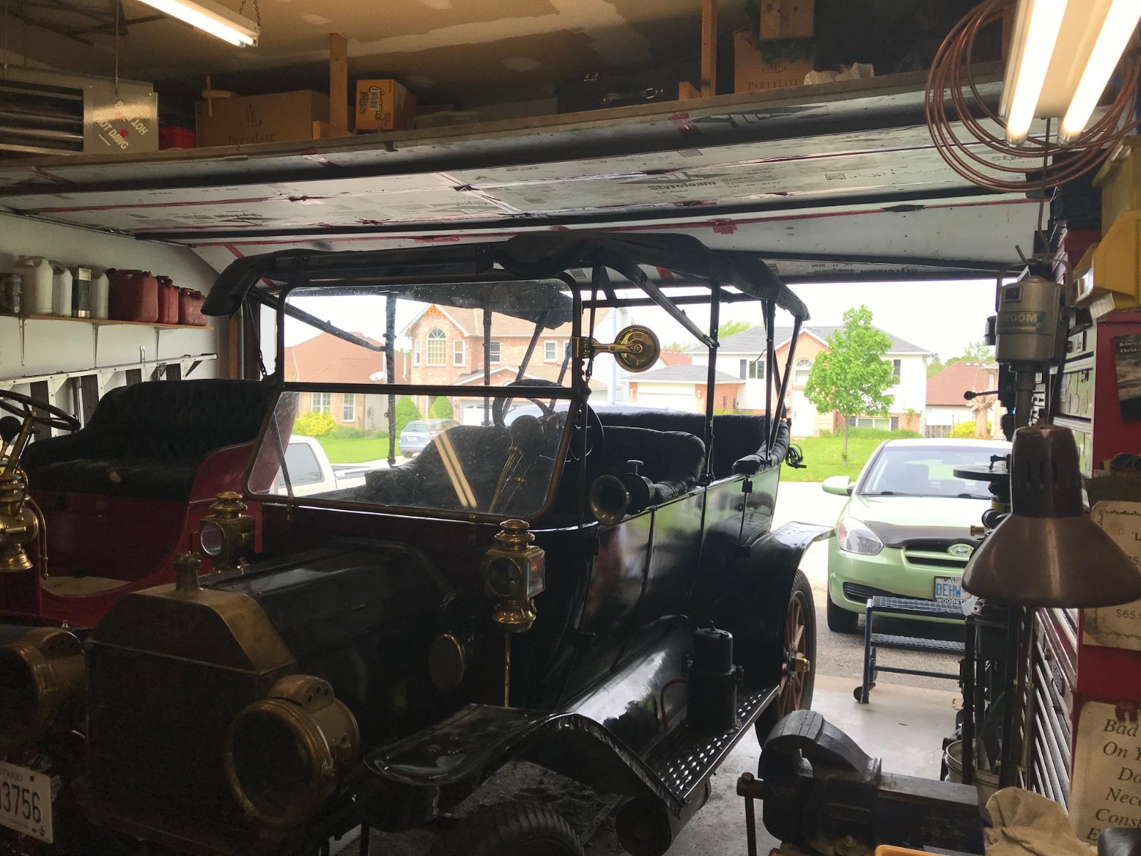

More pics from today's work

Had to correct the top pad on the driver's side, the pic was taken before I did that. These project require a gazillion checks and rechecks. So far, all the dimensions are really good. I've been using a pictorial guide from Royce Peterson's website and it's been a huge help, with a lot of time saving suggestions! This is the third top I've installed in 20 years, but this one is going a little easier thanks to what I've learned previously from my past mistakes

Much better now!

A little more progress....too cold to tack to the bows. Classtique left the Murphy fasteners off of the bottom row so I could match them to the car's original fastener positions. I wonder why they put them on in such a manner?
