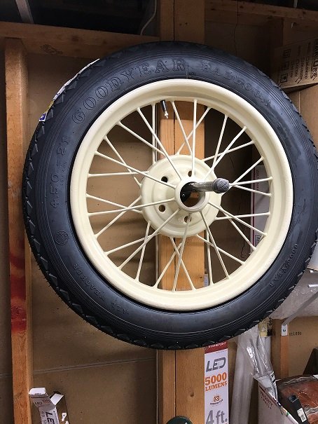

Painting wire wheels can be difficult. I have painted several sets and here is how I do it for good complete coverage and keeping them suspended so nothing touches wet paint:
When the wheel is all ready to paint I brush the inside center and inside where the tube lays then set them aside for a day or more to dry. Next I have a short section of front axle cut off with a spindle attached so it won't flop around. I put a front hub on that and mount the wheel. The axle stub is slid into my engine stand and that keeps everything at a comfortable height. You could put the axle in a vice or build a stand and anchor the axle with u-bolts. Now you can paint from all angles to get the spokes and spin the wheel by touching the tube contact area that is already painted and dry.
Now you either wait a day to remove the freshly painted wheel or take some clothes line and rope around the tube contact area that was previously painted and remove wheel to hang and move on to the next wheel.
This has worked well for me to get the spokes painted completely. You can spray from the outside and inside but can also spray at angles from the hub out and the rim in towards the center if that makes sense.
Nothing worse than finishing a wire wheel and later finding a spoke that didn't get paint in one section and it is surprisingly easy to do that.

- Posts: 6924
Re: Painting Wire Wheels
Tim, I use a stub axle and hub to take the wheels too. I do mine on the horizontal rather than in their normal plane, and I do the whole wheel all at the same time. i start at the valve hole and count spokes, spraying all from one angle, then repeat the same operation spraying on the other angle. Then i turn the wheel over and repeat the same process, so the spokes are sprayed from 4 directions.
There will already be paint on the hubs and felloes from this, so spraying them is easy because the fiddly bits around the spoke ends are already done. This also prevents runs, as there is no extra loading around the spokes.
I hang the wheels to dry. To lift them off the hub and to hang them from a beam in my garage, I make a lifting hook for each wheel.
This consists of a 1/2" flat washer with a wire twitched to it and a loop formed in the other end of the wire. The loop passes through the valve stem hole. then the whole wheel can be lifted from the hub with a hook already through the wire loop, and the wheel suspended to dry. The washer on the wire makes as little contact as possible with the wheel. Because I always use spraying enamel for the best gloss and best flow of paint, it is easy to touch up. I can even brush out runs, if they develop, and I catch them in time.
Powder coating is easy. You just have to pay the price. But then there is the problem of touching up. breaching the coating with wheel lug nuts and the breakdown of the coating where laced spokes contact others,
Just my experience. Others will have their pwn experiences.

Here in California you can have wheels powder coated pretty cheap through Les Schwab tires. If you want black most powder coaters will work with you if you can wait til they have a batch to do. I painted my buffaloes and it took about a third of a gallon to paint 5 wheels. Most of the paint just misses.

The wheels with a primered when I got them. Am trying for a period look, not modern paint job. So just used some Farm Implement paint, several coats with a good brush - its rock hard. Rust-oleum also has different colors, other than Farm manufactures, as Safety colors.
Some argue that its harder to touch up a powder coat if it gets a chip in it- but isn't a chip against the reason for having it powder coated in the first place? Usd low-gloss on the undercarriage & Used IH white on the wheels - not available anymore - hope I don't gt a paint chip
