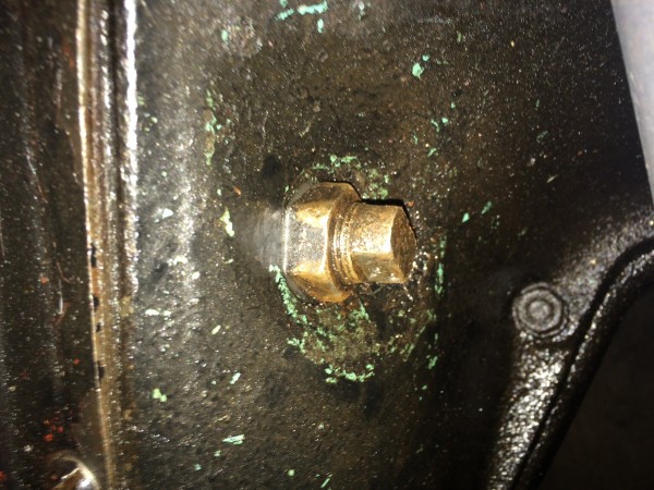

Here's a picture...

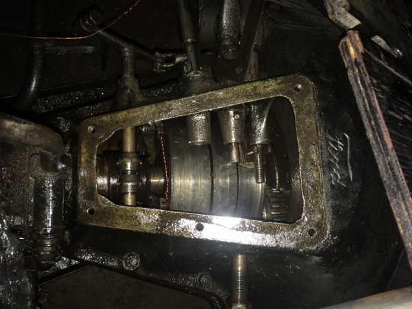

Lets peek inside Dave.

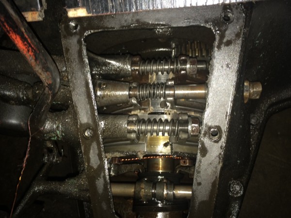

Post by Ruxstel24 » Tue May 28, 2019 6:32 pm
Afraid I know the answer already... :(
Not even half way on brake and reverse, but low is definitely worn. I see the quick change ears are on the wrong side too.
I remember low Band always did wear faster, I will look at the drum once apart. Lots of fuzz in the screen, maybe 200-250 miles.
I will post progress.
BTW, the safety wire is copper coated, 'tis attracted to a magnet. ;)

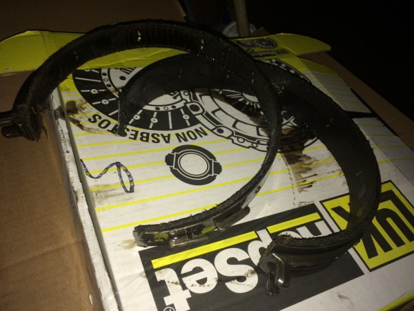

Went ahead and got the brake and low bands out.
Used mostly some bubble wrap to protect from the dreaded MIA washer/nut, worked good. :)
One piece of cork was no longer there, before or after ???
I really like the way the cork feels and wears pretty good, considering the same thing. Just a couple on the ends is what Pop did.
The low band was worn, but not scary yet. :?
