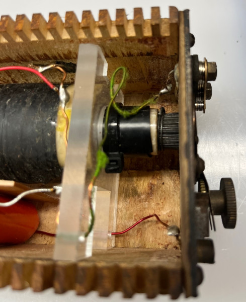

Here’s a simple drawing of the two support plates that I used in the Heinze coils. I made these on a milling machine but you can do this any way you wish. I’ve used both wood and plexiglass for the material. The slots are there only to allow the potting tar to get all through the coil. The only important measurements are the location of the hole for the primary core to go through, and the outside dimensions.
Last edited by Darren J Wallace on Thu Dec 04, 2025 3:30 pm, edited 1 time in total.
Darren J Wallace
Posts: 362
Joined: Sun Jan 06, 2019 11:43 am
First Name: Darren
Last Name: Wallace
* REQUIRED* Type and Year of Model Ts owned: 1913 Canadian Touring 1905 Queen model B
Location: Woodstock, Ontario, Canada
Re: Rebuilding 1912 Heinze Coils
Post by Darren J Wallace » Thu Dec 04, 2025 9:29 am
When you assemble everything, I used zip ties to hold the plastic plates lightly snug against the secondary coil. I used mechanical wire to hold the core snug on the primary coil. You can see where I have installed the first one on the right end of the coil. As long as the original iron core rods are good and tight in the cardboard tube, don’t get too hung up on how tight the zip ties are. They need to be tight of course but when the tar is poured in, everything will be solidly frozen in place. You just need them to hold everything from moving before tar is poured as it’s important to test the coil before committing the tar. The iron core rods MUST be tight enough that it is difficult to slide them all by hand. You should have to install the last of them with a small hammer.
If you lost any shims that were underneath the original primary core, the core top wants to be just slightly under the top of the top metal plate to flush. Within 1/64”.
Remember you are pouring the tar in from the top with all four panels of the coil assembled.
Last edited by Darren J Wallace on Thu Dec 04, 2025 3:33 pm, edited 2 times in total.

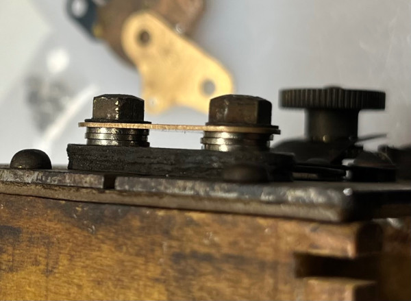

Zip tie details

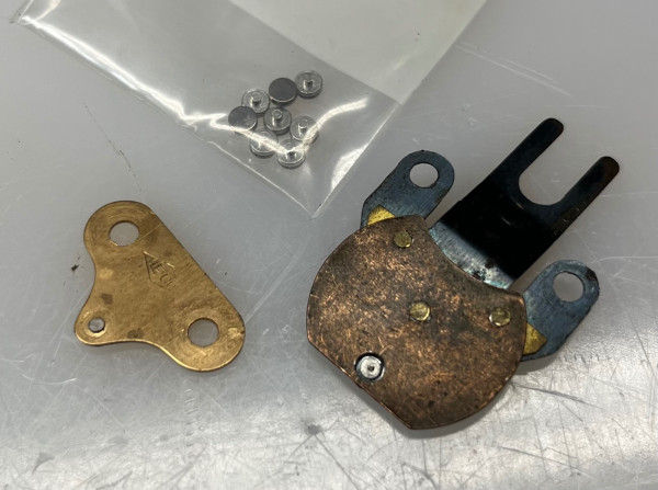

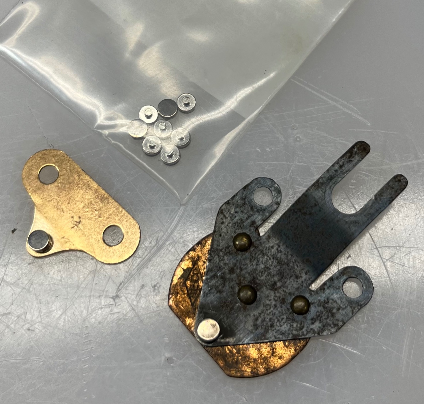

I used a 1/8” end mill carefully in my milling machine to access the point rivet. You must drill out the original hole to .062” to accept the new point rivet. Care must be taken not to distort the original parts. I use a machinery bench block to insert the old point side to carefully punch out the old point. You will trash your 1/16” drill drilling out the hardened spring material so drill the brass upper rigid point first!😉
Last edited by Darren J Wallace on Thu Dec 04, 2025 3:35 pm, edited 1 time in total.
Darren J Wallace
Posts: 362
First Name: Darren
Last Name: Wallace
Post by Darren J Wallace » Thu Dec 04, 2025 10:34 am
Because of the larger thicker points you will have to raise the upper stationary point considerably. In this case it worked out to just a few thousand shy of 3/32”. I use washers as shims to get the height right, then once I’m happy with the thickness required, I machine black plastic spacers which look less obtrusive.
