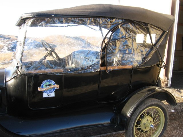

Mine came with no top also. We purchased some well used bows, bought the wood for them, and installed the top ourselves. Thanks Teresa! We then bought some clear vinyl at WalMart, along with some black vinyl fabric, and made the side curtains. I don't like the lack of visibility with the stock curtains, so we made them clear vinyl except for the perimeter, which we put fasteners on. We bought Murphy fasteners from Northwest Tarp and Canvas in Bellingham, Washington. We made each side as a single piece, with a double sided large zipper for entry through the doors. Use a large strong paper, or a cheap tablecloth to make a pattern and make sure it fits before cutting out the heavy vinyl and trimming with the black fabric. Teresa says to use tape to hold the pieces together rather than pins before you sew it.We don't use the curtains often but they are wonderful when they are needed. We have even been able to put them on from inside the car and avoid getting wet.

Yeah, I want our curtains to have more clear and less black than the originals did, just enough black to fasten them on with. And of course the little flaps to open and stick your hand thru to open the door from outside. I want GOOD visibility.
Our top will not have the roll-up rear window. We don't have the straps that go on either side of the rear windows, on the inside, but the "top man" say he can make some that are better than the store bought ones anyway.
