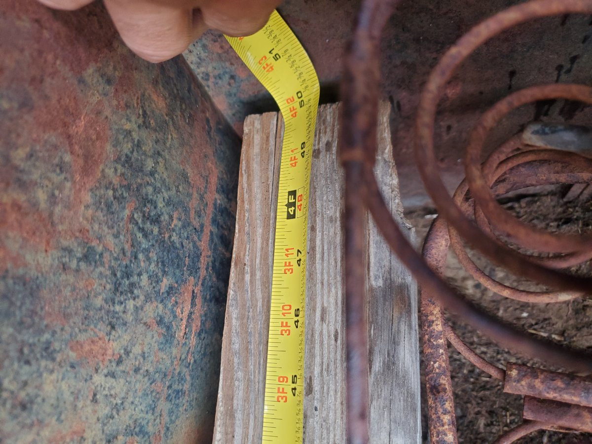

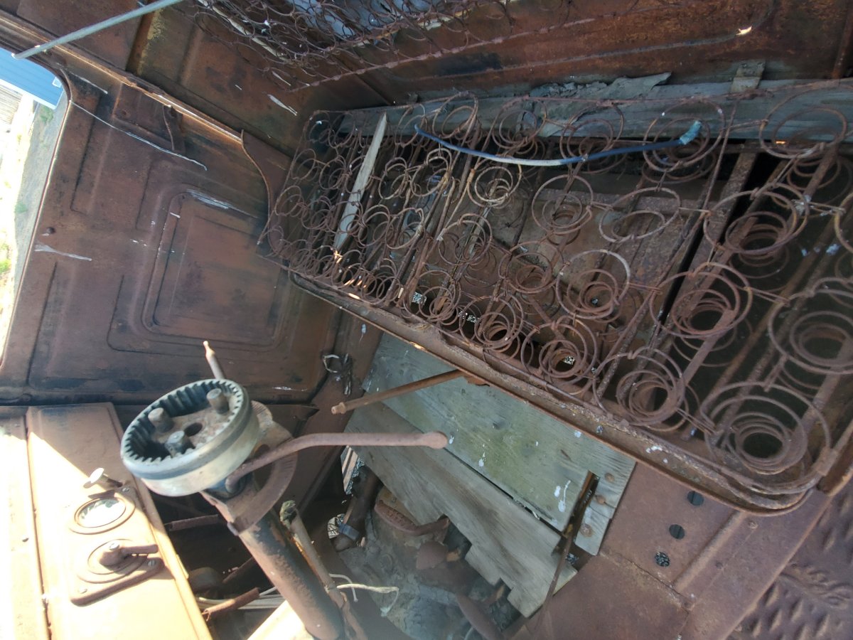

Posting measurements/pictures of the wood behind the seat of the TT for a member who emailed me.

Thank you for the pictures.

That board looks just like the one in my 26 TT. I posted measurements off of mine up here a month or so ago along with a diagram of it as well. The front edge is beveled. - Matt

Thanks Matt, my 26 TT is missing that board.
