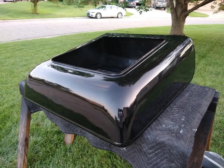

Once I had discovered that I could color sand urethane paint, I needed to decide whether to use a two-stage system (base coat plus clear coat) or a single-stage system that had the gloss built in. I decided on the single-stage system because I wouldn’t have the risk of sanding though the clear coat and wrecking the job. I settled on using Eastwood’s single stage urethane Boulevard Black gloss paint. You can choose between two activators depending on the temperature that you will be painting. Since it was still summer, there really wasn’t a choice; get the activator for 80+ degrees. I also got reducer to go with the paint. I wasn’t going to make the same mistake that I did when I first started priming!
The first evening I painted the bottom of the parts and played hooky from work to paint the top sides. I had learned that it is much harder to see painting with black in the paint tent, which is why I wanted to paint outside. This is when I made my biggest mistake. The first coat went on really well early in the morning, and I thought wow, this is turning out pretty well! The disaster was the 2nd coat. By now the temperature had climbed some, but the big problem was that the now black parts heated up too quickly and the paint didn’t flow out as well as the first coat and left a rough surface. To make matters worse, I had “solvent pop” everywhere. Solvent pop leaves micro pits that I have found are very difficult to sand out, and can go down to the primer, resulting in a bunch of white dots on an otherwise black surface. I had wasted a day of vacation and a fair amount of paint, and had some bad looking parts. I was also almost out of paint, so while waiting for the paint I tried color sanding the parts to see if I could salvage them. I’ll describe that process later, but I couldn’t salvage them as painted.
After I got more paint, I decided to only paint in the shade if outside, or in the paint tent with better lighting or facing the open garage. My painting skills seemed to improve as I repainted the upper surface of everything, and finally the body. Model T’s are small, but there are a lot of bits and pieces to paint, and some parts are very tricky to paint. I found that painting the top bows to be a challenge because they are awkward to deal with and getting the paint to be smooth on all sides can be a challenge. This is because the paint swirls around the blunt cross section of the bows downstream of the surface being painted. I painted those things more than once before I was happy with the outcome.

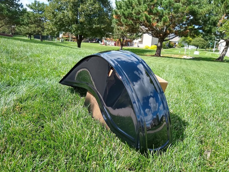

The fenders are also tricky because they have a lot of edges, beads and that 1” lip under the edge of the fenders. I save the body for last, and by comparison, it was easier than the fenders. The biggest challenge was fighting runs in spots. The paint would look fine, then bam, a run started forming. I would deal with those during the finishing process. Even though I was painting in the shade and at the proper temperature, I was still getting solvent pop in spots. More on that later.
Color sanding
While waiting for my 2nd order of paint, I decided to try wet color sanding and polishing the splash board and fenders, figuring that it would be a good learning process. I’d just repaint them if I didn’t like the results.
My online research suggested using 1000, 1500 and 2000 grit sandpaper before polishing. Those worked well for me. What I also learned was how important it is to get flexible sanding blocks. Don’t try color sanding without them! I used three; from pretty hard to pretty rubbery. They are sized to use half of a 8 ½ by 11 sheet of sandpaper wrapped around them. Think of the sanding block like a plane, with the sandpaper like different size blades. The hardest block should be used first, as it will stay firm while the sandpaper lops off the peaks of the orange peel, dust particles, small crickets (yes, trust me), ripples caused by sweat drops onto a freshly painted surface, and runs. It even worked removing fibers and the roughed-up surface causes by my drop cloth that front fenders where on drying when the wind flip the edge onto them.
I progress from hardest to softest block with each grit of sandpaper, though I didn’t always use the hardest block by the time I got to 2000, because the surface was already pretty smooth. 2000 is mainly for removing the sanding scratches before polishing. As my painting skills improved, my orange peel lessened and I would then start with 1500 grit sandpaper. Speaking of sandpaper, I’m as cheap as most model T owners and was tempted to use a piece longer than I should’ve. Try to suspend your cheapskate tendencies when it comes to sandpaper. I did and am glad that I did so.
Polishing
After wet color sanding, it was time to try out the polisher. For the polisher I once again went to Harbor Freight and got this one:
https://www.harborfreight.com/7-in-10-a ... 62297.html
It is important to know the RPM of the polisher, which is why I got this one. “According to the internet”, you want to use about 1500 RPM for color sanding. My results confirm that. Too high and you can burn the paint. I lowered the RPM to 1000 for final work. Even at 1500 RPM the surface can get pretty hot, and while I never burned the paint, I did melt a bit of the foam head in spots that I needed to remove. Also, tuck your shirt in when using this thing. You’d be amazed how quickly it will go from the piece that you’re polishing up to your arm pit after it grabs the loose end of your shirt. Trust me on this one.
These types of polishers use a foam head that attach to Velcro on the bottom of the wheel. You will need one made for rubbing compound, and one for the finishing compound. The first is firmer than the latter one. You will also need rubbing compound and finishing compound that is sold in big bottles that you squirt onto the surface. I got some from the local paint store, but Meguiars is a brand that is available at a lot of stores. Some videos show people putting dabs all over the part and then using the polisher to spread it out. That seemed kind of silly to me. I first used my hand to spread it around the part thinly. That way I knew every area had some before I started polishing.
The first time you sand a painted part, you feel like you’ve wrecked it. Even if it wasn’t perfect, it looks worse now. Yet using a polisher will soon bring out the shine. The rubbing compound is used to remove the remaining sanding marks and should bring the part to a dull, mirrored finish. The polishing will turn it into a great shine. It will also show you areas where you missed, so don’t be disappointed if you need to start over in areas with the rubbing compound or even sanding again locally.
Regarding how long it takes, for me it would take about an hour to sand and polish a fender top. I did not mess with the undersides of the fenders. The hardest parts to sand and polish are the hood pieces, with the louvers, rivets and handles. Even trying to be careful, you may still blow through the paint in spots on the rivets. I did. However, I just pulled out my black paint marker and carefully touch up those spots. They work really well for this. The body took about 3 hours to sand and polish.
I mentioned earlier the large amount of solvent pop on the initially painted parts. I was not successful in sanding those out, before I blew through to the primer. Even after repainting in the shade, I still it in the runs that I sanded down. I tried filling them with dabs of paint put on with my finger and even black wax, but just couldn’t get rid of them. Fortunately, there only in a few spots and are hard to see.

Mario,
I'm not sure, as it depends on if you're asking about all the stripping, priming and painting of everything, or just the body, fenders and other parts that I used the urethane paint on and color sanded. If that is what you meant, I probably spent less than 50 hours on that aspect of the job. That includes probably 10 hours or so having to resand and repainting the various parts that had the solvent pop that I couldn't sand out.

Nice looking job, Neal. This is one of those things that you have to be willing to pour yourself into to understand how it works.
Nope, I'd say Neal pretty much nailed it. Every generation wants to think they're superior to the one that came before, but that's not usually the case. The paint trades had been turning out high class work in the decades before the Model T came along and mass production picked up on it and refined the processes to suit them. The materials may not have been as durable as what we have today, but the class of work was very good. Nobody yet has been able to show me an era photo of a new car with an obviously amateur paint job on it.Burger in Spokane wrote: ↑Sun Sep 15, 2019 10:26 pmFrom the photos, I'd say your paint and body finish looks 10x better than anything Henry ever sent
out the door in the black era. After years of long and expensive body and paint
restorations of 50's cars, I am SO done with having vehicles that require such perfection
to look right.

Neal, did you paint the hubs yourself or did Stutzman do that for you? ARe the rims brand new? Thank you.

David,
I primed the rims and painted the hubs before sending the parts to Stutzman's. If I was doing it over again, I wouldn't paint the hub pieces, except for the brake drums, because they got chipped up during the wheel assembly by Stutzman's and I need to repaint them when I paint the rims after the tires are installed.
