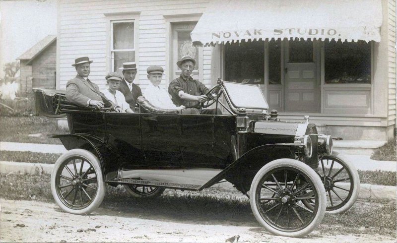

Re: 1913 body striping
This is perhaps the clearest photo I have a '13....definitely no striping on the runabout body...but definitely on the wheels.
This one is relatively clear as well...no body stripes, but you can see them on the wheels.
