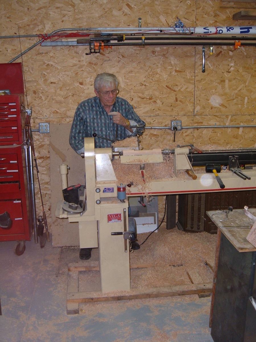

To do your own spokes you need: an 8/4 Hickory plank, an accurate saw (table), a lathe and probably a radial arm saw and lots of time. I found it fun.

Re: Replacing Wood Spokes On Model T
Some years ago I decided to make a set of spoke for demountable wheels. Finding the wood in the west coast was tough and quite expensive. I make the first out of pine as it was easy to work and I could add a little where necessary. After I had the pattern I started and by the fifth I was getting pretty good. By the twenty fifth I was almost an expert but beginning to get bored. By the fiftieth I was absolutely bored and glad it was over.
I used a version of the Regan press and all the wheels are still in use.
So it can be done but it is a challenge.
