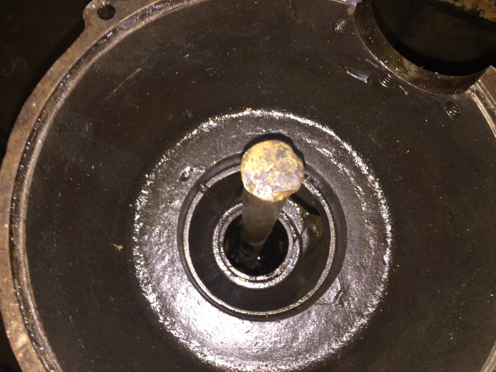

Before I fight myself or damage something...
Does the dummy bearings/sleeves just pop out after removing the lock screw where the grease cup would be ? Or will I need to rig it up in my press ?
I need to replace the axle seals that are behind them.
I have a slide hammer with a bearing removal attachment for the bearings, which should do the trick. Or I can pull the inner hub off and press it too. The bearings seem right but I will replace them anyway after all this.

Mark, from what I understand, these are an early version of the modern safety hubs.
The only difference is the new ones have a snap ring on the outside between the spokes. This will hold things together if an axle snaps.
I’m considering cutting a grove for a ring. The weight is still being taken off the axle shaft and onto the housing, so I think the likelihood of a breaking an axle is much less.
The slide hammer might work, but I have the axle all apart and not easy to support to whack on it, but maybe they’ll come out easier than I expect.
Hank, I was going to put some sealer around there and the axle to hub fit. I had oil in the brakes, but shouldn’t with this set up right.

I want to get it apart and see what’s in there now. There’s a remnant of a modern seal rubber on the shaft and the rest looks like it is behind the dummy shaft. Once I get it out, I hope I can match this stuff up at Akron Bearing supply.
I believe the dummy or stub shaft has a couple o-rings now that I’ll replace.
Probably looks similar to yours.

So I tried the slide hammer on the dummy bearings today. Problem is that the dummy and the rivets are too close together for the bit to flip and catch only the dummy.
Also the ID of the rivets inside the tube are about the same as the dummy bearing. So I can’t catch it easily from the inside.
Any suggestions ?
I also got the seal out, but don’t see getting it back in without pulling the pieces out.

Dave you might have to drill and tap to 1/4” x 20 thread wells 180 degrees out from each other, install grade 8 bolts with a bar and use your slide hammer that way.
Hope this Helps,
Hank

I think I have something that I can push against from inside and found an old spool fits nicely on the outside to support it.
Gonna try to get it in my press this way tomorrow.
I found a 3/8” flat bar that’s wide enough and just clears the rivets on both ends of the tube.
If this is a no go, I’ll try the drill/tap trick.

Post by Ruxstel24 » Mon Dec 09, 2019 10:17 am
I got the sleeve out !! :D
Before getting it in my press, I found the piece of flat steel I had was still hitting a rivet inside the tube.
I eventually found a large axle nut from a half shaft from something. Dropped it in the tube and fished it past the rivets and it caught the sleeve. Long brass punch and sitting up on the old spool, knocked right out with little effort.
I think it will work better on the other side with the seal still in place. ;)
Thanks all for your help and suggestions. 8-)
