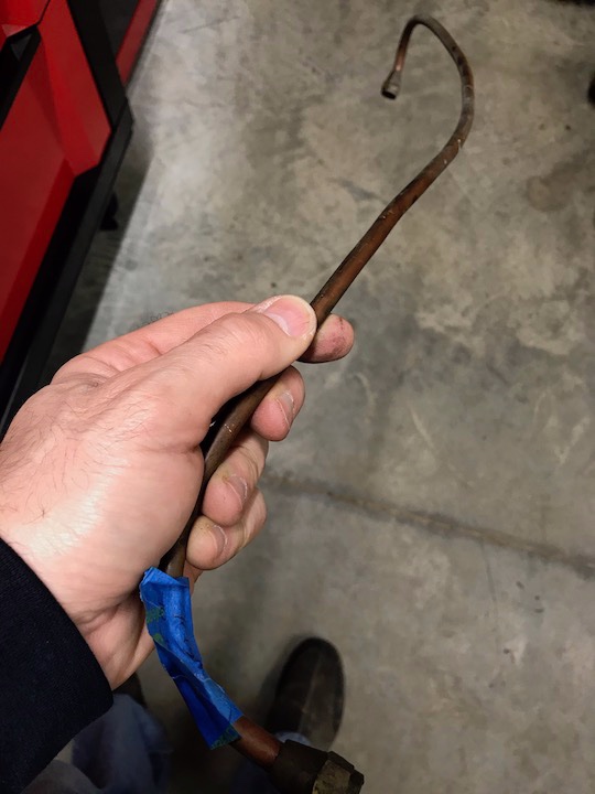

The oil line.
More to go.....

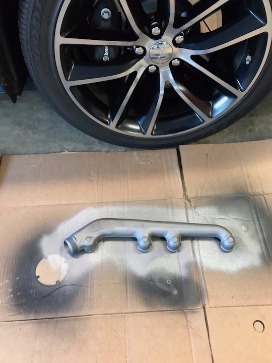

Re Sparkplugs
generally speaking, the front, #1 plug will run the coolest and rear #4 plug will run the hottest. It is the nature of the beast with respect to coolant flow.
That said, nearly every as-is car I've worked on, has cheap $2 paper gaskets at the intake/exhaust manifold glands. They invariably are deteriorated to the point of failure. It looks to me that you have an intake leak and to run, the carburetor is set to very rich to keep the car running. This results in two plugs running very lean and two plugs running very rich.
Use these: https://www.modeltford.com/item/3063-64.aspx if your exhaust manifold is straighte enough (it almost surely won't be), so if not, use these: https://www.modeltford.com/item/3063MC.aspx
If you want to have high probability of failure and warp the exhaust manifold further, use this: https://www.macsautoparts.com/ford_mode ... erial.html which of course you don't want to do..just wanted you to see what an inferior product looked like

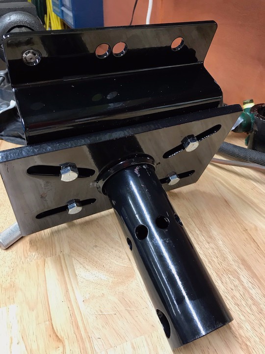

Well so far today I got the plate mounted to the engine stand.

OK let's play what the heck is this from? When I pulled the pan off I was careful to not turn the engine upside-down and I found this piece of metal.
Any guess???
If you expand the pictures you can see that it has a V shape in the metal. I looked at my ring gear and although some of the teeth weren't perfect there was no indication that it came from there. It was found in the transmission part of the pan. If you read above you will see that my Bendix was broken as well as the pin holding one of the triple gears. Any guess???

Well I answered my own question. In looking at the bendix there is a metal ring that is supposed to be attached to the gear that runs up and down the shaft. It is attached on a part of the gear with a V detent. It broke off from there. Happy to know where parts come from when they break.

Well I got a bit more done on Rattles yesterday. I decided to clean up the intake and exhaust in the blast cabinet.
Is this a reproduction exhaust part?

So this is what I found. I went out side and took a video of the way the guy before me set it up. Will this cause a problem? Take a look at the video. If this is an issue that what a great catch!!!. I'm finding all sorts of stuff.
https://www.youtube.com/watch?v=FYkfCTbu6B4

Re: Getting Rattles Back On The Road
I would expect the threads to be OK, but I would duct tape the tapered cylinder and stuff paper inside the body to protect the mating surface.
Topic author - Posts: 1093
- First Name: Robert
- Last Name: Govoni
- MTFCA Number: 32331
Good Idea. I'll see how much I can blast out from the other end. I'll be careful around that surface. Thanks!!

Tonight I painted a water outlet and 1926 Pan reenforcement brackets.
This was from Lang's It was a NOS one. It cleaned up very well.
This tool and shims are very important for the 26/7 Hog's head.
Thanks to J&M Machine for the suggestion on the bracing (I still need to buy the top bracing) and for showing me how the tool was used.
