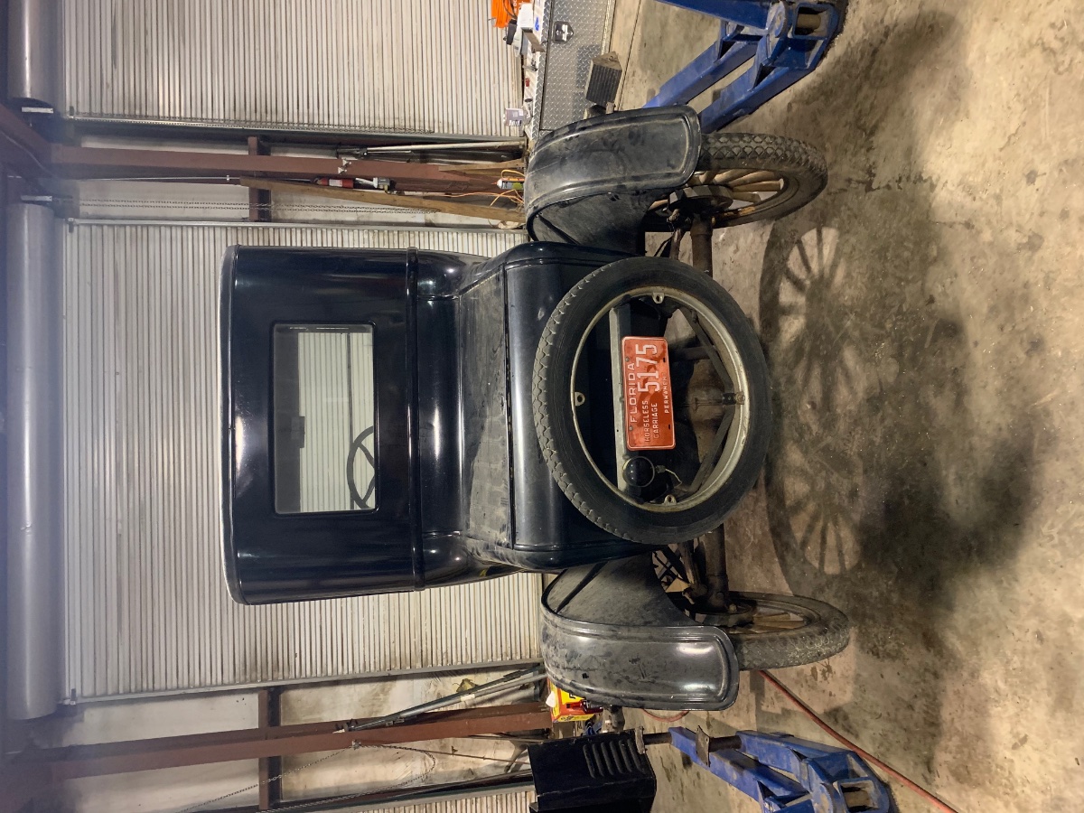

Here’s a couple pictures of the Coupe. Not too bad shape
For sitting over 20 years.
- Posts: 4699
Re: New to model T’s -24 Coupe mixed engine parts
That’s a nice 24 and better than fair condition! It’s great that the car wasn’t left outside behind a barn. They wind up that way sometimes and the weather just ruins them after many years. Not this one though. I’ll bet the wood is still in overall good shape.

Yea, the wood seems to be in good shape, I saw some
Powder post Beetle dust on the running boards when I bought it, but no rot anywhere. Interior is good, but is starting to
Rot in a few places.
