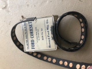

Rich Bingham
- Posts: 1942
- First Name: Rich
- Last Name: Bingham
- Location: Blackfoot, Idaho
Post
by Rich Bingham » Thu Apr 30, 2020 5:58 pm
Here you go Les ! NOS
I would have used them but they smell funky and I think have damp rot. There were several brands marketed with cork inserts “back in the day”.

Les Schubert
- Posts: 1364
- First Name: Les
- Last Name: Schubert
- Location: Calgary
Post
by Les Schubert » Thu Apr 30, 2020 6:53 pm
Thank you Rich for the posting. I was sure I had seen a picture of them!
Joe Bell
- Posts: 1205
- First Name: Joe
- Last Name: Bell
- Location: Tiffin Ohio
Post
by Joe Bell » Thu Apr 30, 2020 8:15 pm
Rich, Les, I have pulled many down with the cork in them, always wondered how the held up? What ever was between the cork crumbled but the cork was still good.

Rich Bingham
- Posts: 1942
- First Name: Rich
Post
by Rich Bingham » Fri May 01, 2020 1:01 pm
Like Joe, I’ve found old cork insert linings in my parts stash. They didn’t look very much worn at all.
