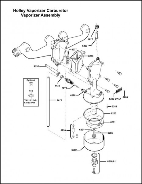

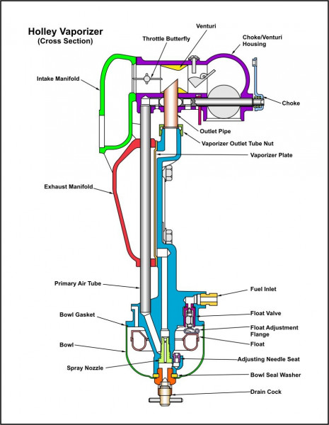

Post by perry kete » Mon Oct 19, 2020 1:29 pm

Post by BLB27 » Mon Oct 19, 2020 1:57 pm
I don't see a piece listed as "fuel needle".
Posts: 1686
Last Name: Seth
Location: Jefferson Ohio
Re: Help with Vaporizer Carb Disassembly
Post by perry kete » Mon Oct 19, 2020 3:38 pm
I believe it's part number 6279 That threads into Number 6278 in the upper drawing .
