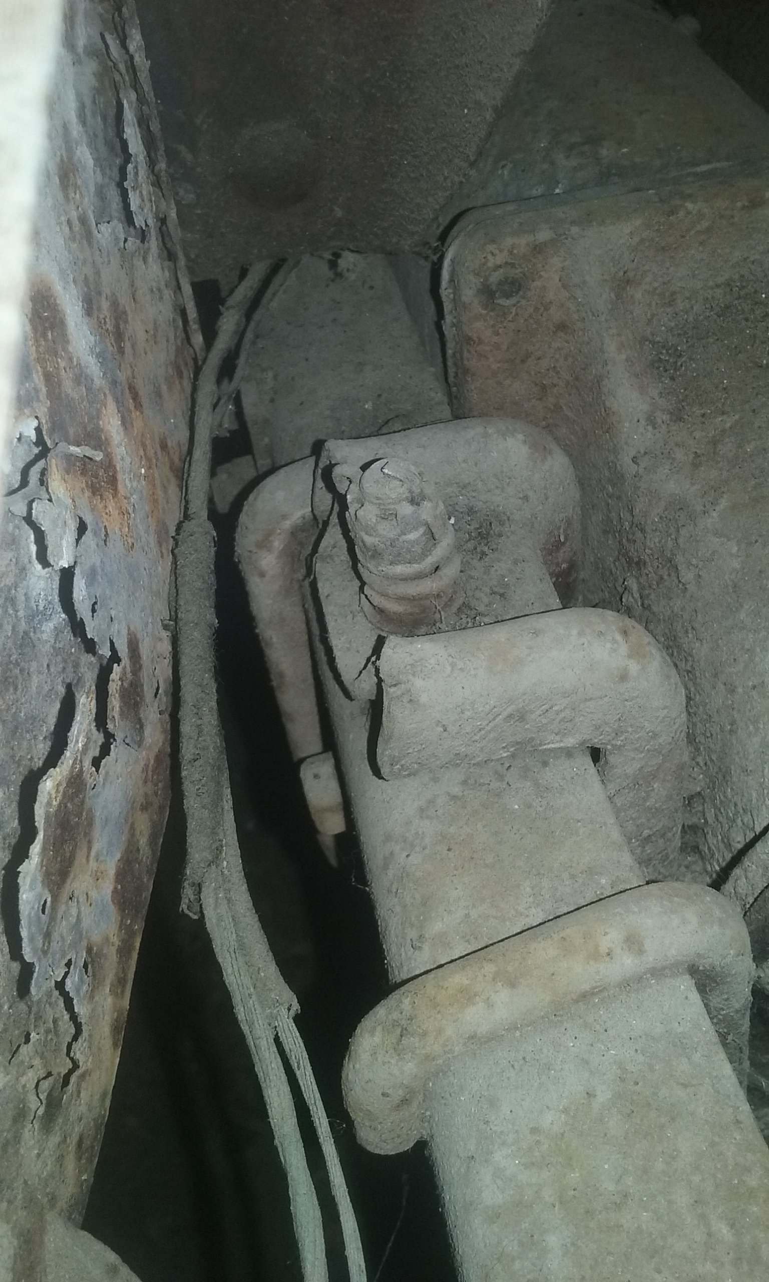

I checked my unrestored 1924 TT and the engine pan ears are mounted to the top of the frame with a wood block and side bolt like the car, but the top bolt has a spring, castle nut, and cotter pin, similar to the radiator mounting.

Post by civinwt » Thu Dec 10, 2020 2:26 pm
