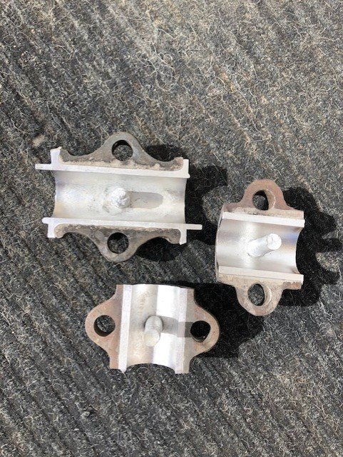

I put my 24 on my lift today and changed/replaced the front spring shackles and bushings. Found the right perch was easy to turn and tightened the nut at the wishbone close to half a turn !
Also had a lot of movement at the U-joint ball when applying the handbrake. So I put a shim in it and greased it good.
Replaced a couple oil caps and lubed everything.
The lift made easy work for most and helpful with alignment of the shackles. I found 2 nice, what appeared to be NOS shackles in my stash and bought 2 bushings from Snyder’s along with the shim.
A couple of the bushings just about fell out and a brass hammer put the new ones in nicely.
My front end is almost 100% now, hopefully the wind will die down tomorrow and I can test drive it !! 8-)

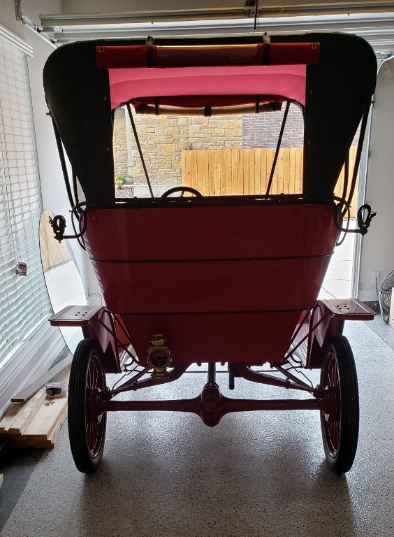

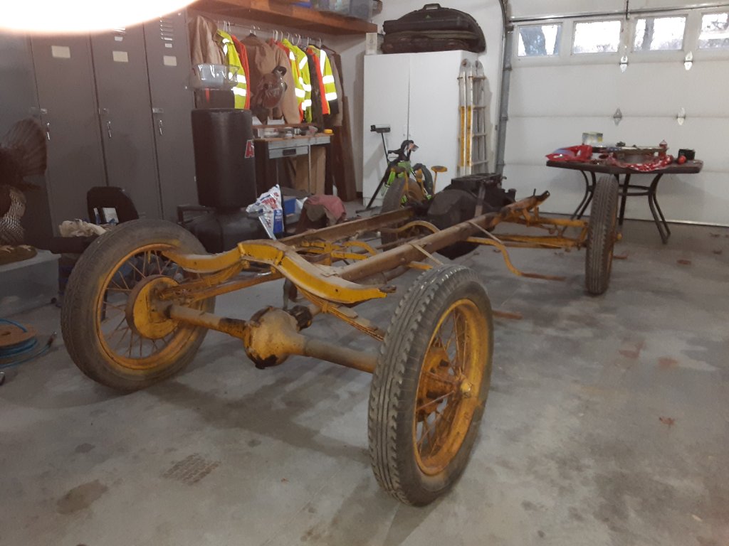

The LAST piece of my early Canadian '13 is now corrected out. FINALLY!!! The correct all brass Victor carbide generator. My car is basically a 1912 chassis with a 1913 body. John Brown model 19 lights and model 105 tail light, E&J cowl lights, and the Victor carbide generator. My 1912 running board has a very specific "3 hole" pattern with 6 5/16" distance between centers, that only ONE generator seemingly matches to. Three years of research including lengthy discussions with a couple of really hard core Ford experts, and leg work finally led me to which generator had this mounting hole pattern, and that is the very elusive Victor all brass model used from 1909-1912. One of the hardest, if not THE hardest one to find. The "Ford Times" of April 1913 shows a photo of a T with this generator on it. That's a really late date to sport last year's brass! My car was built in Sept. or Oct. 1912, and sold new in Nov. 1912 in Tavistock, Ontario, Canada. This car hasn’t travelled very far from where it was sold new, less than 20 miles from where we live. The only thing that is actually the 1913 model year is the radiator, windshield, and the body. Everything else is all 1912. “B” series engine, number 872. I have all the documentation of the car since new. My grandfather bought it off of the original owner in 1956. B&W photo is from 1929: original owner's daughter's wedding. Lot's of original details! Note the wrong later engine pan, and the lack of the locating dimple castings on the front top iron which I've corrected. This picture proves that at least in 1929, this car had a mis-match of lights. I'm pretty sure it's been like this all it's life. Why would anyone replace two cowl lights with two other all brass ones when the car was only 16 years old. No one would have cared then what brand or they looked like. Since it's a pre assembly line car, I think Ford used up all their old parts and my car was one of those.
13 T in 1929 wedding of Louise Sippel and Farrell B Kinnaman in Cleveland Ohio.jpg

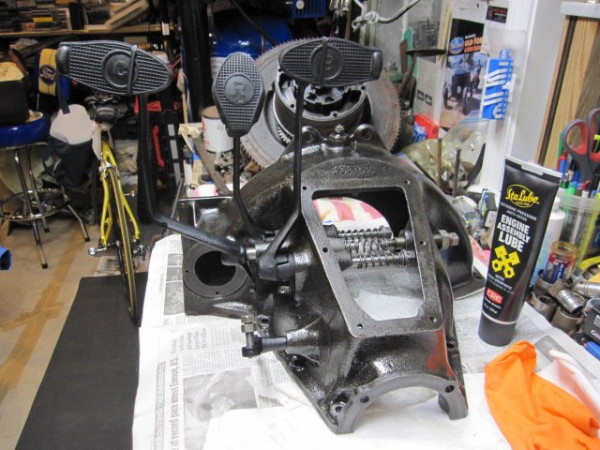

Re-babbitted main bearing caps and ball caps ... am re-stocking items for the summer ... will also post several photos of the ball cap boring process ... have 2 T blocks to re-babbitt the mains and fit Scat crankshafts ... March was a busy month with Chickasha ... now i have to get busy and build inventory back ... the problem with retirement is "you never get a day off" ... anyway , i am still always an optimist ...Gene French

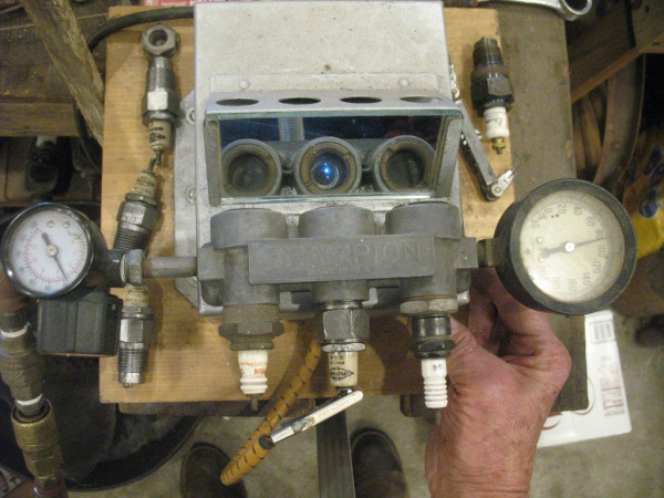

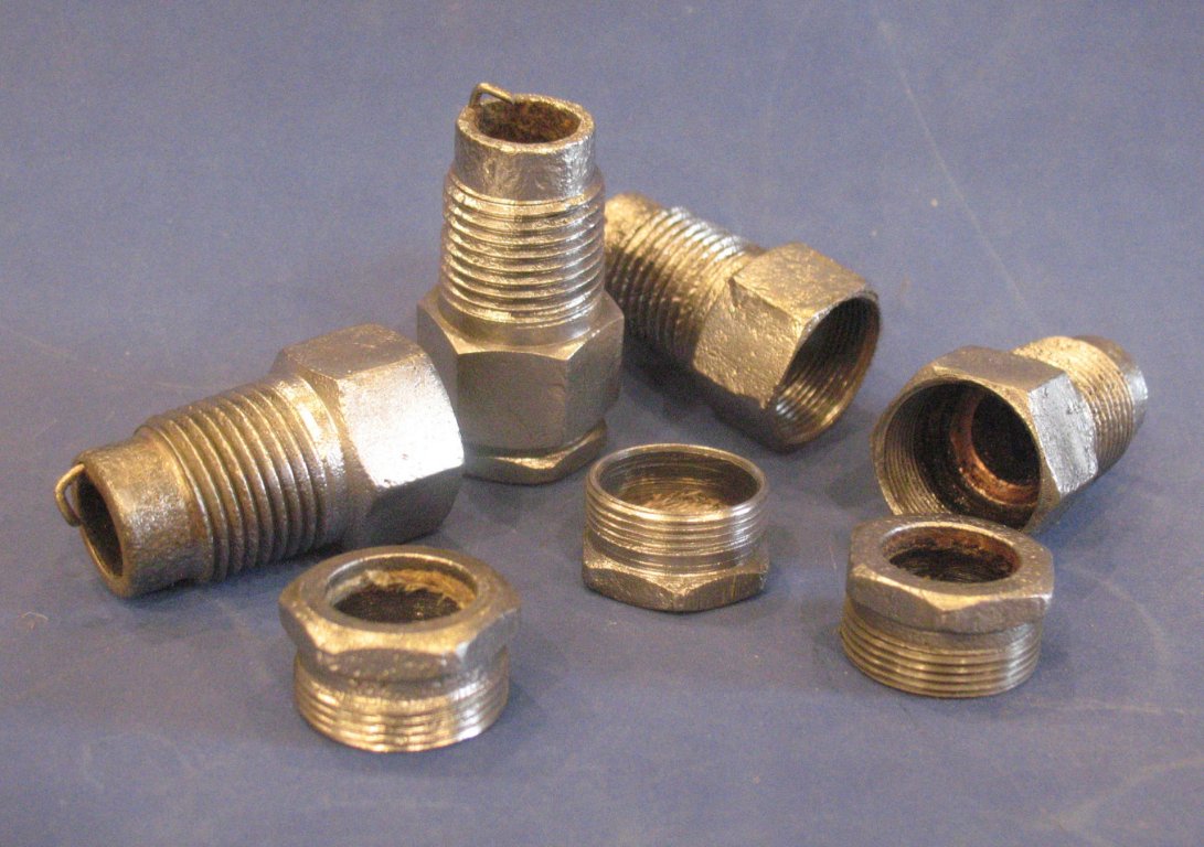

This is indirectly for my 1915 runabout or my 1923 touring. I haven't decided which. A friend sent me enough Edison 14 spark plugs to make a full set. I was going to send him some Splitdorf plugs in trade.
But they were not in great shape, and in the tester they sparked weakly or not at all. So refurbishing was the order of the day.
I derusted and wire brushed the bases and collars inside and out, cleaned rust and carbon off the insulators, reassembled the plugs, and gapped them.
I tested them under compression of 80 psi, much more than they will get in a Model T.
This time they tested OK, with a nice, strong blue spark.
The next step was treating the metal with gun bluing.

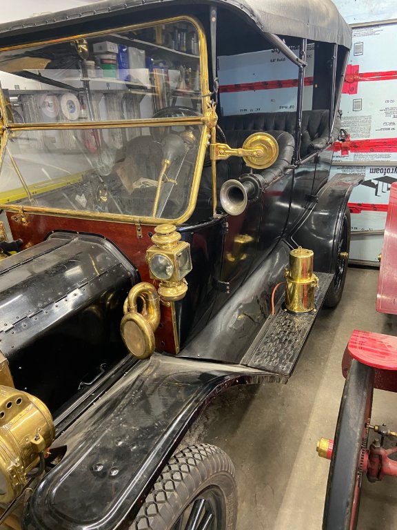

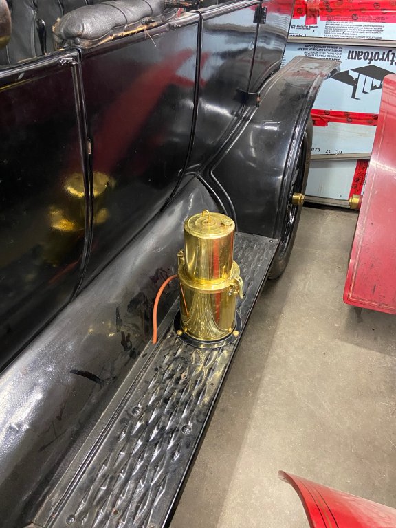

I’ve had this carbide generator for a while but kept telling myself i was going to paint it before putting it on. Out of sight out of mind, so I went ahead and put it on. Now that I have to look at it I’ll probably take it off and paint it and get my gas line ran. It will be nice to have it there when explaining to people how the lights work instead of describing something that’s fairly unbelievable to non-old car people. “Rocks that burn, just add water”

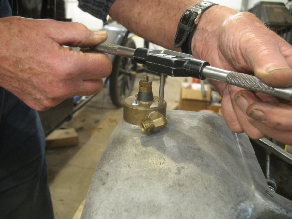

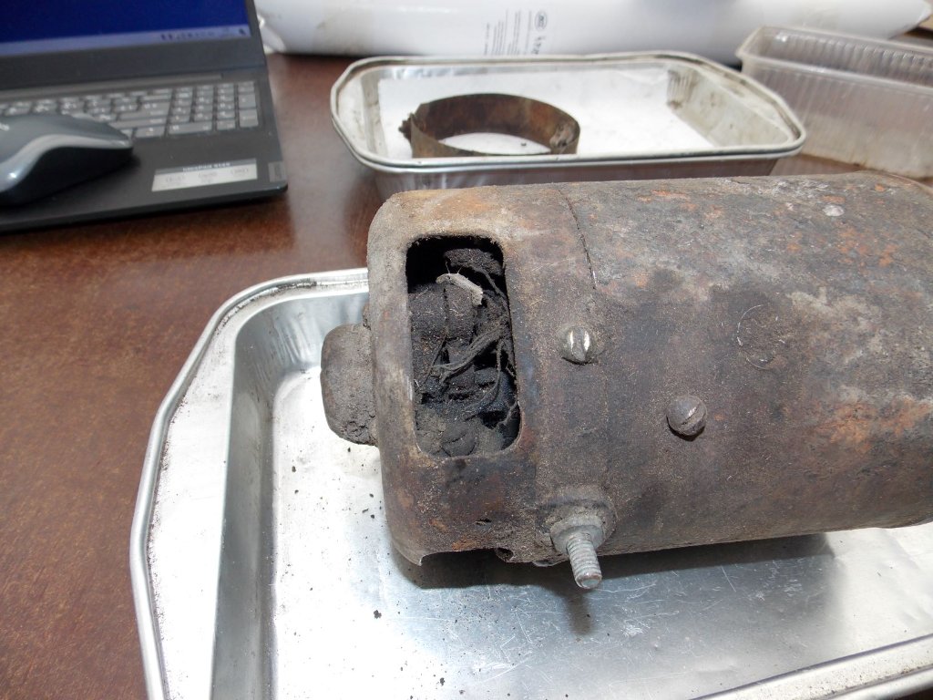

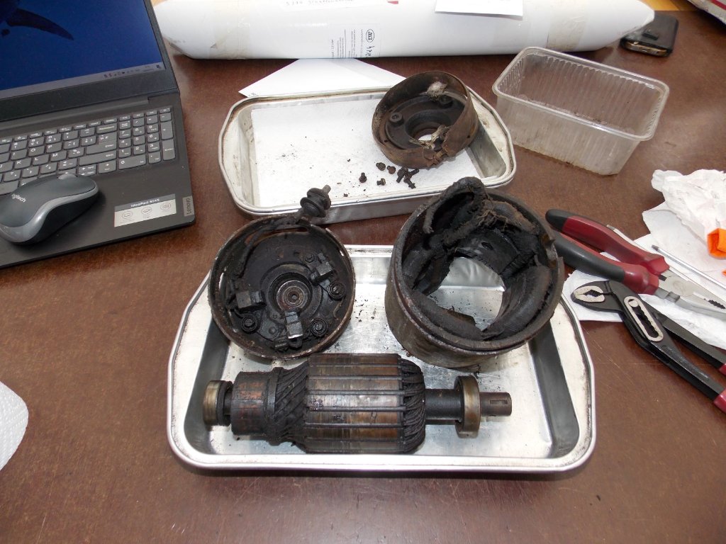

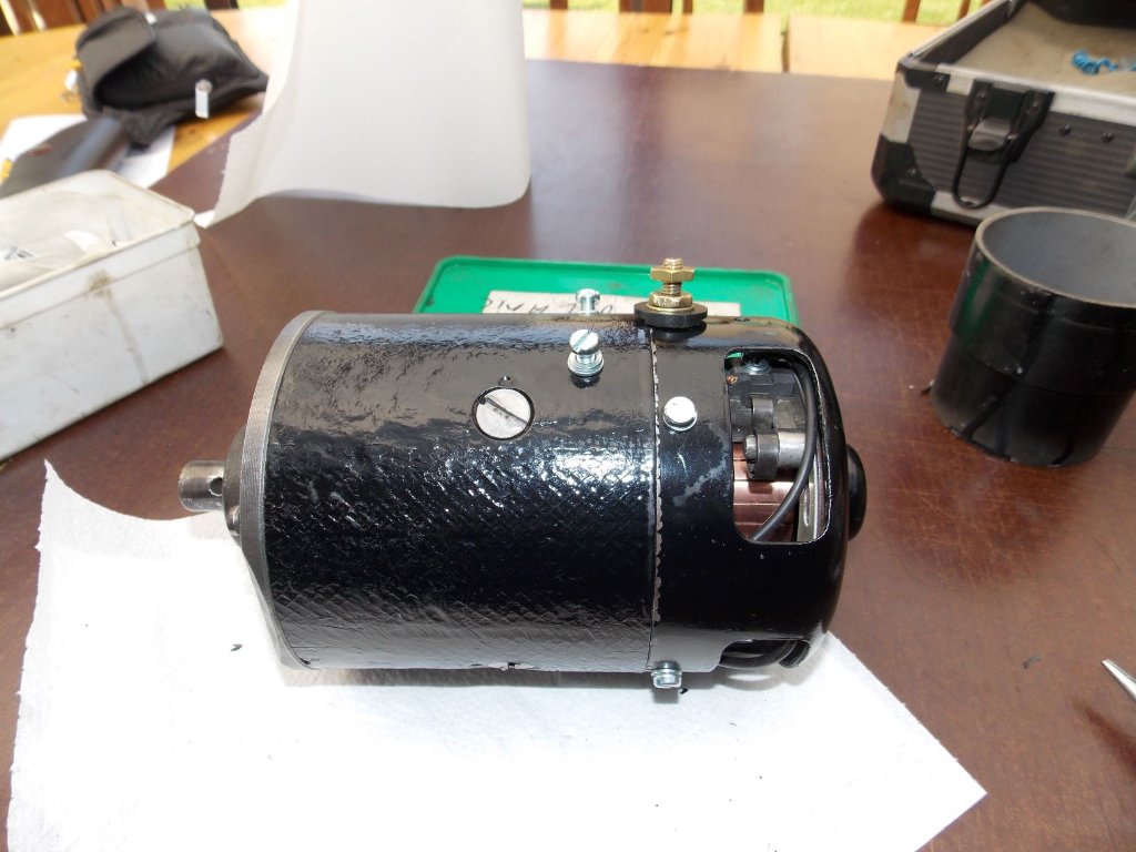

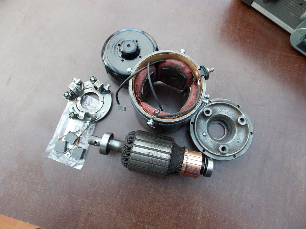

Checking the new starter for a new Bendix assembly. The old Starter bearing was shot causing considerable wear on the ring gear. New ring gearalso being installed during complete engine rebuild.
Runout.jpg[/attachment]

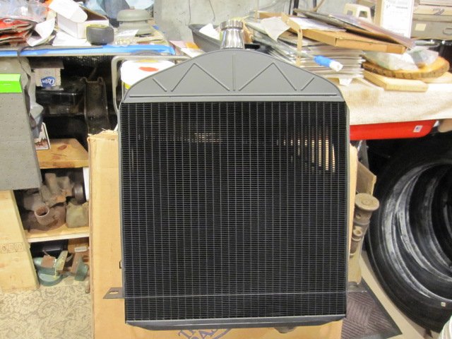

I've also been very busy re-stocking items for the summer... Not retired yet so have to get this done as time permits.

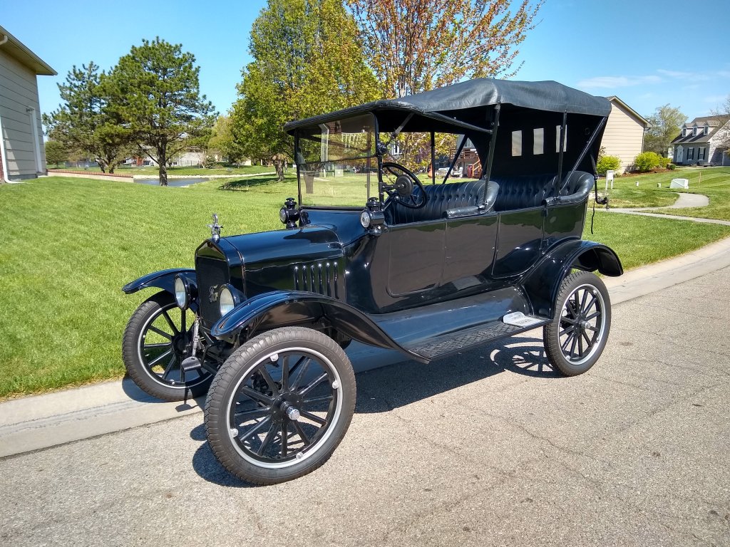

My wife and I took the 15 runabout on a longer drive (for us) on a beautiful spring Kansas afternoon. Had to get gas first, which always takes longer with a T because people want to talk... With the top and windshield down going about 30 mph, it is always interesting how much more that you can see and smell. The smells varied from blooming lilacs to the smell of french fries from the golden arches.

NealW wrote:
Sun Apr 11, 2021 5:37 pm
Neil...you're a man after my own heart! I have always said to the point of being annoying (easily done for me!) telling everyone there's nothing, just nothing, like a good afternoon drive with the TOP DOWN!! After all, isn't that why the open car was really invented?? As I recall, initially the top was even an option? I love the blue sky, the birds, eagles (well, they're birds too), trees, you name it. I will admit, sometimes due to heat and strong July/August sun, it must go up. But now I have the torpedo, and it's top will be up most of the time with the back curtain rolled UP, for the sake of the wife, ;) :roll: and the touring's top will probly never see the light of day anymore. And it's brand new! But, so is that nice, correct boot also! :lol: Just my thoughts.

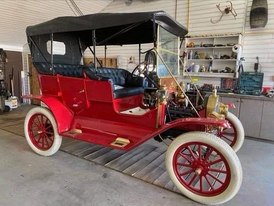

Post by Quickm007 » Wed Apr 14, 2021 11:29 am
After 12 years of restoration on my 1911 Touring , I finished the top installation. I could say project completed !!!

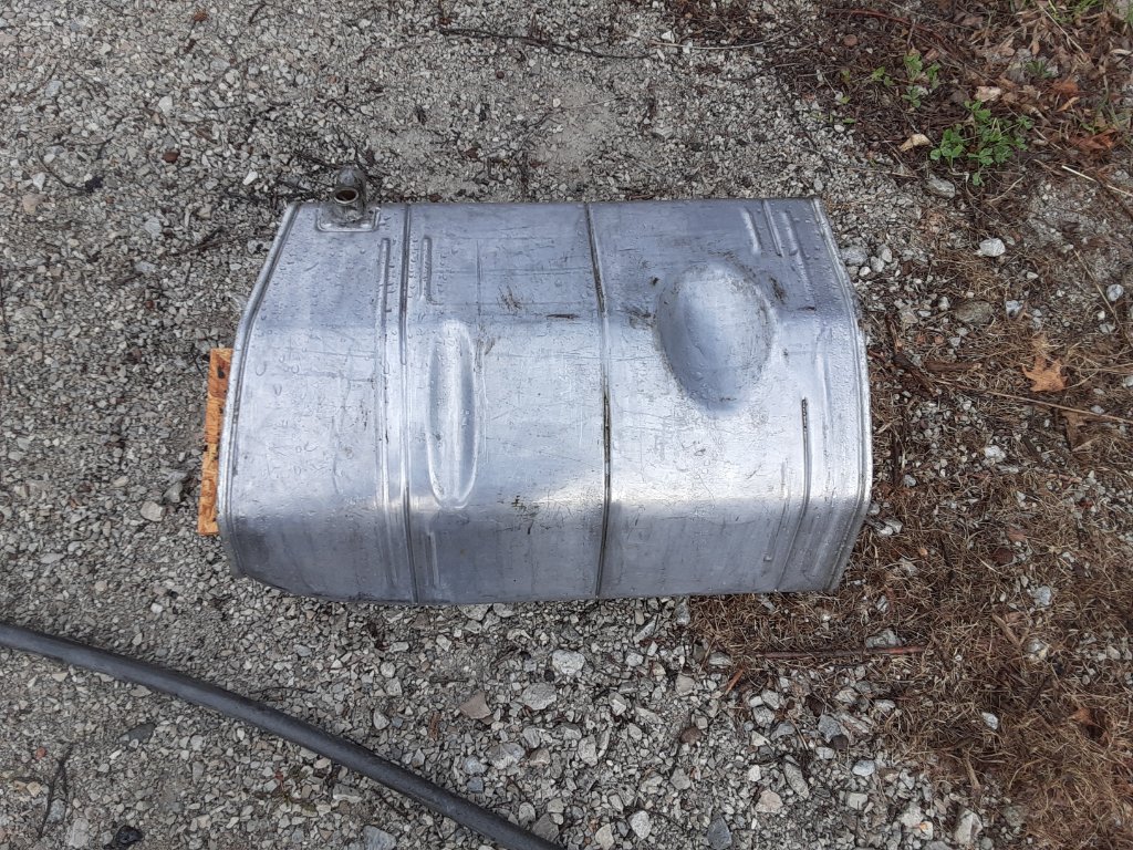

Took the 1927 coupe frame in for sandblasting. Will send pics when is done. A question: Should I keep the front motor saddle from being blasted. I assume that would not be problem. Any comments?
Posts: 5575
Last Name: Gregush
Location: Portland Or
Re: What have you done with your T Model in April ?
Post by Mark Gregush » Sat Apr 17, 2021 1:27 am
BLB27 wrote:
Fri Apr 16, 2021 9:44 pm
They do come off. Need to check for crack under it anyway and so the area under it can be sand blasted too.

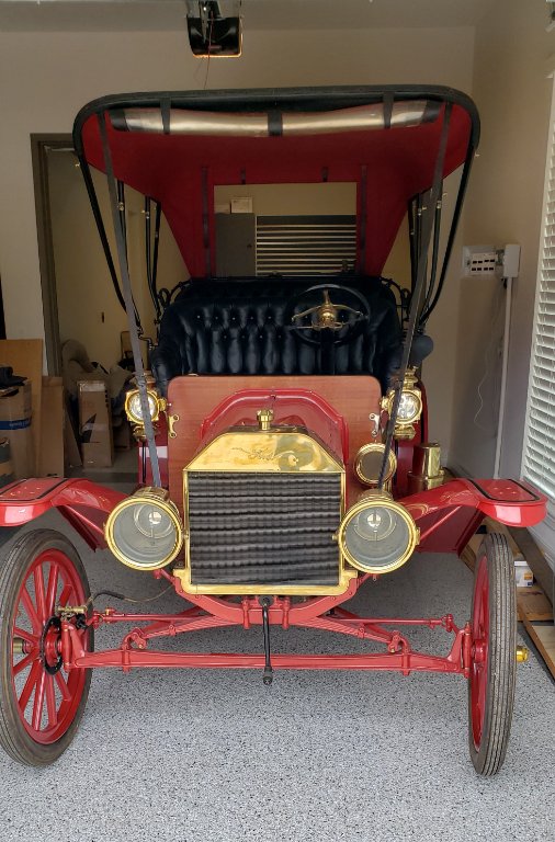

Post by SurveyKing » Sat Apr 17, 2021 7:28 pm

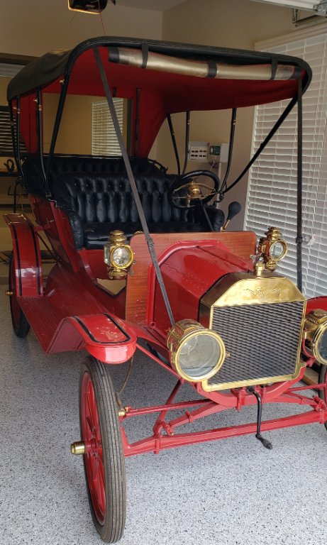

Moved my 1909 Touring to our new home and Garage. We have been moving for the past 3 months little by little, and saved the best for last.
[/size][/b]Now to get to work on it!

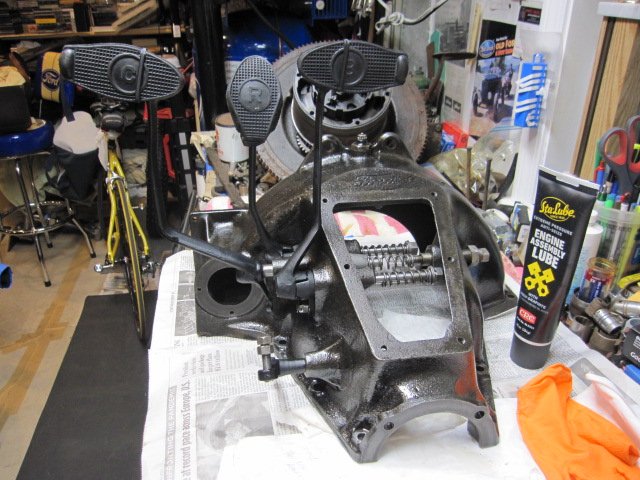

Got the Hogshead back together, hope to get this back on and adjust the bands on monday. We got that Patriots day thing off so will make do with some T time.

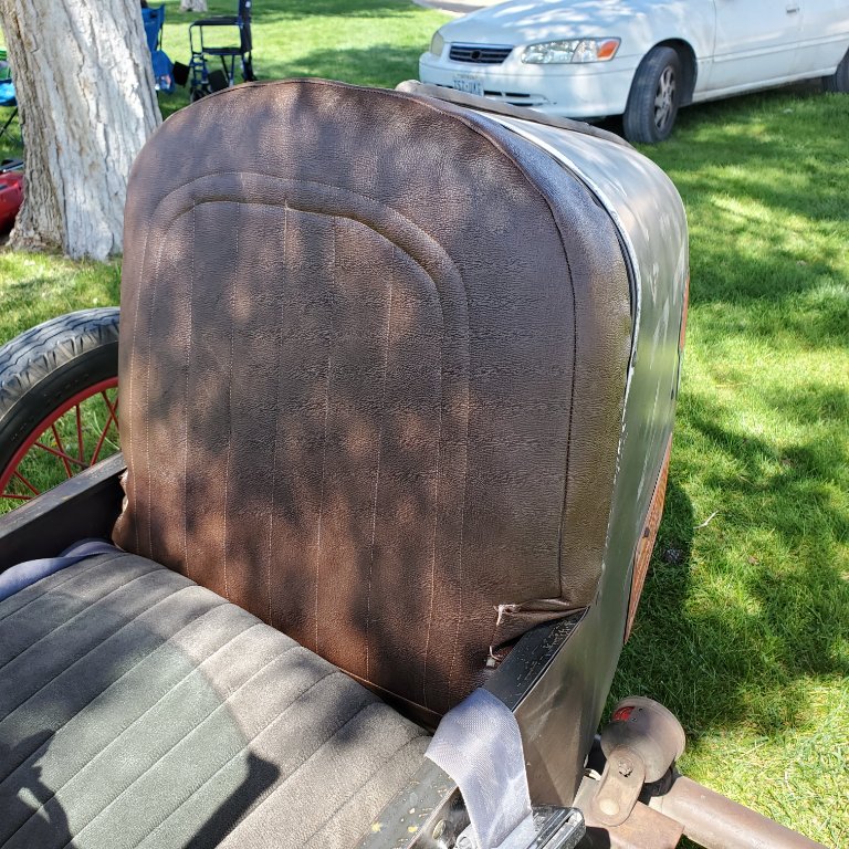

Tried my hand at upholstery. Seat back done.

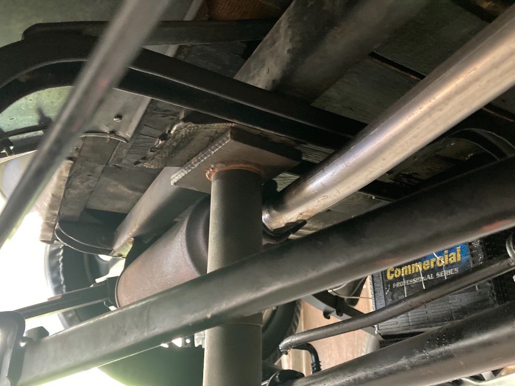

After my pinion gear broke I built up another rear axle with floating hubs and got it installed in the Tudor.

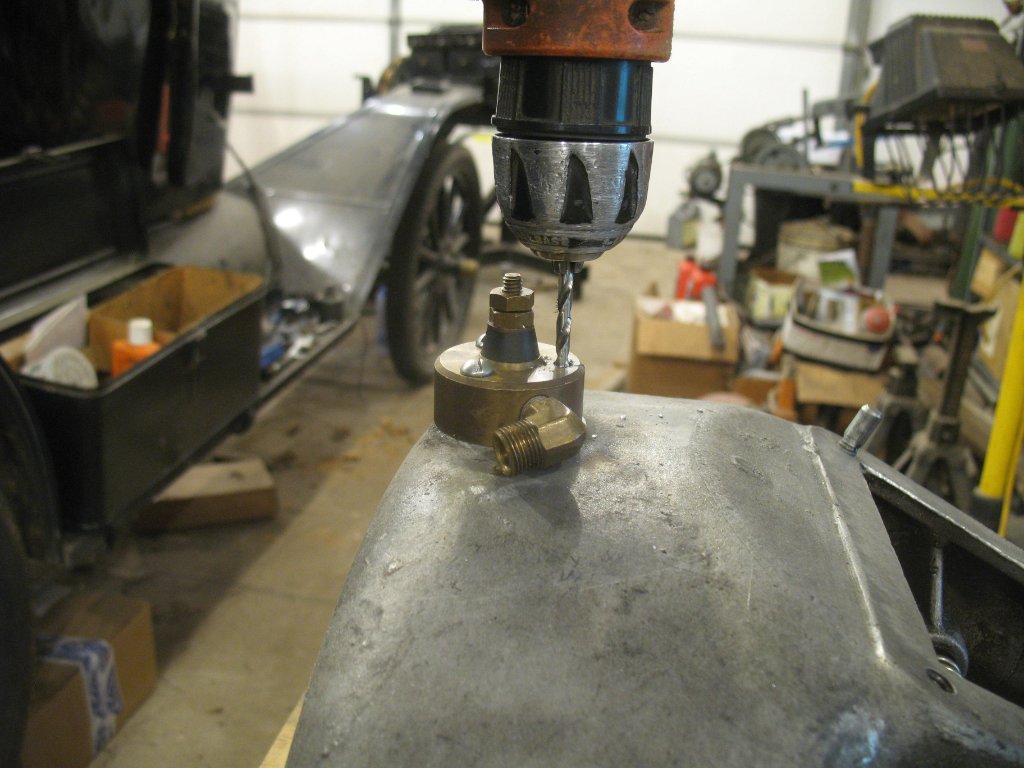

Post by Steve Jelf » Thu Apr 29, 2021 10:44 am
Spent the rainy Wednesday in the shop with my hogshead.

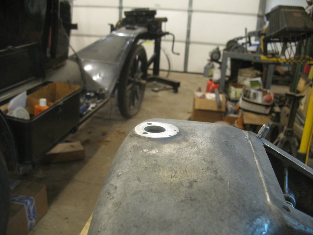

One of the mag post screw holes was stripped, so Monday I took the hogshead to a welding shop and had the hole filled.
I've never done any aluminum welding, and I didn't want learn on this and risk screwing it up, so it was well worth the $5 to have it done.
Grind down the blob.
File it flat.
Ready for precision machine work.
Posts: 7413
Post by Steve Jelf » Thu Apr 29, 2021 10:53 am
Drill the new hole.
Tap it.
The 10-32 screw fits. Sure glad I took that machine shop class. :D
Home made spring compressor.
.041 safety wire.
Posts: 7413
Post by Steve Jelf » Thu Apr 29, 2021 10:56 am
Ready. By quitting time I had the hogshead installed.

Posts: 7413
Post by Steve Jelf » Thu Apr 29, 2021 2:49 pm
I hope you safety-wired those transmission bolts before installing the hogshead.
DRAT!!!
No, of course not. There always has to be a senior moment to make me do a job over. Why in the heck did I take wire off in the first place? Beats me. Well anyway, thanks for mentioning it. Better to find out now than have to pull the engine out of the car again. :(
Posts: 5301
First Name: john
Last Name: karvaly
Location: orange, ca
Post by speedytinc » Thu Apr 29, 2021 3:28 pm
No big deal. Wire it thru the inspection cover.
