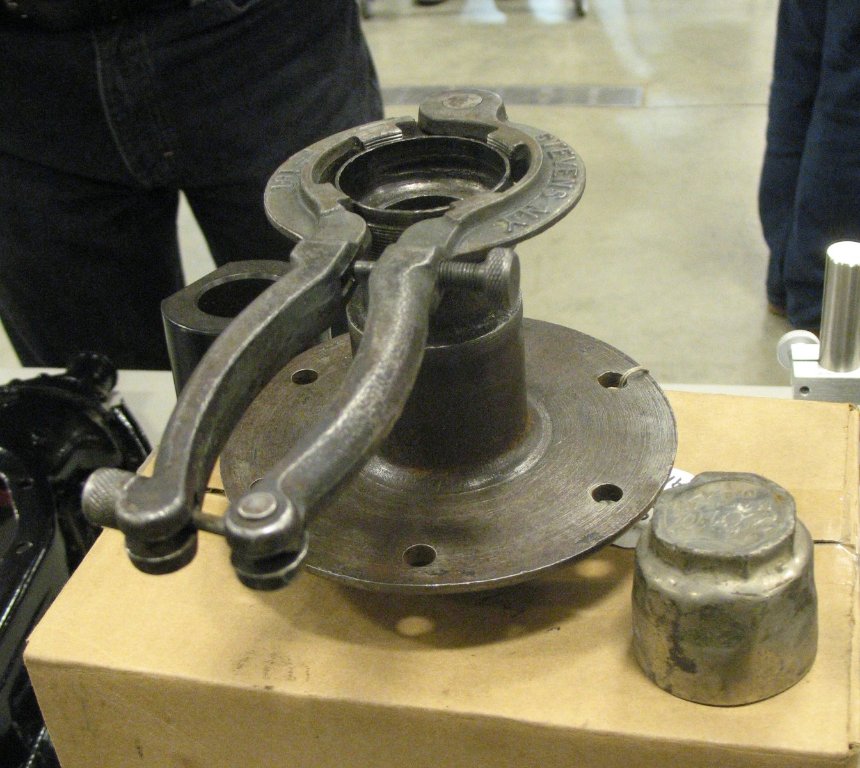

Original 'pliers' type thread cutters for those hubcaps are very desirable, and generally expensive (I have seen a few sell at around $500!).

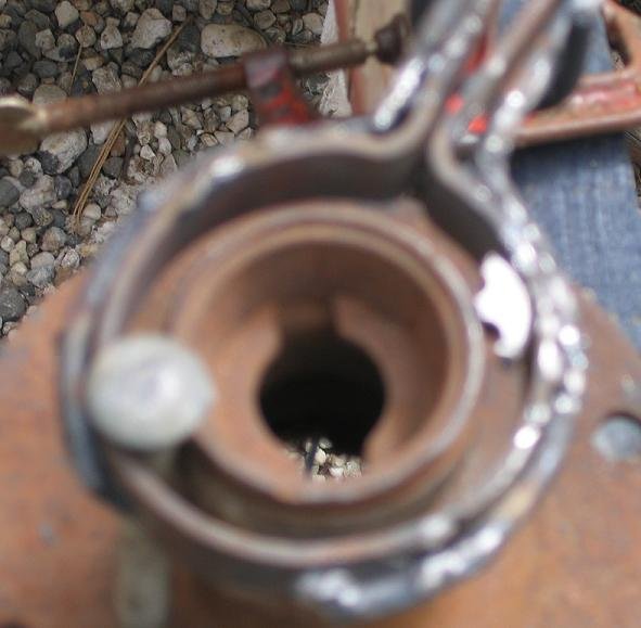

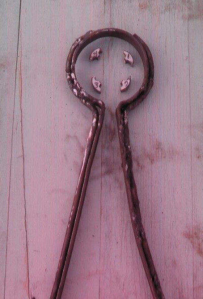

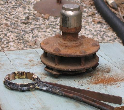

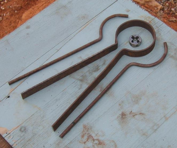

Someone was making thread chasers for model T hubs, and they were sold through the usual model T parts suppliers. Reasonably priced, but not cheap. I often don't like thread chasers myself. They are ridged, and must usually be put on from where the threads are most damaged. Which makes them difficult to use.

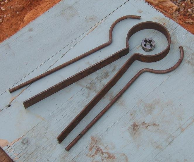

And, since I am almost always on a very tight budget, some years back, I made my own.
I used some steel strap iron, about 3/4 inch wide. It is strong enough to hold the light pressure, yet flexible enough to open and then clamp down again over the old threads. I welded some steel rod along the outside of the handle and part way around the hub area, to make the handle more ridged. The size for the whole thing had to be figured out fairly precisely, and might vary due to specific donor thread cutter size.
I do not recall what I used for the cutters. It was a common bolt size, something under a half inch (may have been a 3/8?), with a tread count/pitch the same as the model T hubcap. I don't recall what that was either, but if you have a thread gauge, it should be easy to determine. The thread die I used had four 'chip' holes between four sets of cutters, common hardware store thread die. I cut/cleaved though the chip holes. Then, using a good thread hub, I CAREFULLY (the tricky part!!!) placed the four cutters (the order should be kept as per original!) around the hub's threads, using the hub's threads to hold them in alignment. With the carefully sized handle held clamped around the cutters holding everything in place (I used electrical tape out on the handle to hold it clamped), I brazed each of the cutters inside the handle clamp circle.
The heat from brazing will take some of the hardness out of the cutters. However, I kept the heat as low as brazing required, and the loss of hardness has not seemed to cause any problems.
At the time, I had bought a car that had a damaged front hub. I was in a hurry, and did not make a neat job of it. It may be a bit rough and crude looking. But I have since cleaned up quite a few hubs with it. It hangs proudly on a nail in my workshop where I can find it on a minutes notice.

Re: Where to find a die for the wood wheel hub cap
I believe Wayne's homemade version of the Stevens tool is the best answer, both inexpensive and effective. Dies and chasers go on from the outside, and it's usually the outside threads that are boogered up worst. The pitch on hub threads is 24, and I intend to cut up a 3/8-24 die and make my own version of the Stevens tool like Wayne did.

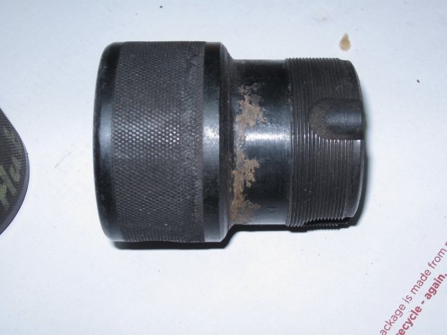

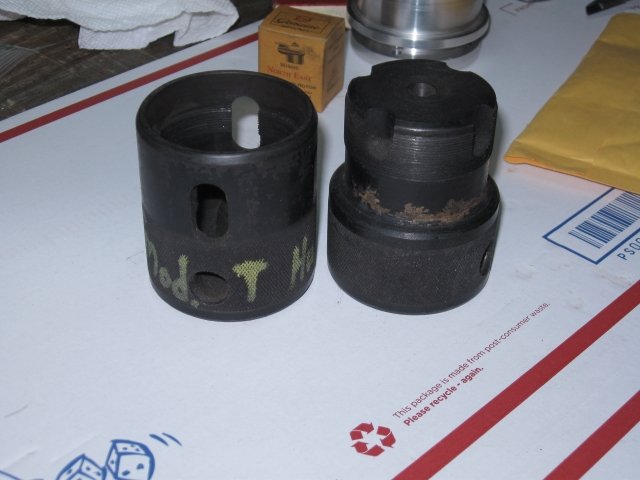

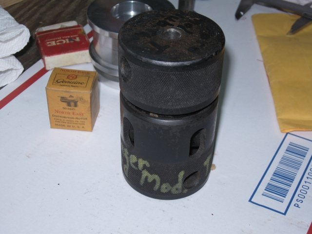

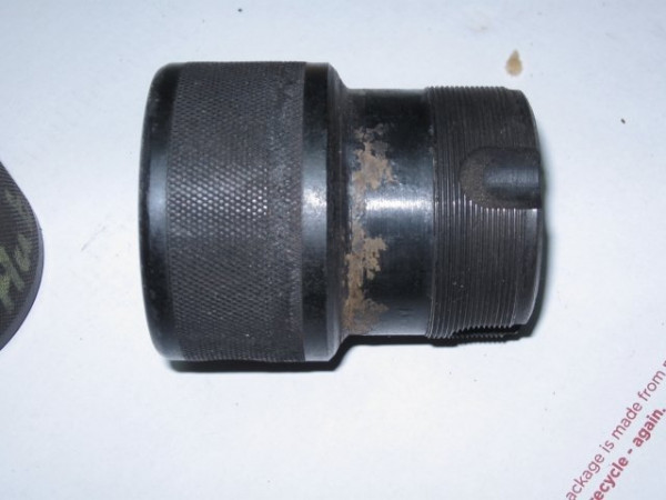

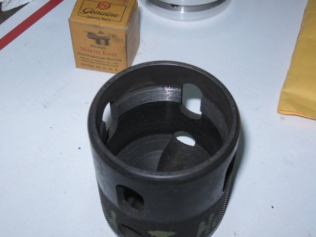

I know this does not help your search, but I found this one at at auction, last March. I have never seen another one like it.
Definitely not old or used very much when I got it, but very well made and works tremendously well.

Pep that is a nifty set you've got there !
