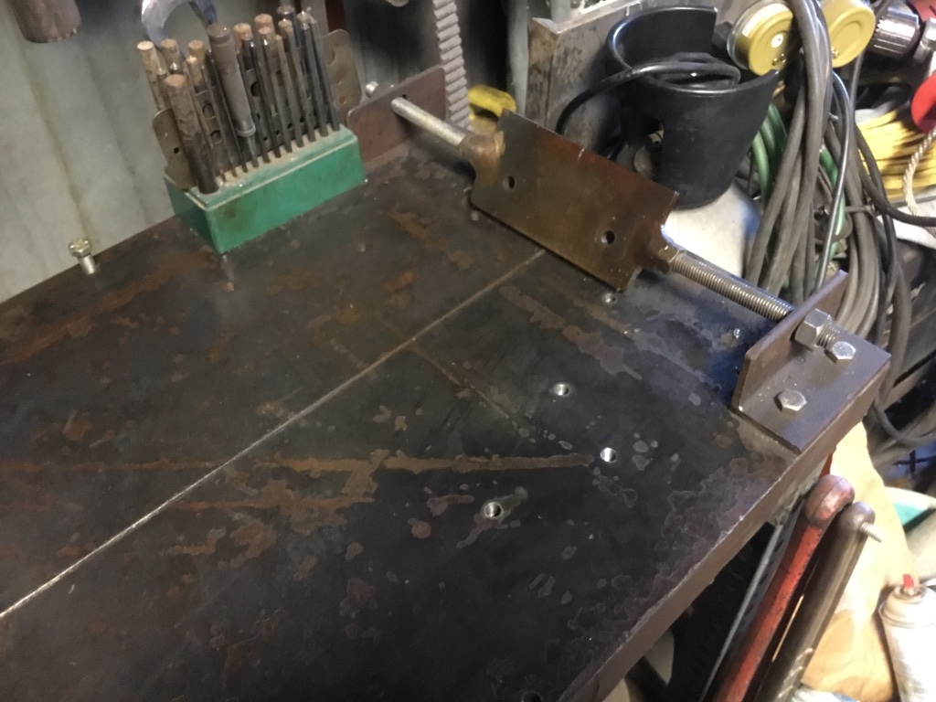

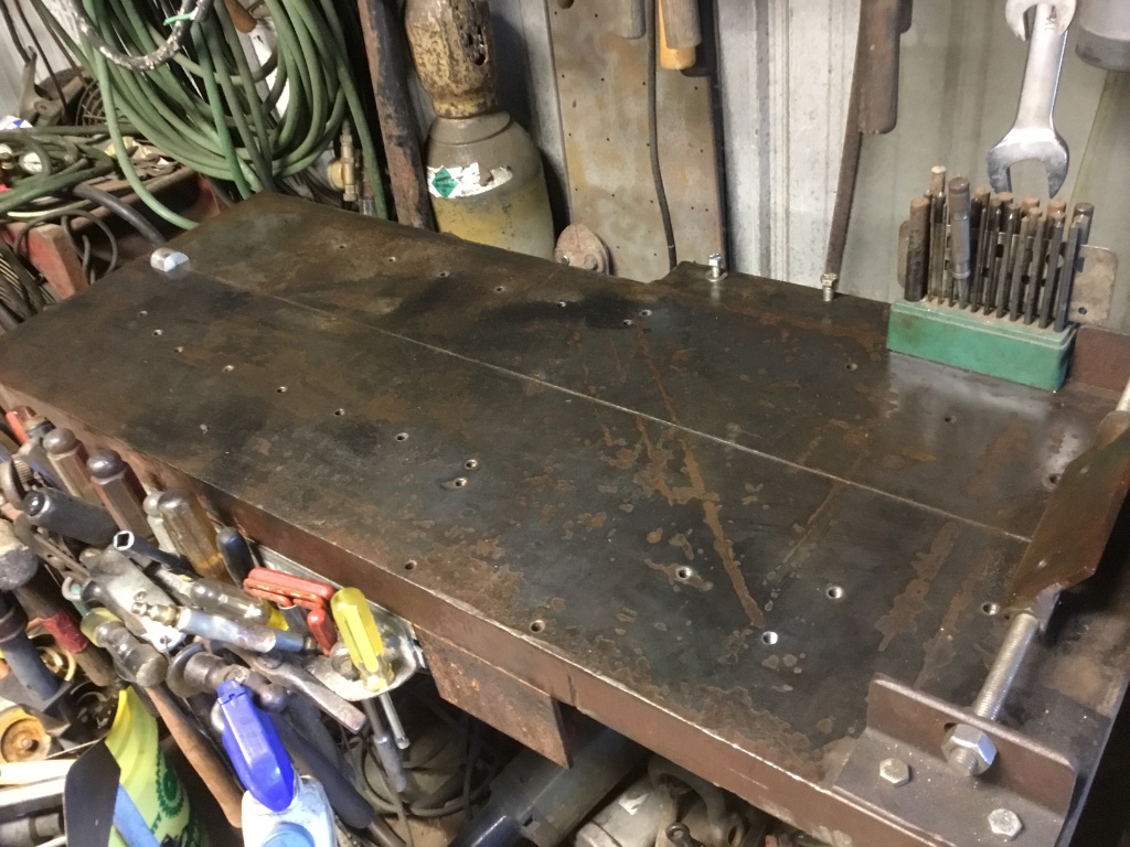

Re: Pan Jig Layout Dimensions
. The centering jig at the back is upside down for the picture but, this makes it easy to pull the pan into alignment. The plate was cut with a track torch. If I can help 903-824-1949 and no I won’t donate to the police officer fund.
Mr Bob the idea is yours for the taking. It dose make getting the back of the pan correct, simple.

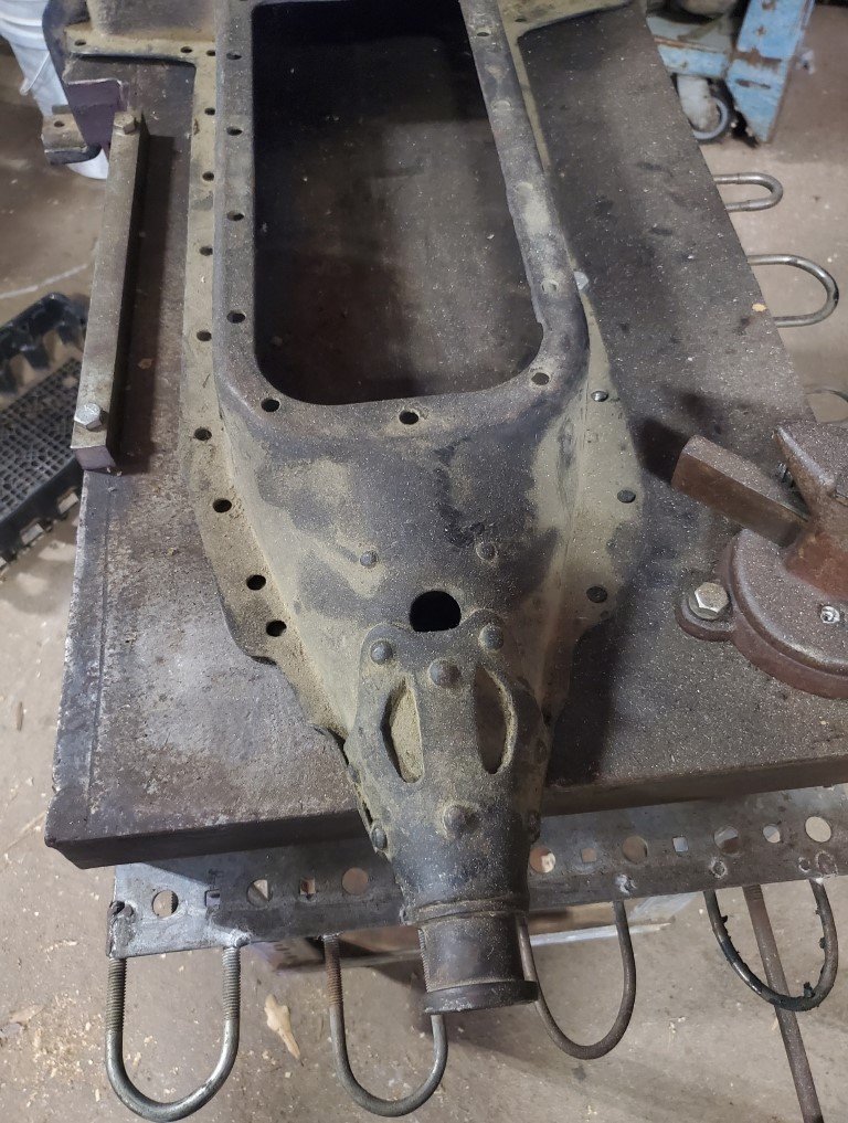

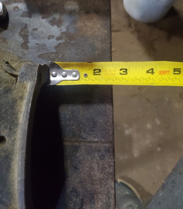

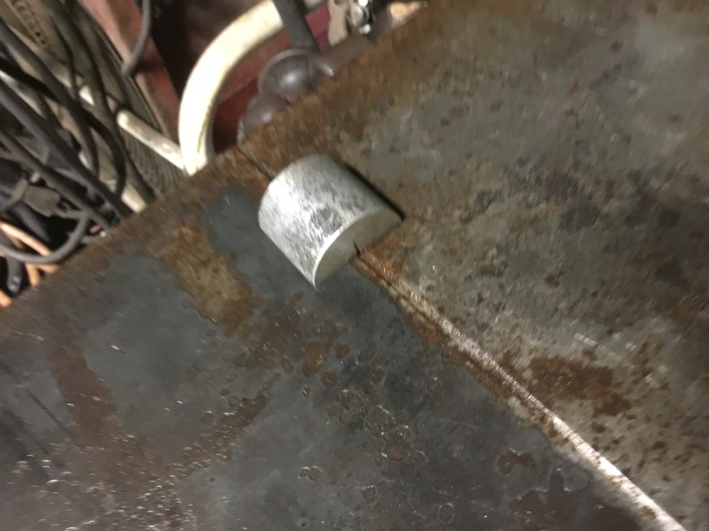

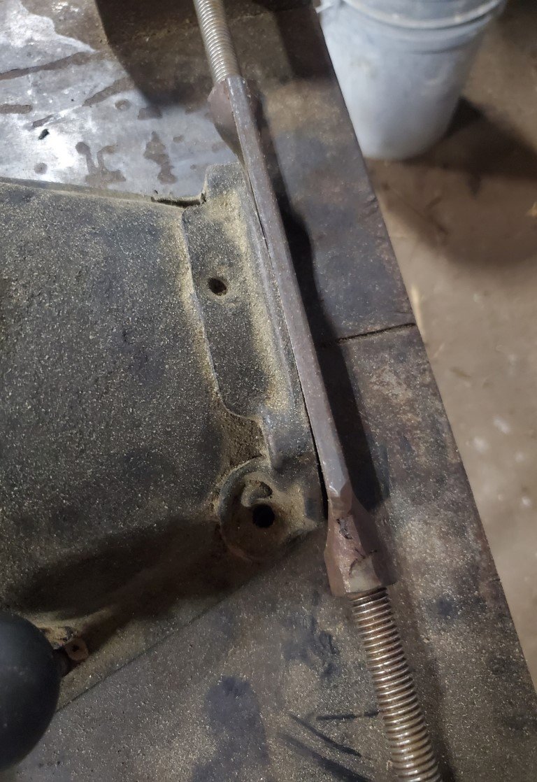

Bryant,
See below some additional photos of the pan alignment table. It's hard to see since the table is dirty, but on the rear adjustment plate (2nd photo)there is a small indexing mark for alignment with the centerline cut into the table. The plate is 42" in length and extends 2 1/4" past the rear of the pan.
