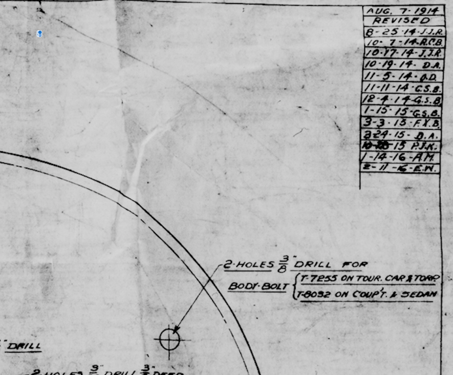

Post by Steve Jelf » Mon May 23, 2022 3:29 pm
Here we go with that firewall again. The drawing shows ⅜" holes for the two bolts and calls for T-7255 body bolts without giving the bolt size. The bolts used when this car was assembled in the seventies are ⁵⁄₁₆". I'm assuming that the ⁵⁄₁₆" bolts are wrong and they should be ⅜" , but I'd better check and be sure. I've found plenty of incorrect parts in this car, and I figure these are most likely two more of the same. I have the drawing for the firewall, but not for the hood former.

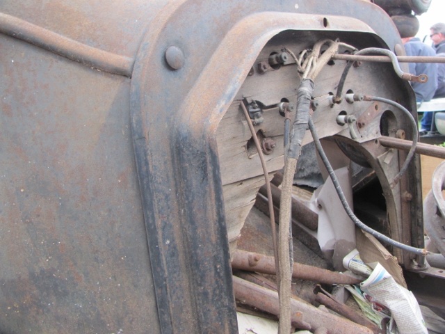

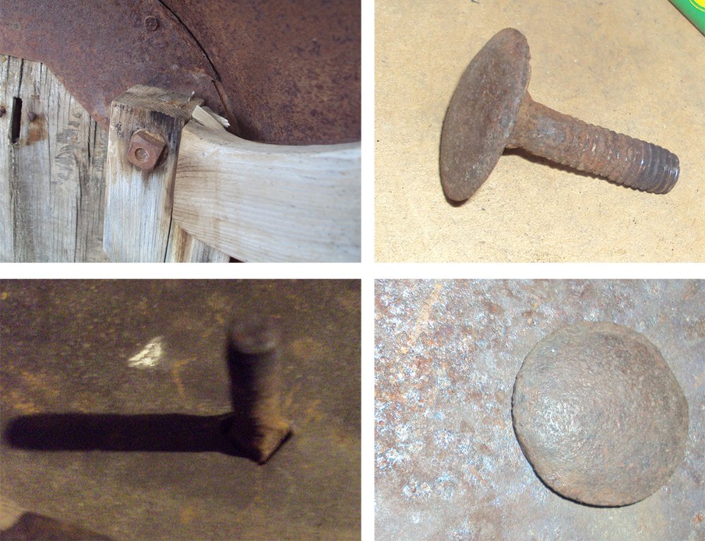

I'm surprised to see a 3/8" hole there. I have always assumed it was a "step" bolt that went there, 5/16".
This is what I believe the bolt is. It is 5/16" by 1 5/16 log. The head is 1 1/16 dia. The square hole in the hood former is 11/16". A 3/8 would be too large for it. The square shoulder on the step bolt is a bit over 5/16" so it would fit there nicely. I have drilled that hole 5/16 match drilled at assembly. 3/8" hole might have been used to give some clearance for easier assembly. Things don't always line up.
I'll see what more I can find.

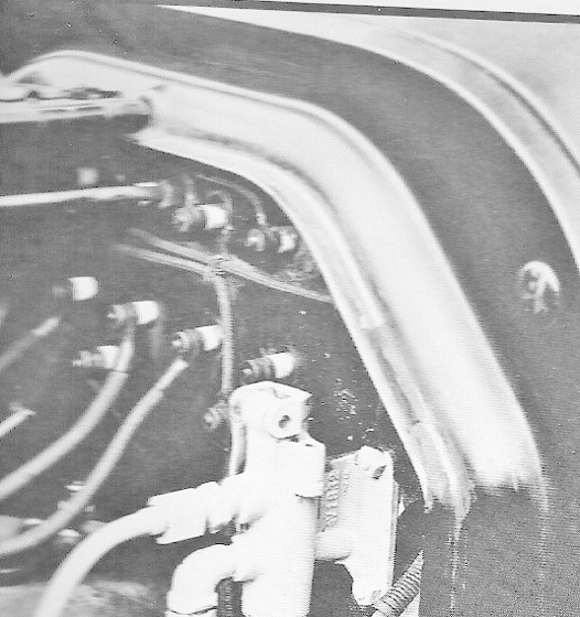

Tried looking up the dimensions of that part, factory T-7255, and the only ref. is 1912 Price list, p/n 3653, that one is 1/4" x 1 1/4" x 20 thrd.
The later books have the p/n 3653B, so there was a design change. Suspect that the bolt is a carriage bolt, with the size head of a carriage bolt that dia. In early days carriage head were nice and large, of course the typical 'step bolt' has more of a flatter head.
Looking at bolt styles, the 5/16”dia. seems suitable to a head shape seen in old photos of original cars for the hood former.

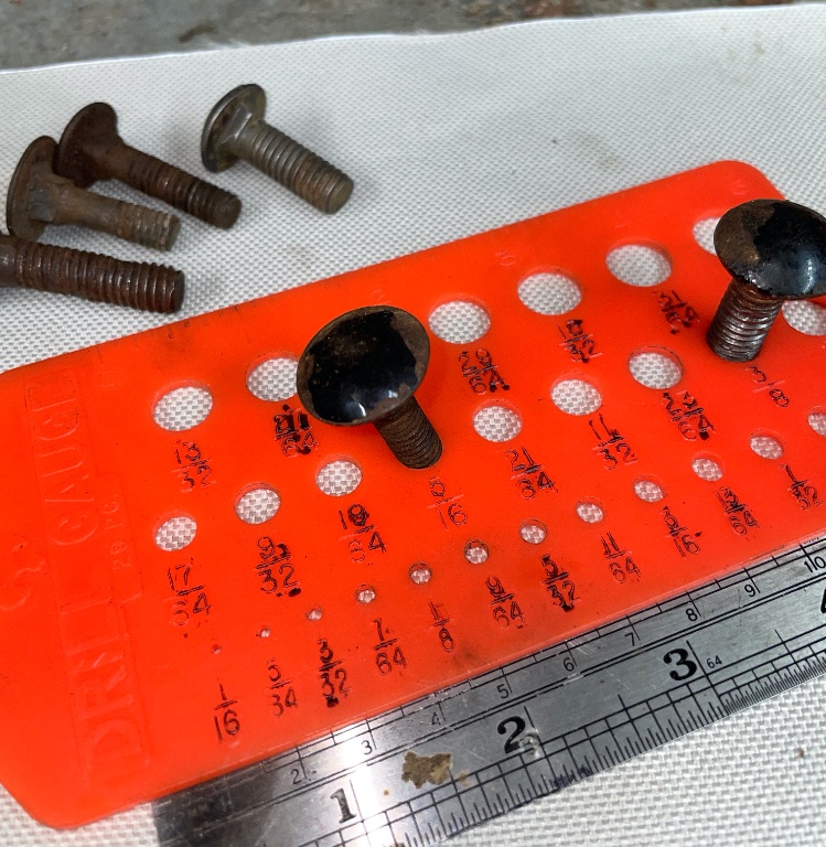

Upon checking the holes in the hood former I find that any ⅜" bolt is too big, so apparently the ⅜" hole is to provide "wiggle room" for ⁵⁄₁₆" bolts, so that's what I'll use at least for now. Maybe later when I'm not facing a deadline I can find some ⁵⁄₁₆" step bolts.

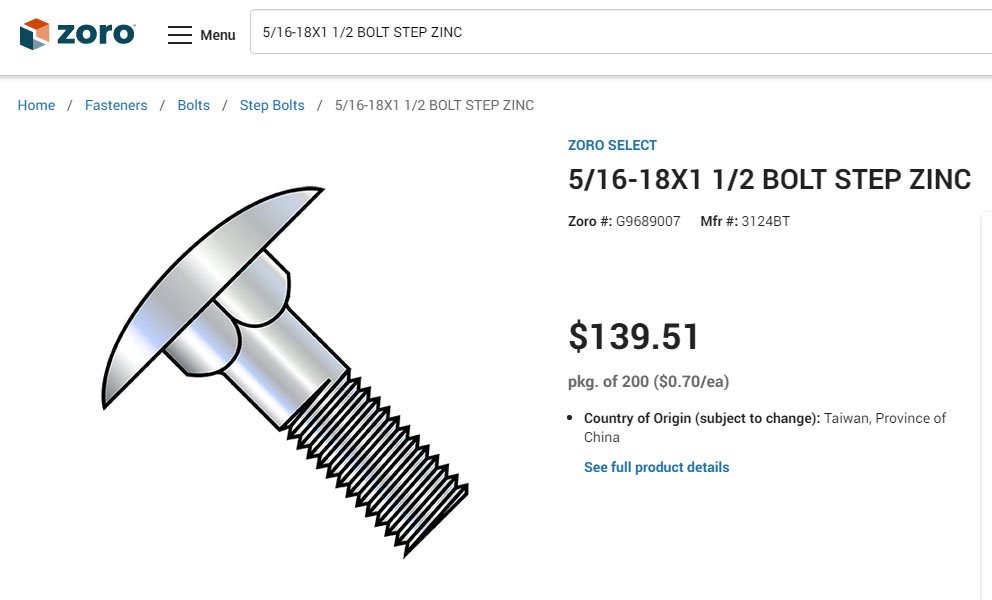

The one good carriage bolt I took out is ⁵⁄₁₆-18 x 2½. Step bolts that size are sold online by the box of 50 for over $35. I'll go with carriage bolts for now and look for the step bolts whenever I'm around a real hardware store.

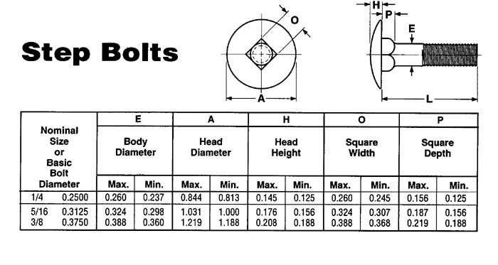

Art Bell posted this chart back in 2010. The thread also has carriage and elevator bolt charts.
http://www.mtfca.com/discus/messages/11 ... 1288281081
The step bolt dimensions are very close to the rusty one I showed earlier.

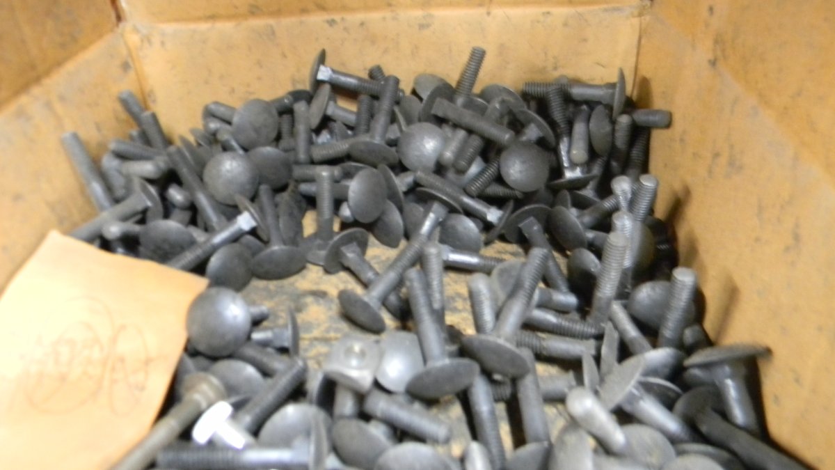

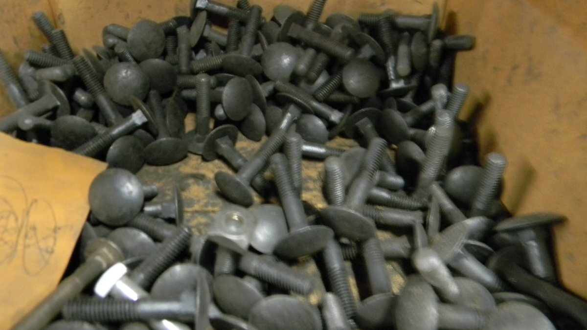

Post by Rich Eagle » Wed May 25, 2022 11:15 am
Here you go.
Someone could buy them and sell them separately.
I tried that with #8-36 throttle arm screws and didn't get many takers but I'm sure this is different. :lol:

Re: 15-16 hood former bolts?
Post by FATMAN » Thu May 26, 2022 10:20 am
This is all I have left out of over 2000 bolts, Bob
