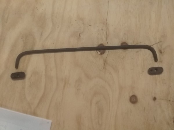

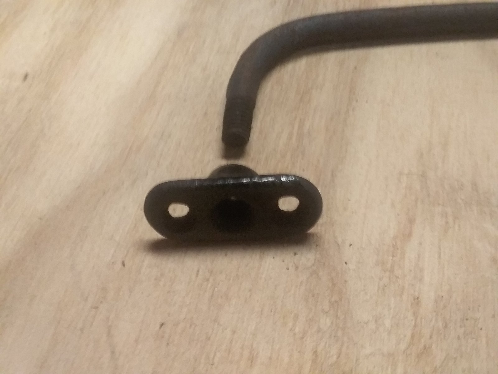

- Posts: 22
- Joined: Sun Jan 06, 2019 12:41 pm
- Last Name: Barclay
- * REQUIRED* Type and Year of Model Ts owned: 1920 coupe
- Location: West Michigan
Re: Info needed please help!!! 1920 Coupe
I'm not as far along on my 20 coupe as you are, so my pulls aren't mounted to the doors. I will attempt to post a picture of them.
The bar is 5/16 rod 14 3/4 mount to mount the little brackets are cast and threaded.
