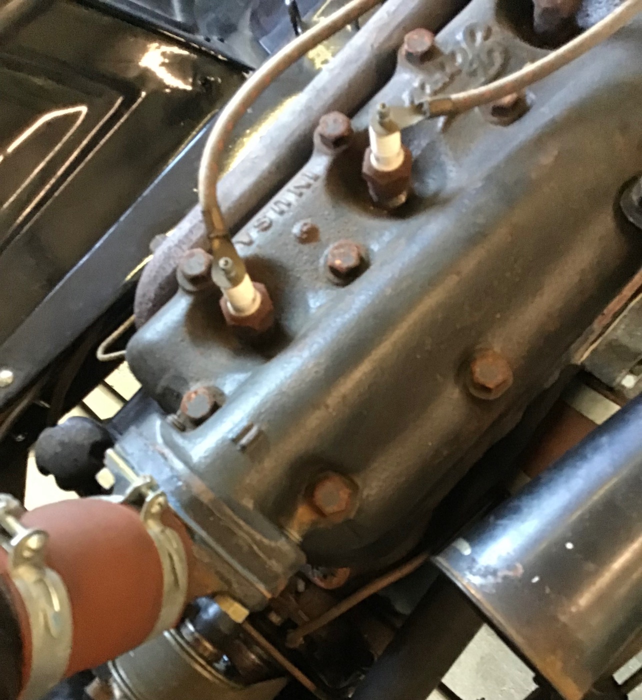

- Posts: 4673
Re: radiator question
I bought a recored low radiator off of EBay and when I got it I noticed the top tank and head outlets were way out of line. I made a spacer to get the correct alignment. Works and aligns fine. Not real noticable either. It’s made from a piece of flat 3/8” plate.

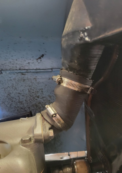

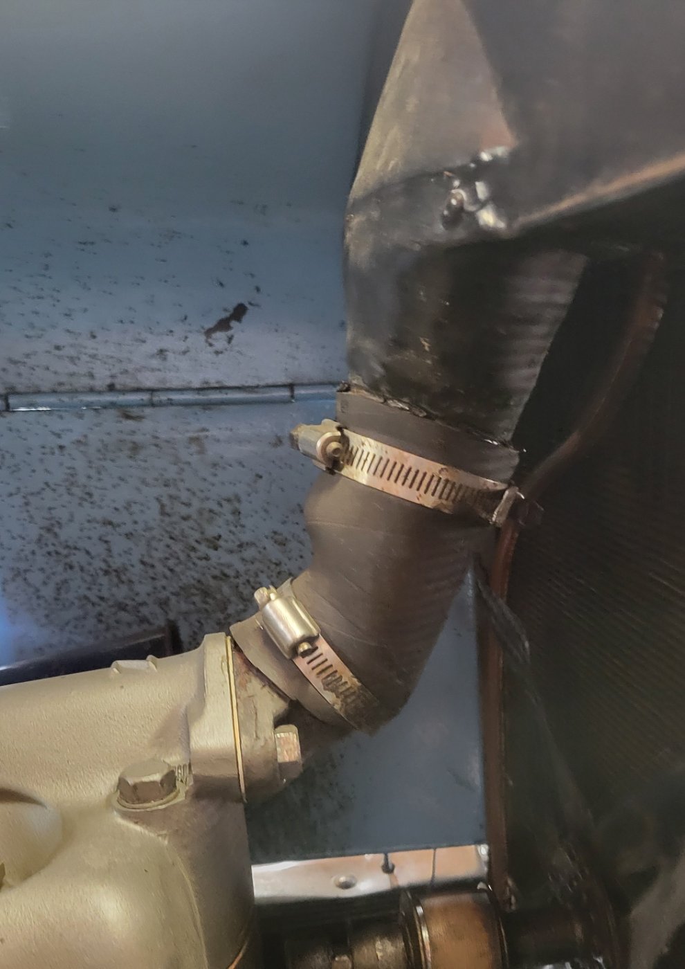

Art,
It sounds like you can cobble together parts to make a radiator work for your car.
Allen,
If I recall correctly (since this was nearly 50 years ago and I was a kid) the brass radiator outlet fit better than the black radiator outlet.
John,
I like your solution to make everything fit. Is your radiator tall or short? Is the hose connection on your radiator cast or sheet metal?
I could probably swap out my water outlet to the black radiator, make a spacer like John did, and trim down the outlet to make a hose fit. Or leave it the way it is.
BWT, to re-core a tall radiator with a short core, the side brackets need to be cut shorter and welded back together, too...
Keith
